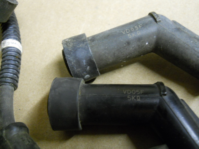

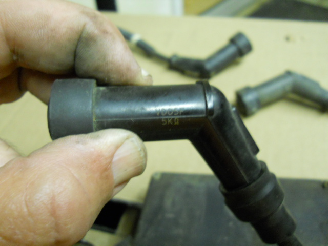

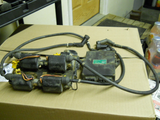

snyper316 Posted June 22, 2018 #10 Posted June 22, 2018 Fork seals, cheap, putting them in yourself from what I hear... Is Priceless. Now as far as Coils and wires I may be able to help you out there. I had bought a set for my bike and have the old set and I know there is at least 2 good coils... the wires From what i know are good along with original caps. I have got a few things going on this weekend so I will try to test the wires out over the weekend. The TCI there is a couple on Ebay but there may be a member here that has one for the 84 I think it is different from the 83.

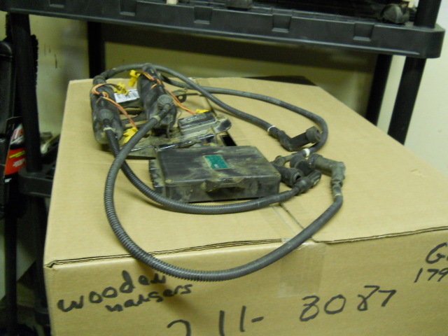

cowpuc Posted June 22, 2018 #14 Posted June 22, 2018 CaptN, do us/you a favor and take a peek at the intake manifold on the #2 jug on your scoot. This would be the front cylinder on the left side of the bike - left side when sitting on the bike. Locate the nipple on the manifold where you would hook the vac line up to if you were syncing the carbs.. The 83's have plugs covering all 4 of those nipples but the 84's have a vac line that goes up to a vacuum control module on that nipple. Does yours for sure have the vac line attached so it is in fact an 84? Also, does anyone know if there is a way of telling the difference between the 84 and 83 TCI by looking at the unit itself?? All of my Ventures except my first one have been 83's and I think I may still have the TCI/coil rack left over from my 84 in a parts tub - was wondering if there is anyway to verify by a visual? Flyinfool , bongobobny , Freebird , Prairiehammer ,,, need some GURU In an attempt to get this thread back to the basics of how it was intended, a lot of posts have been deleted. Some bad and some good. If you posted a "good" one and it was deleted, that is just because it made no sense after some others were deleted. Just explaining. Please don't open another discussion regarding the issue. Let the thread proceed as it was intended to. Any thought on the ? above Don?

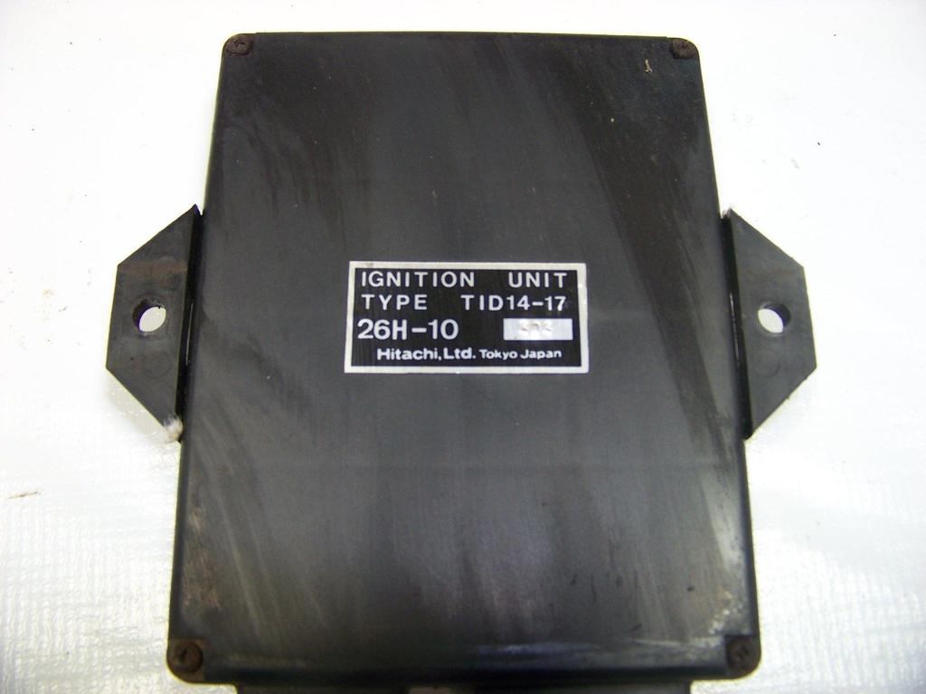

Prairiehammer Posted June 22, 2018 #15 Posted June 22, 2018 Also, does anyone know if there is a way of telling the difference between the 84 and 83 TCI by looking at the unit itself?? All of my Ventures except my first one have been 83's and I think I may still have the TCI/coil rack left over from my 84 in a parts tub - was wondering if there is anyway to verify by a visual? Flyinfool , bongobobny , Freebird , Prairiehammer ,,, need some GURU Indeed there is a difference "visually" between a 1983 TCI and a 1984 TCI. One must be able to read the label applied to the TCI, though. The 1983 TCI Note the black label and "26H-*". The 1984-1989 TCINote the green label and "41R-*".

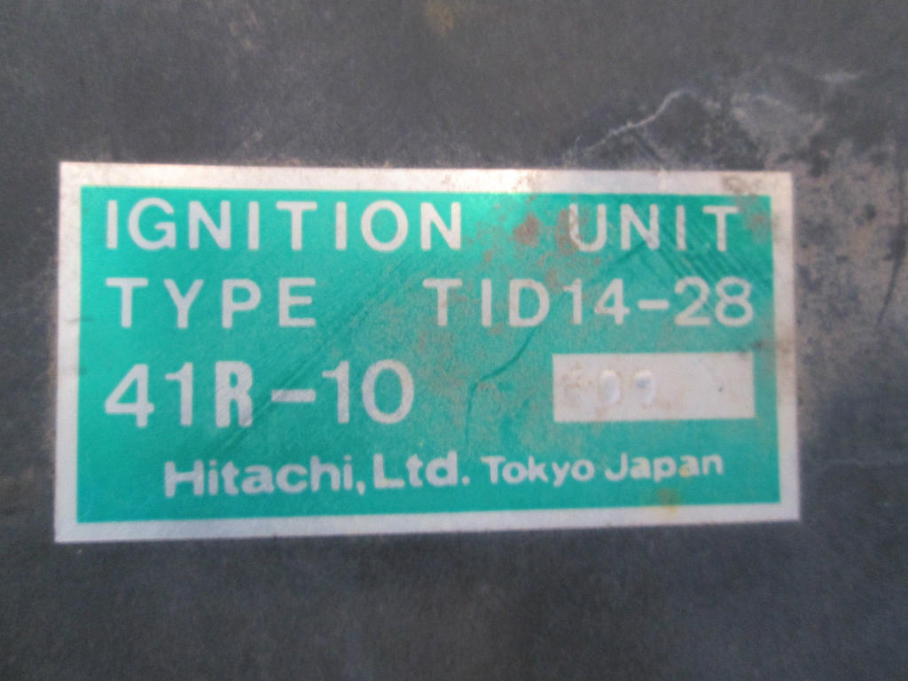

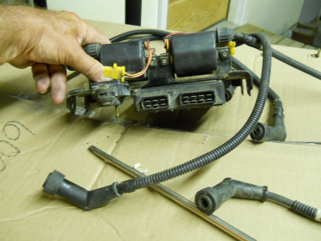

cowpuc Posted June 22, 2018 #17 Posted June 22, 2018 Indeed there is a difference "visually" between a 1983 TCI and a 1984 TCI. One must be able to read the label applied to the TCI, though. The 1983 TCI http://www.venturerider.org/forum/attachment.php?attachmentid=113181Note the black label and "26H-*". The 1984-1989 TCIhttp://www.venturerider.org/forum/attachment.php?attachmentid=113182Note the green label and "41R-*". THANKS KEV!!
s.tyler58 Posted June 22, 2018 #18 Posted June 22, 2018 I have a brand new set of progressives for a 1st gen. in an unopened box! PM me and you can have them at cost. Free ship. I'll find my receipt.Hey you guys, Thank you do much for the welcome and the good words of encouragement. Sure, I was a little butt hurt my self, I took a moment to back up and smile to resist the urge to blast a person in a verbal way that would probably be as misunderstood as my first writing he tried and failed to digest. I am here to stay and plan to be onboard for the long run. Again, I thank each and everyone of you for your kindness and I look forward to meeting many of you in the near future. Nuff said... What I need as far as parts are concerned I've listed below. I'm willing to pay any reasonable price that I can and I appreciate all of you more than the written word can grasp. CTI/CDI box Plug wires Plug caps 5k resistor type 2 coils Probably front seals and springs (they leak worse than government security) I'm looking for some progressive springs if anyone has any laying around. I think Cow-Puc was supporting them in a big way. I have to air them up continuously or I look like a low rider scraping the bottom. I'm not sure about the other electrical parts because I haven't had a multitester since the fire so I'm not really sure of what's what yet. I've pulled the entire body off and am using my time to get it ready for a paint job. So, this is where I'm at and no matter what else happens I'm determined to have her up and on the road 90 days from now, that's my goal and I'm gonna make it happen. This bike is a 1984 xvz1200. Again, thank you all, you ARE a great group, huh..[emoji16] Sent from my SM-G935V using Tapatalk
bongobobny Posted June 22, 2018 #19 Posted June 22, 2018 I see Kevin beat me to the punch on the numbers for the TCI!! Another quick way is to follow the vacuum line from the "boost sensor" which is below the coil pack right next to the TCI. If the vacuum ends up at the carbs it is a 41. If the vacuum ends up on the manifold it is a 26. That is what made the '83 the oddball, it uses manifold vacuum as opposed to carb vacuum for the rest of the years. Because those vacuums are 180 degrees out of phase the '83 advance works backward from the other years. The boost sensor is the same unit... I was going to check for some coils myself and also send you a Harbor Freight multimeter but I see you may have some coming already!

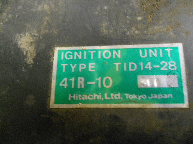

Captaineasy520 Posted June 22, 2018 Author #20 Posted June 22, 2018 I believe my bike is an 84. Fortunatly I sent a picture to a friend of mine months ago in hopes he might have one in his junk pile, I was able to get the TCI box info with one short call. He said the box on my bike read; IGNITION UNIT TYPE TID 14-28 41R-10 Does that help or identify it as a 84. Thanks again for all your help.
bongobobny Posted June 23, 2018 #21 Posted June 23, 2018 Yup!! 41R-10 is definitely an'84! The later units were a -11, the difference being an insignificant change in the response curve for advance. I'm not 100% positive but I believe the -11 was for the 1300cc MK2 '86 - '90...
