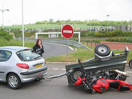

bongobobny Posted June 14, 2018 Share #33 Posted June 14, 2018 https://www.facebook.com/NomadicFanaticUnite/videos/1797139990350563/ Click on the picture to see the video... Link to comment Share on other sites More sharing options...
RDawson Posted June 14, 2018 Share #34 Posted June 14, 2018 https://www.facebook.com/NomadicFanaticUnite/videos/1797139990350563/ Click on the picture to see the video... You can't fix stupid, not even with duct tape. Link to comment Share on other sites More sharing options...
cowpuc Posted June 14, 2018 Share #35 Posted June 14, 2018 https://www.facebook.com/NomadicFanaticUnite/videos/1797139990350563/ Click on the picture to see the video... ,,,, :doh::doh::doh::doh::doh::doh::doh::doh: , maybe the person driving the rig found it easier to load the Uhaul by laying it on its side and just forgot to tip it back up on it's wheels before heading down the road?? Link to comment Share on other sites More sharing options...
Flyinfool Posted June 14, 2018 Share #36 Posted June 14, 2018 Why bother to stop, he knew he was not strong enough to lift it back onto its wheels anyhow. Link to comment Share on other sites More sharing options...
