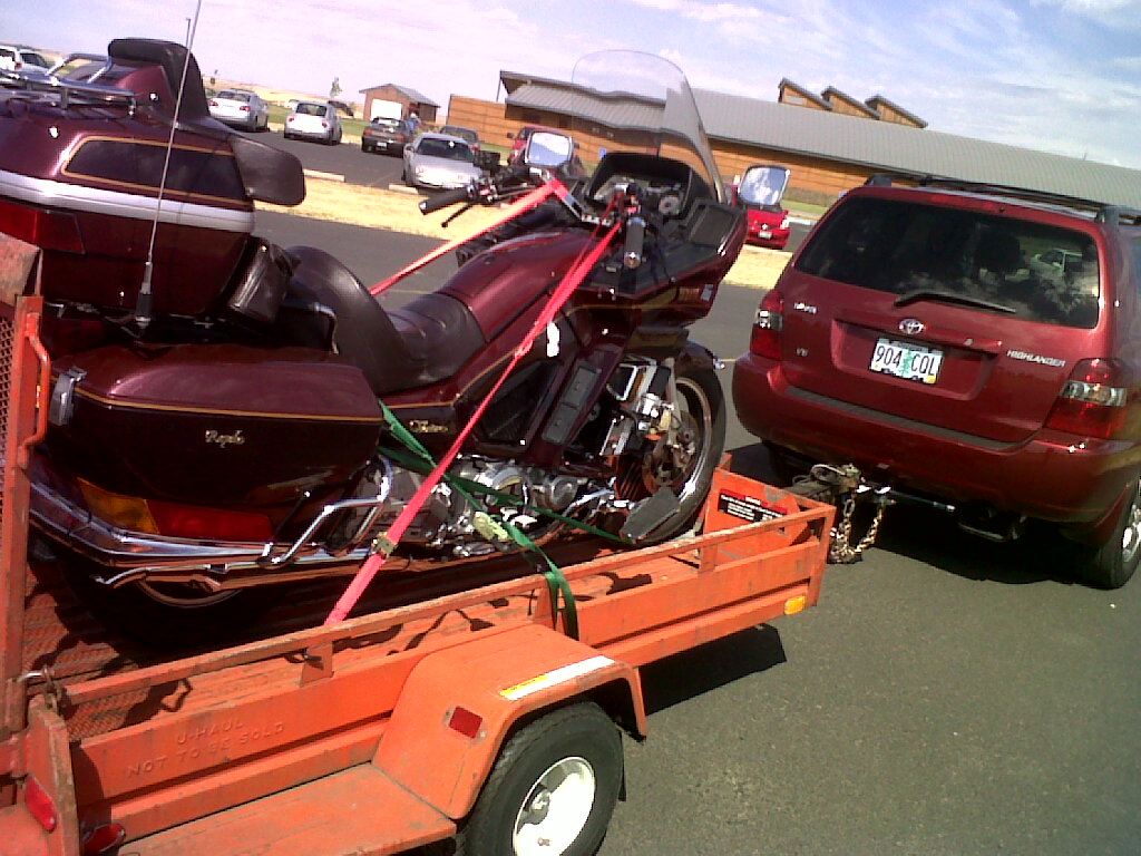

tz89 Posted June 9, 2018 Posted June 9, 2018 (edited) No cover - 300 miles to go. Edited June 9, 2018 by tz89
Condor Posted June 10, 2018 Posted June 10, 2018 No cover - 300 miles to go. I liked the set up of that trailer, then I started thinking...which is very dangerous at times....?? I wonder what the tongue weight is with most of the bike sitting ahead of the axle like that??
tz89 Posted June 10, 2018 Posted June 10, 2018 Well... if everything was perfectly centered, the weight would be split between the axel and the tongue. It looks like the engine is closer to the axel but the photo may be deceiving.
Condor Posted June 10, 2018 Posted June 10, 2018 Well... if everything was perfectly centered, the weight would be split between the axel and the tongue. It looks like the engine is closer to the axel but the photo may be deceiving. Yes it could be, but from what I'm looking at the bulk of the bike plus the trailer are forward of the axle... So, considering the bike weighs around 775# dry plus the trailer weight, according to your formula how much does the tongue weigh??

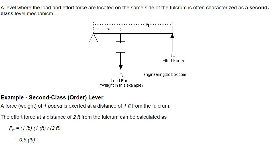

tz89 Posted June 10, 2018 Posted June 10, 2018 If centered between the axel and the tongue, the bike would put 775/2 = 387.5 on both the tongue and the axel. The trailer has to be pretty balanced since I can easily pick up the tongue when it is empty to hook it up. So less than 25?? on the tongue from that. And then take back off the tongue any bike wgt * ft behind the axel (fulcrum). Call it 400 and change? Give me a lever long enough and a fulcrum on which to place it, and I shall move the world. Archimedes Read more at: https://www.brainyquote.com/quotes/archimedes_101761
tz89 Posted June 10, 2018 Posted June 10, 2018 In this picture you can see the bike weight is very close to the axel and not placing most weight on the tongue.
Condor Posted June 10, 2018 Posted June 10, 2018 If centered between the axel and the tongue, the bike would put 775/2 = 387.5 on both the tongue and the axel. The trailer has to be pretty balanced since I can easily pick up the tongue when it is empty to hook it up. So less than 25?? on the tongue from that. And then take back off the tongue any bike wgt * ft behind the axel (fulcrum). Call it 400 and change? Give me a lever long enough and a fulcrum on which to place it, and I shall move the world. Archimedes Read more at: The rule of thumb is aprox 10% of the GTW (trailer plus the bike) should be used as a guide line for proper tongue weight. So let's say the trailer weigh's 600# and the bike is 775# for a total of 1375#. 10% of that would be 137.5, +/-10-15# 400# is way too much towing weight. I don't care what old ARCHY sez.... :-)
tz89 Posted June 10, 2018 Posted June 10, 2018 Yes, now that we can see the bike is very close to the axel (not centered between) that takes a lot of the theoretical weight off the tongue. I suppose Uhaul had this figured out anyway, but still, it is fun to try to remember basic physics.
Condor Posted June 10, 2018 Posted June 10, 2018 Yes, now that we can see the bike is very close to the axel (not centered between) that takes a lot of the theoretical weight off the tongue. I suppose Uhaul had this figured out anyway, but still, it is fun to try to remember basic physics. I guess we'll never know unless we get a straight side pic of the bike on the trailer... To me the bike still looks farther forward. And I kinda wonder if the trailer was designed that way or it had been re-purposed??

WRIDR Posted June 12, 2018 Posted June 12, 2018 Oh ohhh... that foto supposedly showing the bulk weight is "near the axle" IS misleading, even to these 75 yr old eyes. For our money, most of the engine and bulkier weight stuff is STILL well ahead of that axle. We're betting that tongue is supporting a LOT more weight than it should. Be VERY careful assuming otherwise. A load imbalance like that could produce significant issues at speed on the highways, INCLUDING the potential for a side-to-side weave action. (Anybody who missed that should go back and take another look at the foto.) If you've never experienced one, you have no idea how frightening - and disastrous it can get. The only recommended way to come out of it safely is to hang on to the wheel tight, and... speed up. That takes a lot of intestinal fortitude, along with a large dose of good luck. Rgds, WRIDR
