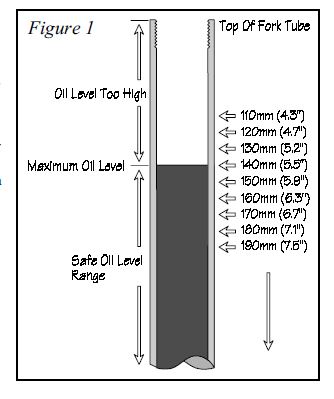

Bob K. Posted September 29, 2018 Posted September 29, 2018 I had originally gone with 5.5" but this time I decided to leave it at 5". I decided on a 6" fork oil level this time around. I also made sure I pumped the forks up and down to distribute oil and then checked the level again. I was shocked by how far the oil level went down upon initial fill once the oil was distributed. I have limited experience with forks, so I can only go off of what Progressive's instructions said. Anything less than a 5.5" air gap (aka "fork oil level") at the top of the fork is too much oil. Do I have that right?Progressive Spring Instructions.pdf
CaseyJ955 Posted September 30, 2018 Author Posted September 30, 2018 I decided on a 6" fork oil level this time around. I also made sure I pumped the forks up and down to distribute oil and then checked the level again. I was shocked by how far the oil level went down upon initial fill once the oil was distributed. I have limited experience with forks, so I can only go off of what Progressive's instructions said. Anything less than a 5.5" air gap (aka "fork oil level") at the top of the fork is too much oil. Do I have that right? That is my understanding, and I mistyped, Progressive said 5.5, I filled it up to 6", not 5" as I said.
camos Posted October 4, 2018 Posted October 4, 2018 That is my understanding, and I mistyped, Progressive said 5.5, I filled it up to 6", not 5" as I said.So if you put in less oil than Progressive recommended, how would that affect the seal?
Bob K. Posted October 8, 2018 Posted October 8, 2018 (edited) So if you put in less oil than Progressive recommended, how would that affect the seal? The Progressive instructions indicate not to put in more oil than that which gives a 5.5" air gap at the top. That's with the springs out and the forks completely compressed. The instructions indicate any oil level less than that is "safe". I'm just theorizing here. Putting in more oil than Progressive says is "safe" might result in not having enough air gap once the springs are installed and take up a bunch of volume, so one might get some hydrolock (and resultant overpressure on the seals) if one hits a hard bump. On the other end of the spectrum, I think we only need enough oil in the forks to make sure all the valving has enough oil to use. The only downside I can see is that a large air gap leaves more room for the air to compress, thus resulting in lower air pressure and softer suspension on hard bumps. I dunno. Maybe somebody who understands how all those dang fork parts work can explain it better. Edited October 8, 2018 by Bob K.

camos Posted October 8, 2018 Posted October 8, 2018 A little confusion over filling to 5" or 6". Filling to 6" should be safe. Filling to 5" is overfull which I think might cause the seals to blow out.
CaseyJ955 Posted October 8, 2018 Author Posted October 8, 2018 The Progressive instructions indicate not to put in more oil than that which gives a 5.5" air gap at the top. That's with the springs out and the forks completely compressed. The instructions indicate any oil level less than that is "safe". https://www.venturerider.org/forum/attachment.php?attachmentid=114623 I'm just theorizing here. Putting in more oil than Progressive says is "safe" might result in not having enough air gap once the springs are installed and take up a bunch of volume, so one might get some hydrolock (and resultant overpressure on the seals) if one hits a hard bump. On the other end of the spectrum, I think we only need enough oil in the forks to make sure all the valving has enough oil to use. The only downside I can see is that a large air gap leaves more room for the air to compress, thus resulting in lower air pressure and softer suspension on hard bumps. I dunno. Maybe somebody who understands how all those dang fork parts work can explain it better. I never wanted to go over after reading the 5.5" max on the Progressive inlay. I figure anymore than that and the oil will have no place to go in a bottom-out situation and force the oil past the seal causing yet another joyous occasion to pull the forks apart. I'm around 6" down now and it hung in there just fine while I was wandering greener pastures. I even hit a few unexpectedly large irregularities in CO and NE that had to be close to bottoming out, yet the seal hangs in just fine. I'll still keep the fork parts on hand for when it does pop again. I'm quite pleased with being able to do this whole Colorado thing without one mechanical failure, for the first few hundred miles I was constantly glancing at it to make sure it was sealing. I did right away notice the forks were softer, not sure if it was different fluid or just a little more air and a little less oil. It does ride pretty darn nice.
CaseyJ955 Posted October 8, 2018 Author Posted October 8, 2018 A little confusion over filling to 5" or 6". Filling to 6" should be safe. Filling to 5" is overfull which I think might cause the seals to blow out. Agreed, maybe I was cutting it to close with the 5.5", which is why I dropped 0.5" while filling this time. The progressives are beefier than the OEM springs and will displace more fluid when dropped back into the fork, but the 5.5" rule is what I heard with those springs. I guess next time I have them apart I'll consider 6" the magic number.
