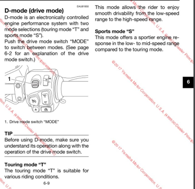

American Posted May 20, 2018 #5 Posted May 20, 2018 The drive modes are just change the throttle response, my Harley had the ability to do that, I had a Vance & Hines FP3 tuner on the bike and you could adjust the throttle response but Vance & Hines had a warning to be careful as if you selected for example 1 to 1 throttle response, that is the throttle body reacted on a scale of one to one with your right grip as you turned it could make the bike to responsive until and if you could get used to it. I think the FP3 gave you five choices to pick from starting with stock and then each one made throttle response quicker until you got to the 1 to 1 ratio. I bet Yamaha's system is doing the same thing except instead of having to program it you just push a button. I find the Touring mode suits me just fine.
American Posted May 20, 2018 #6 Posted May 20, 2018 cowpuc said: So what do you think Duey? Are we talking nothing more than than a wireless 1/4 turn throttle as such and what the new owners of the 113 are feeling in performance gains equate to nothing other than a twitchyness that can come as of the result of such? I am eagerly waiting now to redo a test ride on the one and cant wait to see if this is wrong.. I am hoping to see a huge change in rev limits and power delivery increases - we'll figure it out,,, one way or the other... To answer your question it is yes and no, yes in that you get a quicker throttle response and no in that a quarter turn adaptor used on a throttle cable can not come close to matching what they have done with the electronic switch. In other words this in not your old quarter turn adaptor you have used on old cable operated throttles.
cowpuc Posted May 20, 2018 Author #7 Posted May 20, 2018 American said: To answer your question it is yes and no, yes in that you get a quicker throttle response and no in that a quarter turn adaptor used on a throttle cable can not come close to matching what they have done with the electronic switch. In other words this in not your old quarter turn adaptor you have used on old cable operated throttles. I am still not quite sure how just because your adjusting the throttle sensitivity electronically instead of the old fashioned way like we used to do it with a quarter turn throttle can equate to this type of difference though (just seems like there would have to be wayyy more to Sport Mode than what I am hearing/reading here): YamahaParExcellence said: Folks...there are days...and there ARE days... --------------------------------------------------------------- After coming back from my Yamaha Star Venture Trans Continental 'Sport Touring' very early morning ride in the Hills of the Hockley Valley, Ontario, Canada...and while cutting my front lawn this afternoon...., I started breaking out in a totally obvious laughing uproar....whereby my neighbors must have thought I had FINALLY lost it..."quick Henry, I'm watching our neighbor through the curtains...and he has LOST IT, totally! Come and look at this...call 911!" There I was folks, pushing the dang lawnmower...and laughing at all get out....and I myself was the BRUNT of the fit of laughter!!!! There must have been some Head Office Yamaha Canada and USA Engineering Supervisors and their reporting colleagues that were chinking bottles of cold beer,...passing around my forum post of when a 964 pound motorcycle outshines the owner's dedicated Sport Bike in throwing the SVTC into left and right leaning S-Backs...and not only coming back to tell the sordid tale...but in fact, was eye popping, veins bulging, raving about the experience! They must have been having the times of their lives....and I can just hear one or more of them saying something to this effect; "Hey DUMMY...why do you THINK we called the 'other' mode; SPORT MODE? Huh?" I just had the best laugh on myself....for they engineered the SVTC to handle even the most full-on SPORT mode riding, should the bike be called upon to do that by the Touring single or couple. Mountain S-Backs, country lanes, yep...they engineered that riding capability into the very core of the frame and steering geometry. You know...like some of them are muttering after taking a sip of beer..." Like no ****, Sherlock!" LOLOL! I now have the SVTC Sports Rider T-shirt...and will now run Charlotte as for what I bought her for...serious non goofing around, Grand Touring for two. CowFace (my ZR7S) has gotten a reprieve, for all the great Sport riding, he has already offered me...BUT...if I EVER hear him start to brag to Charlotte, while both resting in the garage....that he can do THIS...and he can do THAT...I'm going to pause...wait...and listen for her to totally open up on him...and say "yeah?....well Joe and I tore it right up, CowButt...in the Hockley Valley, on May 16th, 2018 at 6:00 am...and oh..uh...WHERE WERE YOU IN ALL OF THAT?!?" There is nothing like the disdain of a woman! He had better listen! Cheers n' beers, Joe or from the comments I have read about the new Venture doing wheelies in Sport Mode.... I think I may still be a little confused about what exactly Sport Mode really does/is...
Du-Rron Posted May 20, 2018 #8 Posted May 20, 2018 cowpuc said: So what do you think Duey? Are we talking nothing more than than a wireless 1/4 turn throttle as such and what the new owners of the 113 are feeling in performance gains equate to nothing other than a twitchyness that can come as of the result of such? I am eagerly waiting now to redo a test ride on the one and cant wait to see if this is wrong.. I am hoping to see a huge change in rev limits and power delivery increases - we'll figure it out,,, one way or the other... Wow what a fun morning. Can you tell that it is raining here??? Dirt tamer.. throttle tamer... Electric Throttle Control... I think that "Tour Mode" would be what I would call "Standard Throttle". I think that "Sport Mode" changes the throttle plates to more closely follow the hysteresis of the throttle position sensor to the throttle angle in the right grip thereby eliminating a "dampning" effect in the throttle plates. If the 3rd Gen Venture were to have the electric throttle off the FZ-09 you would not be able to ride the Venture due to abrupt engine acceleration caused by throttle plate movement. On a high torque engine, the throttle must be "damped" or every little bump in the road would cause tiny throttle movement and a herky jerky ride. I believe "Sport Mode" removes some damping through at least 3/4 throttle. Rev Limits and Maximum Horsepower and Torque are unchanged. I can't wait till you get another chance to ride one as well. Still got the Superman Suit?
ChiefGunner Posted May 20, 2018 #9 Posted May 20, 2018 cowpuc said: I am still not quite sure how just because your adjusting the throttle sensitivity electronically instead of the old fashioned way like we used to do it with a quarter turn throttle can equate to this type of difference though (just seems like there would have to be wayyy more to Sport Mode than what I am hearing/reading here): or from the comments I have read about the new Venture doing wheelies in Sport Mode.... I think I may still be a little confused about what exactly Sport Mode really does/is... Its very simple Puc. This is an EFI not normally aspirated. It’s no different than when I had an SCT module for my high performance Mustang. All the unit did was re-map fuel, spark advance, etc... The performance difference between the two was significant on the car. I imagine they’re doing pretty much the same thing here. I can’t wait until someone makes a performance module where you can personally tweak those parameters even more!
ChiefGunner Posted May 20, 2018 #10 Posted May 20, 2018 cowpuc said: So what do you think Duey? Are we talking nothing more than than a wireless 1/4 turn throttle as such and what the new owners of the 113 are feeling in performance gains equate to nothing other than a twitchyness that can come as of the result of such? I am eagerly waiting now to redo a test ride on the one and cant wait to see if this is wrong.. I am hoping to see a huge change in rev limits and power delivery increases - we'll figure it out,,, one way or the other... How many times does someone have to say it? There is NO change in rev limits!! You keep trying to ascribe something that does not exist. There IS a clear seat of the pants feel difference between the two. The acceleration is Sport Mode is much more brisk! Remember, that means you’ll have to “short shift” faster to not go so far out of the torque band as you did every time you shifted it in your video.
American Posted May 20, 2018 #11 Posted May 20, 2018 ChiefGunner said: How many times does someone have to say it? There is NO change in rev limits!! You keep trying to ascribe something that does not exist. There IS a clear seat of the pants feel difference between the two. The acceleration is Sport Mode is much more brisk! Remember, that means you’ll have to “short shift” faster to not go so far out of the torque band as you did every time you shifted it in your video. Riding is a skill, but to many think that the skill is revving the engine to 7,000 or more RPM depending on the rev limit of the engine, it takes even more skill to learn how to ride a low revving engine to wring the performance out of it. Anyone can wind out the engine, there is really not much skill in that, but to know were the power band is within the rev range is the real skill part. But like I said to many think the skill part is having high revving engines and maxing out the RPM's in each gear, those people have gone over the power band in most cases and are not the most proficient riders, oh they make a lot of noise and such because they have hit maximum engine revs and sound like a bumble bee they think they are ready to enter the next MotoGP race. Some think if they can't turn 7,000 or more RPM's then they can't be happy.
ChiefGunner Posted May 20, 2018 #12 Posted May 20, 2018 American said: Riding is a skill, but to many think that the skill is revving the engine to 7,000 or more RPM depending on the rev limit of the engine, it takes even more skill to learn how to ride a low revving engine to wring the performance out of it. Anyone can wind out the engine, there is really not much skill in that, but to know were the power band is within the rev range is the real skill part. But like I said to many think the skill part is having high revving engines and maxing out the RPM's in each gear, those people have gone over the power band in most cases and are not the most proficient riders, oh they make a lot of noise and such because they have hit maximum engine revs and sound like a bumble bee they think they are ready to enter the next MotoGP race. Some think if they can't turn 7,000 or more RPM's then they can't be happy. Well said and VERY true. Old riding habits die hard.
cowpuc Posted May 20, 2018 Author #13 Posted May 20, 2018 ChiefGunner said: Its very simple Puc. This is an EFI not normally aspirated. It’s no different than when I had an SCT module for my high performance Mustang. All the unit did was re-map fuel, spark advance, etc... The performance difference between the two was significant on the car. I imagine they’re doing pretty much the same thing here. I can’t wait until someone makes a performance module where you can personally tweak those parameters even more! This is probably another old school gear head thing and probably incorrect too but in the circles I have built bikes in,, the term "not normally aspirated" would indicate that the engine is boosted somehow,,, either thru supercharging or with a turbo. Chief,, are you indicating here that the new Venture incorporates either of those?? I looked them over fairly close at Americade and at Sturgis last year never found any indicator of such.. I also never felt anything when riding them that indicated such BUT,,, I do concede that I did not seek the Sport Mode as you guys are referring to and it is entirely possible that the "boost" could be tied to such,,, NEVER UNDER ESTIMATE MOM YAM IMHO.. I did get to actually see the throttle body assembly for the new bike and seriously,, it is considerably less in stature than the dual set up used on the Strat, Roadliner or Raider mounts BUT - if I missed something and these new Ventures are indeed not normally aspirated/are boosted then the reduced accumulated size of the throttle body(s) is completely irrelevant IMHO..
cowpuc Posted May 20, 2018 Author #14 Posted May 20, 2018 Du-Rron said: Wow what a fun morning. Can you tell that it is raining here??? Dirt tamer.. throttle tamer... Electric Throttle Control... I think that "Tour Mode" would be what I would call "Standard Throttle". I think that "Sport Mode" changes the throttle plates to more closely follow the hysteresis of the throttle position sensor to the throttle angle in the right grip thereby eliminating a "dampning" effect in the throttle plates. If the 3rd Gen Venture were to have the electric throttle off the FZ-09 you would not be able to ride the Venture due to abrupt engine acceleration caused by throttle plate movement. On a high torque engine, the throttle must be "damped" or every little bump in the road would cause tiny throttle movement and a herky jerky ride. I believe "Sport Mode" removes some damping through at least 3/4 throttle. Rev Limits and Maximum Horsepower and Torque are unchanged. I can't wait till you get another chance to ride one as well. Still got the Superman Suit? Nahh,, I sent the Superman Suite back to its rightful owner,, the REAL Superman = Dragonslayer .. I REALLY had fun with it though Duey - what an ABSOLUTE BLAST!!!!!!!! THANKS AGAIN MAN OF STEEL = DRAGONSLAYER!!!!!
cowpuc Posted May 20, 2018 Author #15 Posted May 20, 2018 American said: Riding is a skill, but to many think that the skill is revving the engine to 7,000 or more RPM depending on the rev limit of the engine, it takes even more skill to learn how to ride a low revving engine to wring the performance out of it. Anyone can wind out the engine, there is really not much skill in that, but to know were the power band is within the rev range is the real skill part. But like I said to many think the skill part is having high revving engines and maxing out the RPM's in each gear, those people have gone over the power band in most cases and are not the most proficient riders, oh they make a lot of noise and such because they have hit maximum engine revs and sound like a bumble bee they think they are ready to enter the next MotoGP race. Some think if they can't turn 7,000 or more RPM's then they can't be happy. ChiefGunner said: Well said and VERY true. Old riding habits die hard. Well said guys,, well said!! Some of us are still working on developing some of those skills though,,,, just dont give up on us!!
