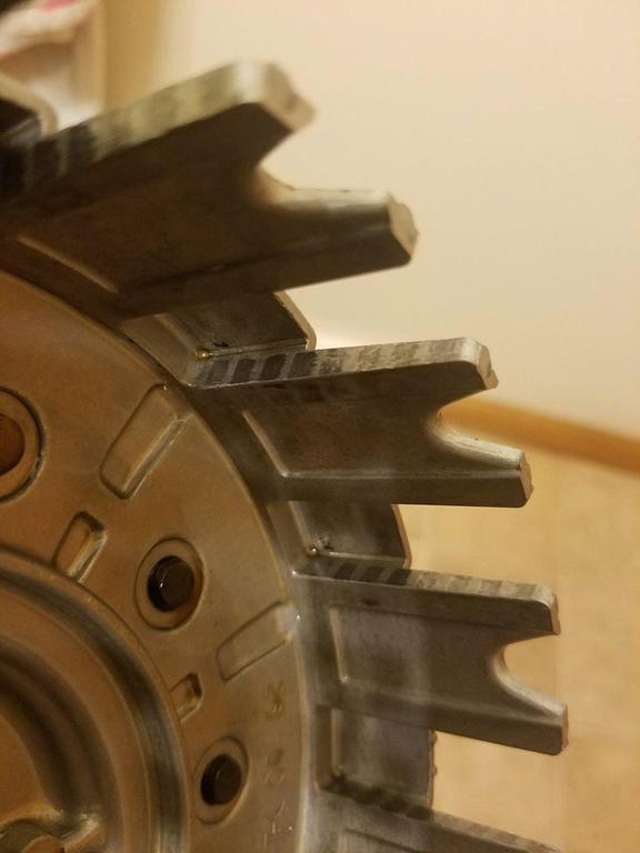

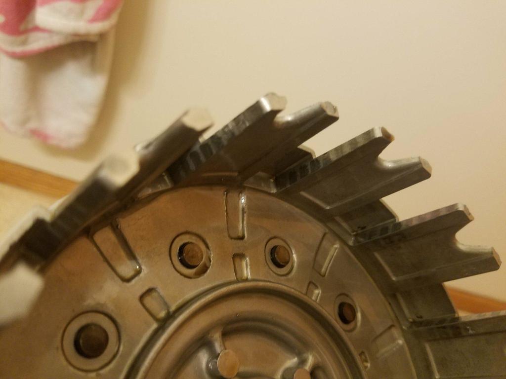

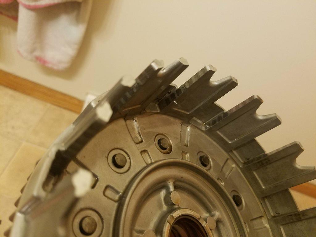

Chaharly Posted May 5, 2018 Author Share #24 Posted May 5, 2018 http://www.venturerider.org/forum/attachment.php?attachmentid=112443http://www.venturerider.org/forum/attachment.php?attachmentid=112444http://www.venturerider.org/forum/attachment.php?attachmentid=112445 There's a few pictures of the old basket! Looks like it coulda made for a possible chattery clutch? I ran my nail up and down a few of the surfaces and I there were a few spots that are going to need attention. I decided to go ahead with putting the new basket in instead. The new one had a little notched part on one of those fingers so I sanded it out as well. I got it all installed and its mayyybbbeee(?) a little better. Still sort of tries to roll in gear, maybe not as bad. I'm gonna keep trying to work air out of the clutch hydraulics. The only other thing I can think is that the Skydoc clutch upgrade kit eliminates a shim, a retainer wire, and "half friction disc" at the back of the clutch basket and in place substitutes another those three things with a full friction disc. I guess its to reduce the friction zone of the clutch? Would that possibly eliminate some of the precious clearance in my clutch? I've been tempted to buy a new half friction disc, retainer wire and digging the old shim (spacer) out of the trash and trying that The inside edges were pretty sharp as well, but the new basket they were satin smoothe Link to comment Share on other sites More sharing options...
7 lakes Posted May 5, 2018 Share #25 Posted May 5, 2018 Well it most likely wasn't the basket, that doesnt look too bad. I dont have any experience with skydocs kit, I've never found the need for altering stock setups in a street application, but I'm not a Venture expert in particular. Skydocs kit has great reviews and isnt likely to be your issue, but strictly from a diagnostic perspective , if I were working on a customer's bike "blind" and all I knew was that the stock setup had been altered, the first thing I would do is return to a stock configuration and diagnose from there. But again, with everything I've read here about the kit it doesnt seem likely that that's your problem. If may be air in the hydraulics, it may be time to rebuild the clutch master, worn internals can result in a portion of the stroke being used to pressurize the system instead of applying movement. Worn cups don't seal well until flared against the cylinder wall, and you could easily be using the first little portion of your application stroke to establish pressure, instead of applying it. I've had this show up after replacing a hydraulic component and bleeding the system, sometimes the really really fine rubber powder (That black stuff at the bottom of the master cylinder) provides sealing assistance and when you flush it all out you lose some seal. You won't even know it's happening but you can lose enough action to make a difference. Try observing the movement of the clutch when operating the lever, once the little bit of slack is taken up any movement of the lever should result in immediate movement of the clutch; take up the mechanical slack between the lever and the master piston then while feeling the clutch with one hand move the lever gently with the other. You should be able to ascertain where the strictly mechanical slack between the lever and piston is, and beyond that there shouldn't be any hydraulic slack, and movement of the lever should immediately result in movement at the other end. Kind of a hard thing to describe, but you should be able to tell when the system actuates relative to where it should. Man, I wish I had my hands on this thing. Tim Link to comment Share on other sites More sharing options...
