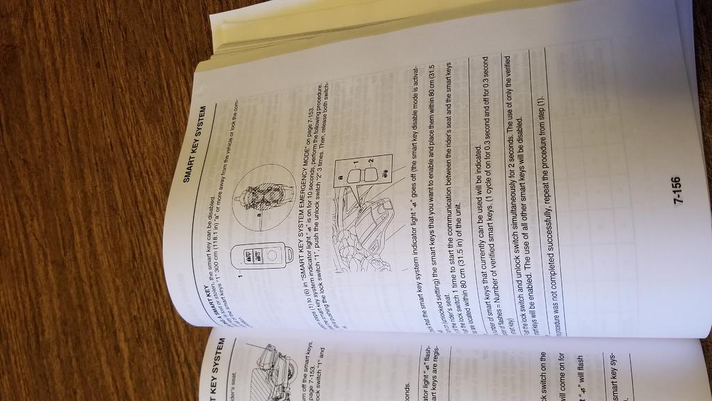

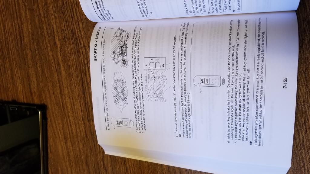

Russbug1 Posted April 2, 2018 Posted April 2, 2018 Here's the procedure from the service manual http://www.venturerider.org/forum/attachment.php?attachmentid=111990http://www.venturerider.org/forum/attachment.php?attachmentid=111991 steps 6 & 7 were missing from the copy of the manual I obtained from the dealership... interesting. thanks, Rich

crossbowme Posted June 1, 2019 Posted June 1, 2019 steps 6 & 7 were missing from the copy of the manual I obtained from the dealership... interesting. thanks, Rich Mine too!
ZephyrChuck Posted July 7, 2019 Posted July 7, 2019 Not sure what steps (Steps 6&7) I see many people are saying they didn't have in their manuals. I realize many of these comments are old, yet I am sure there are some new Venture Riders out there that may want to get an additional fob, I just did. I paid $179.17 for mine. The procedure in the manual is convoluted, but it worked. I just had to get the steps correct in my head. Once I did, I finally got it programmed. If any one needs the procedure, let me know,
