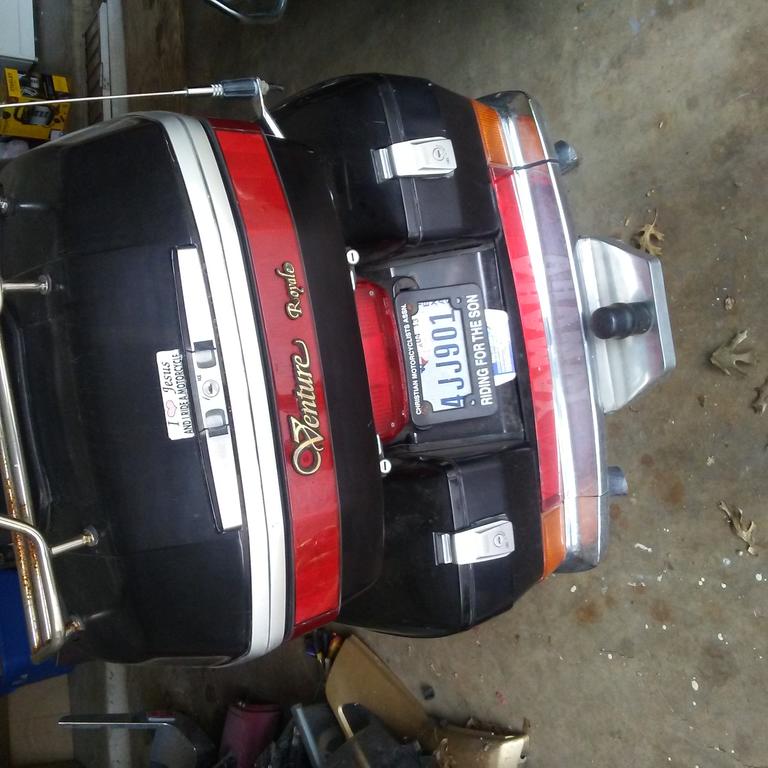

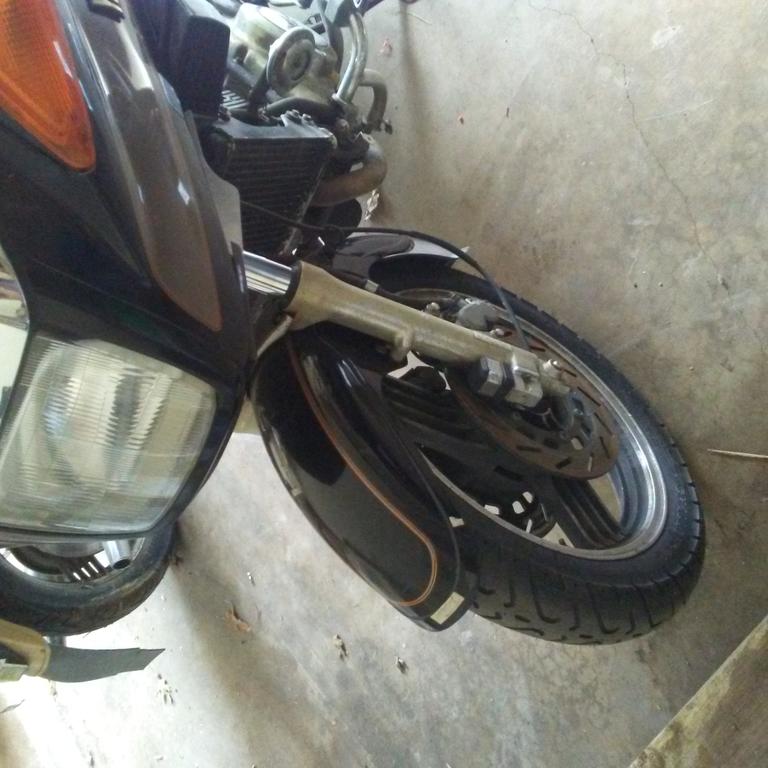

cruiserlover Posted March 27, 2018 Author Posted March 27, 2018 pictures.dont know why they are crooked.$200.00 for the bike
