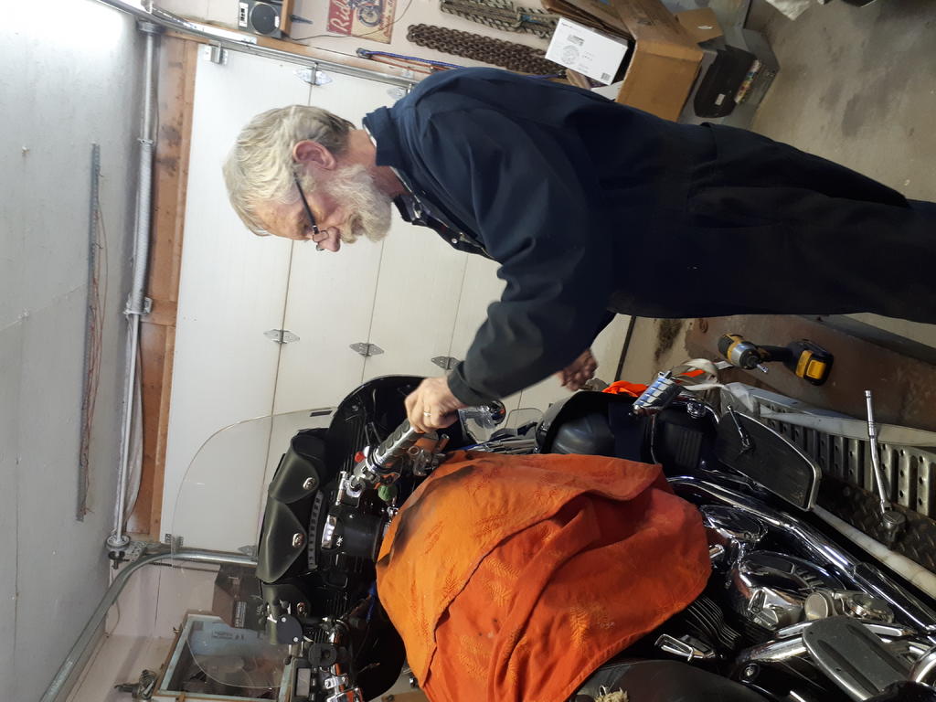

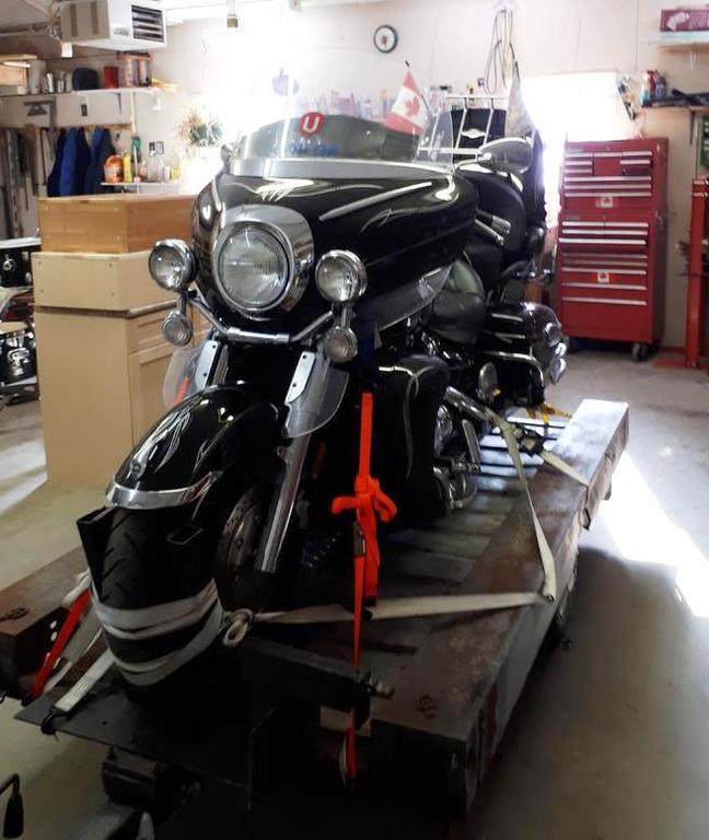

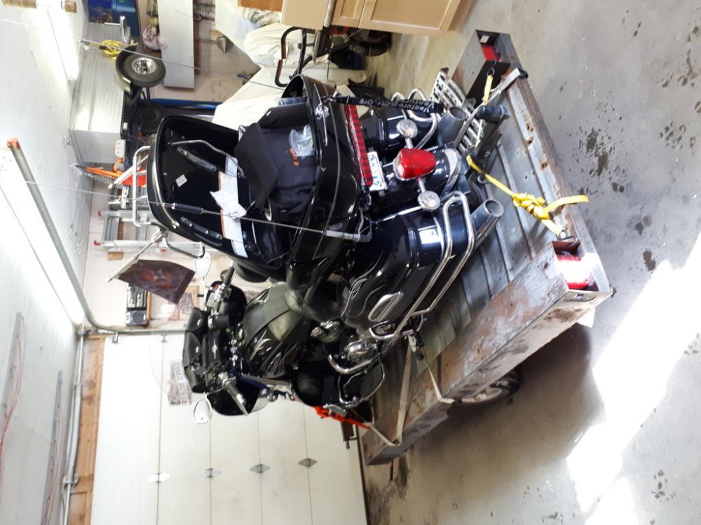

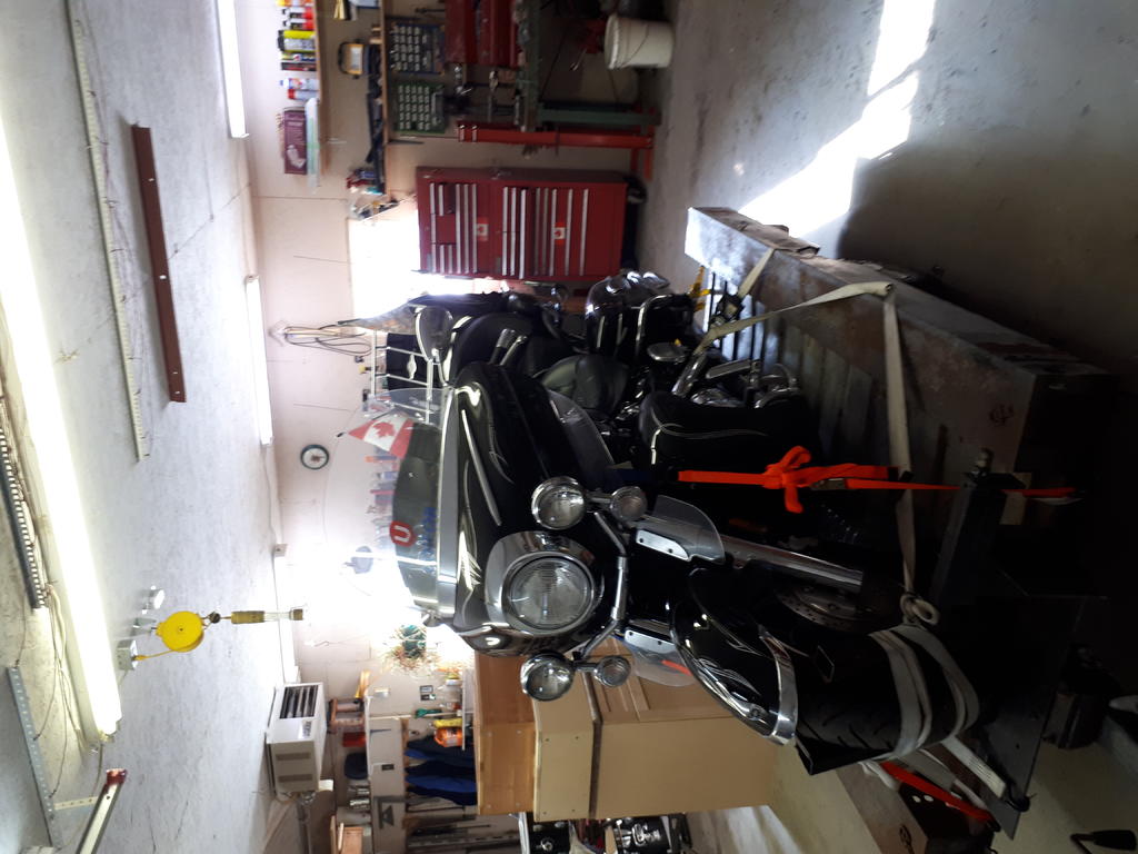

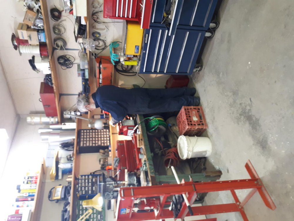

20180303_135600.jpg20180303_135552.jpg20180303_135537.jpg20180303_111846.jpg20180303_111840.jpg20180303_092943.jpg20180303_092930.jpgCan't seem to find anything to rotate the pictures but THANKS Carl for your help in turning down my bar weights down to fit inside my new Kurriakin hand grips!!!!!!!!!!
Thanks Sleepy, it was a good day and it all seemed to work out. Got lucky again! And you're welcome anytime.
Glad you took at least 3 good pictures. :whistling:
Wish I could have been there to see exactly how Carl did it! I was going to bore out the caps on the grips and find the right sized nut but opted for just buying the Kuryakin weights...
Thanks Kretz for turning them around.

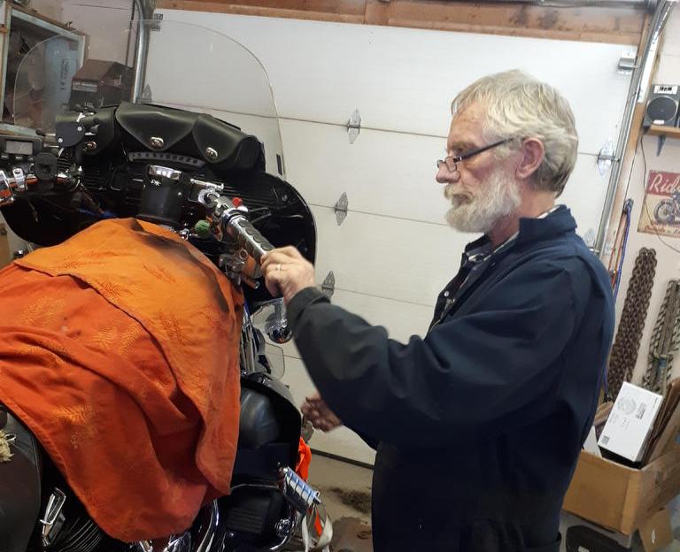

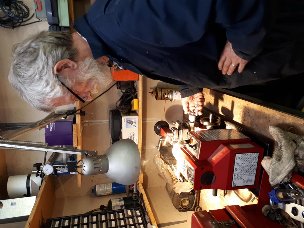

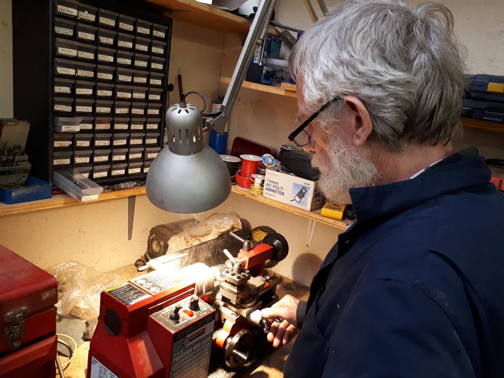

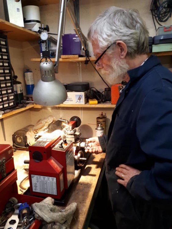

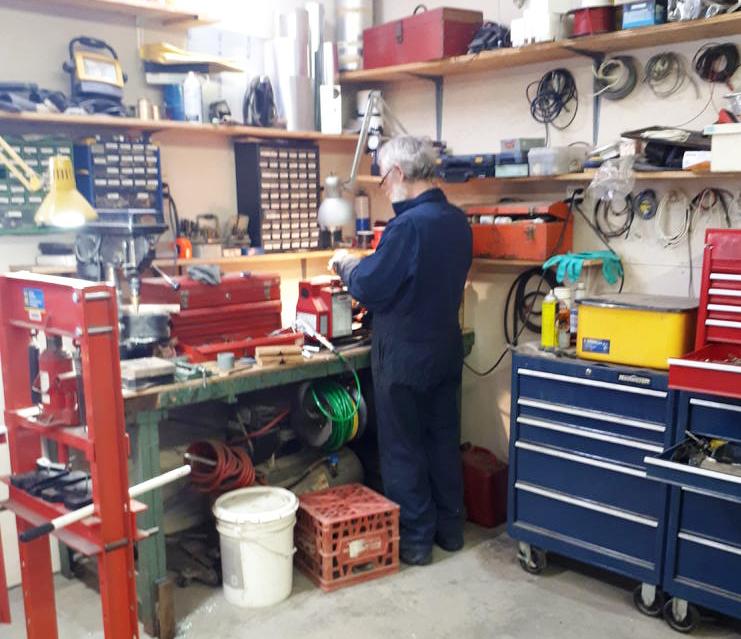

Carl used step drill to cut the end hole(of the grips) out to the thread size of the weights then turned down roughly 1/2 in. or so of the chromed shoulder so it could slide in and bolt up to handle bars. They look and feel great. Thanks again!!

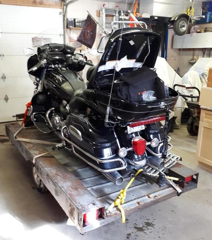

Yeh the two of the motorcycle and the one were Marcarl has his back turned to the camera :rotfl:
P.S. One thing about Carl he is always there when help is needed.
My first thought about your comment was: YOU!!! go sit in the lake, but actually you're almost right spot on.The 2 of the bike and the one of SleepyII.
