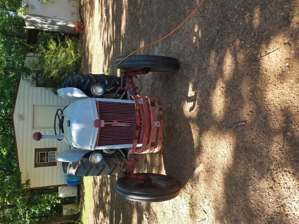

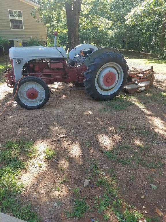

Woody Posted March 9, 2018 #19 Posted March 9, 2018 how good at wrenching are you? my son has a 1939 ford 9n that needs some work and I believe it has about a four foot bush hog with it. could be had for $600. He inherited it from his granddad and I got it running but that's as far I'm going with it.
Dragonslayer Posted March 9, 2018 Author #20 Posted March 9, 2018 how good at wrenching are you? my son has a 1939 ford 9n that needs some work and I believe it has about a four foot bush hog with it. could be had for $600. He inherited it from his granddad and I got it running but that's as far I'm going with it. Dang that is right up my alley. I can wrench pretty Darn good when I want to or put my mind to it. Where can I come and get it. send on pics and details.

Sylvester Posted March 10, 2018 #23 Posted March 10, 2018 There is no difference between the 9N, 2N, and early 8N. There was a two speed after market transmission in front of the main which really added to the PTO for running conveyors at 1000 rpm (which my old 2N has) but I only use it as a road gear. You can easily convert it to a 12V system. Love the old fords.
Woody Posted March 10, 2018 #24 Posted March 10, 2018 There is no difference between the 9N, 2N, and early 8N. There was a two speed after market transmission in front of the main which really added to the PTO for running conveyors at 1000 rpm (which my old 2N has) but I only use it as a road gear. You can easily convert it to a 12V system. Love the old fords. This one has been converted to 12V and I had rather see someone get and fix it than it sit in the yard and rot
Woody Posted March 10, 2018 #25 Posted March 10, 2018 Dang that is right up my alley. I can wrench pretty Darn good when I want to or put my mind to it. Where can I come and get it. send on pics and details.
