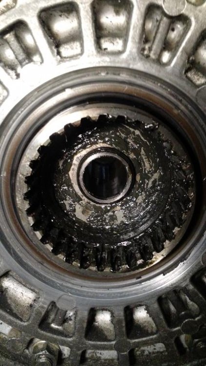

OrlinEngh Posted December 17, 2017 Author Posted December 17, 2017 Here is a pic, you can see that the rubber dust seal is gone.

MiCarl Posted December 17, 2017 Posted December 17, 2017 (edited) The bearing and seal are still available. It seems unlikely the housing is shot. Disassemble the final drive and see what you've got. The reason the housing isn't available separately is because changing the casting requires re-shimming it. Not something they trust the service department with. #16 Bearing 93316-01403-00 #22 Oil Seal 93102-70167-00 Edited December 17, 2017 by MiCarl
OrlinEngh Posted December 17, 2017 Author Posted December 17, 2017 Thanks I got it stuck in my head that the Housing Bearing was saying they were together. I will take it apart tomorrow and see what I have,
MiCarl Posted December 17, 2017 Posted December 17, 2017 The bearing you're looking at is pressed onto the gear and I believe is a friction fit to the housing. If it doesn't pull right out heat it up. The aluminum will expand more than the steel and it should easily pull from the housing.

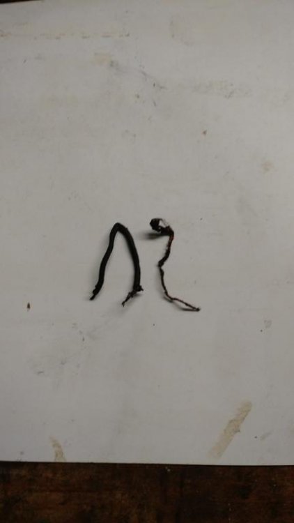

OrlinEngh Posted December 17, 2017 Author Posted December 17, 2017 I found what tore up the oil seal and what was making the bearing feel ruff when turning the final drive, it looks like he must have picked up a piece of wire and it rapped up on the final drive between the oil seal and the bearing, These were a couple of pieces that wasn't balled up. I drained the oil from the final drive and nothing came out in the oil, refilled it and drained it again and nothing, the bearing is pretty well covered so I don't think that any got into the bearing, once I got the seal off and cleaned it out it turns nice and smooth. The things that one finds.
MiCarl Posted December 17, 2017 Posted December 17, 2017 If I felt pretty good about how the bearing felt and looked I'd be tempted not to replace it. That would be a major job. I would plan on doing another inspection before a lot of miles to confirm it hadn't been damaged.
