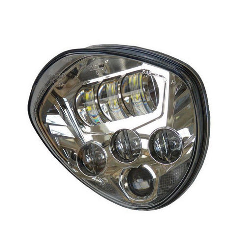

Rafterd Posted November 30, 2017 #4 Posted November 30, 2017 This is what I did. Takes a little work. https://rover.ebay.com/rover/0/0/0?mpre=https%3A%2F%2Fwww.ebay.com%2Fulk%2Fitm%2F282559788361
djh3 Posted December 1, 2017 #5 Posted December 1, 2017 This is what I did. Takes a little work. https://rover.ebay.com/rover/0/0/0?mpre=https%3A%2F%2Fwww.ebay.com%2Fulk%2Fitm%2F282559788361 So how pray tell did you get that headlight to work? The RSV has a sealed lens set up, you only change the bulb. In order to make the Daymaker headlight work you have to cut the glass part of the headlight apart and do quite a bit of work from what I have read. No easy job. The passing lights are a bolt in job. As for the LED headlight bulbs, the issue I have heard guys have to make provisions for is most have heat sinks on the back that get into the wiring or just simply not enough room behind the bulb before it hits the fairing.

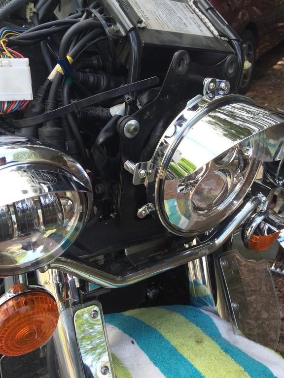

Rafterd Posted December 1, 2017 #6 Posted December 1, 2017 So how pray tell did you get that headlight to work? The RSV has a sealed lens set up, you only change the bulb. In order to make the Daymaker headlight work you have to cut the glass part of the headlight apart and do quite a bit of work from what I have read. No easy job. The passing lights are a bolt in job. As for the LED headlight bulbs, the issue I have heard guys have to make provisions for is most have heat sinks on the back that get into the wiring or just simply not enough room behind the bulb before it hits the fairing. Well sir, you have been misinformed. As I said it takes a little work. You have to modify the original mount to accept the led bucket. No glass cutting at all. Here is a picture that someone on here did a few years ago that I used for a pattern. The adjustment system has to be eliminated, but as you'll see another is installed. Any questions I'll be glad to help.
djh3 Posted December 1, 2017 #7 Posted December 1, 2017 Well OK aint the first time. Looks to work OK. Sure would be best option of LED VS the plug in bulb. As has been mentioned many times on both the LED and HID "replacement" type bulbs, the lens/reflectors dont always give the best desired results. I did have an HID in mine and it worked great. Took some adjusting to get settled right. But this set up wont fit my current headlight.
Rafterd Posted December 3, 2017 #8 Posted December 3, 2017 Wow thats cool looking!! You are correct on putting led or hid bulbs into headlights to replace stock bulbs. They give a lot of bright light, but it's random or scattered everywhere. The light I used is very focused and bright.
