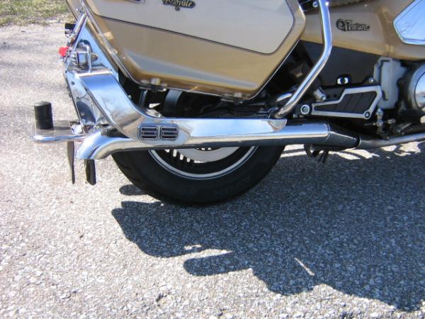

Snaggletooth Posted October 19, 2017 #5 Posted October 19, 2017 Nope. The MKI & MKII are similar but different animals when it comes to mounting them. This is the setup on my '84 with the my hitch, rear light bar and with my turn down pipes.

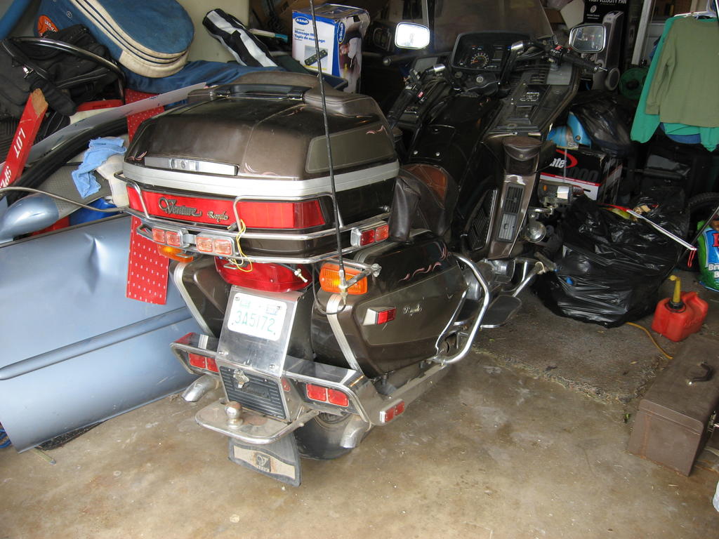

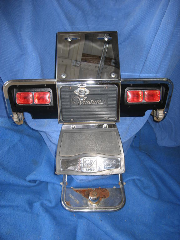

GaryZ Posted October 21, 2017 #10 Posted October 21, 2017 (edited) This is the bumper and hitch that I removed from my ‘85 MKI. The picture with it on the bike was how it looked when I bought it. The picture with the blue background is what it looked like after cleaning it up. I just saw that you are way up north. I will give you the bumper and hitch and you can pay shipping! Edited October 21, 2017 by GaryZ
