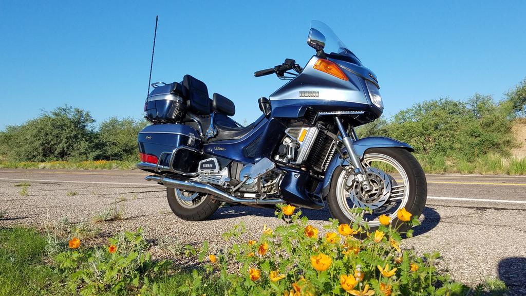

videoarizona Posted April 10, 2018 Posted April 10, 2018 (edited) Update: 4/9/2018 1850CST To All: So FINALLY, the guy got it running! I've had it on the road a few times (couple of 80 mile trips, around town). But, been concerned about not having a horn working and other questions about things I was seeing SO today I started pushing off into it. So now that it's running, charging looks great so no issues there. Front tire SUCKS at 75+MPH...I'm going to be putting ceramic beads in it before running it again to see if that cures the balance issues. SIDE PANELS...WHAT A NIGHTMARE FROM HELL!!! I've had an old GL1200 that was SO SIMPLE to remove/replace these things!!! I'm so pissed at the hell it takes to put them on that I just ride it with them OFF. I need some comments on a few things as I'm now dealing with electrical issues (no horn, some lights not working, brake light issues)...so see below and here we go!!! Handlebar Brake light switch NOT WORKING. This is the serious one. I can hear the microswitch working (clicking). Nothing works on the rear from my right hand, so only the foot brake works the brake lights. Suggestions? Fuses: on the top of the battery all looks fine (none broken). Found a lower FUSE box (in front of the battery) that I found the hazard was blown (15A). Replaced it...gee...hazard lights work. YIPEE! Look...every victory counts... Does anyone have a picture that tells what each fuse is on the top fuses that are on top of the battery? HORNS: Press the horn button and I'm getting a 'clicking' (relay) but nadda on either of them working. Meter shows 0.01 off / and 0.10 when horn switch is depressed at the horn (wires removed to straight test). Uh, where in the hell is the relay? Ideals on what might be my problem(s)? I'm going to be removing them anyways to replace with a VERY LOUD air horns my dad got for his bike back in the '70's (yes, they work...trust me...) :> Seat: How in the name of HADES does that thing come off?????? I want to remove it JUST to see if there's some missing fuses, something not connected because I've got a lot of lights on the back of the bike not working (don't know if they're factory lights OR addon's...) I'm just starting to locate the stuff on this bike that's not working. I found a connector not plugged, so removing the seat is something I need to do. Kickstand: this bike LEANS...and I do mean it LEANS. My mechanic let me know someone laid this bike down HARD. I already knew the kickstand wasn't working right, but wow this thing leans on the kickstand. So much that even some kid I know asked me about it. Yes, it's safe. But anyone dealt with this issue before? Is there a fix? . Side panels simply pop off. Held on by three plastic male thingies that force fit into 3 rubber grommets...and one rubber band on the bottom. I don't have a picture but maybe someone does and they can post it here. Brake light switch - simply unplug the connector and test switch with an ohm meter. If the switch is working, then trace the wiring...you are looking for a broken wire. Fuse info is found in the manual. Both the owners manual and the service manual are available in the 1st gen tech section as others have mentioned. They are free and worth their weight in gold on these bikes. I printed out the fuse info when I first got the bike and taped it under the false fuel cover. The main fuse should be to the left of the battery with a spare fuse holder right next to it. As stated...original horns do not have a relay. If someone put a larger horn on then the switch should be energizing a relay and you just have to find where the wires and relay are. I mounted my relay and wiring next to the battery....maybe they sold you the scoot without the horn??? Seat comes off with 2 bolts, one on each side in the middle of the seat underneath as shown on the video. These bikes are very easy to work on...they appear complicated but in reality are far easier than most bikes out there. The 1st gen Ventures, like yours, are almost bullet proof. They also require little maintenance once you get the previous owners issues put to rest as well as clean up the fuel and electrical systems from almost 30 years of possible neglect. My 89 was bone stock when I got her and she ran beautifully and still does. Since then I've added LED lights, a loud horn, and a R6 rear brake caliper for extra rear braking. I've done all the work myself with limited tools, money and time. I've never found the bike to be beyond my limited knowledge and experience and have relied heavily on the talent and knowledge on the forum to help me when I found myself over my head. In other words, take your time and enjoy the experience. Don't shotgun your maintenance...one thing at a time. You will get her where you want her and you will find yourself riding a very fast and nimble sport touring bike you can take anywhere. Thank you for keeping us posted...and let's see some pictures when you can! my 89... Edited April 10, 2018 by videoarizona add pic
cptriker1 Posted April 10, 2018 Author Posted April 10, 2018 Side panels simply pop off. Held on by three plastic male thingies that force fit into 3 rubber grommets...and one rubber band on the bottom. I don't have a picture but maybe someone does and they can post it here. Brake light switch - simply unplug the connector and test switch with an ohm meter. If the switch is working, then trace the wiring...you are looking for a broken wire. Fuse info is found in the manual. Both the owners manual and the service manual are available in the 1st gen tech section as others have mentioned. They are free and worth their weight in gold on these bikes. I printed out the fuse info when I first got the bike and taped it under the false fuel cover. The main fuse should be to the left of the battery with a spare fuse holder right next to it. As stated...original horns do not have a relay. If someone put a larger horn on then the switch should be energizing a relay and you just have to find where the wires and relay are. I mounted my relay and wiring next to the battery....maybe they sold you the scoot without the horn??? Seat comes off with 2 bolts, one on each side in the middle of the seat underneath as shown on the video. These bikes are very easy to work on...they appear complicated but in reality are far easier than most bikes out there. The 1st gen Ventures, like yours, are almost bullet proof. They also require little maintenance once you get the previous owners issues put to rest as well as clean up the fuel and electrical systems from almost 30 years of possible neglect. My 89 was bone stock when I got her and she ran beautifully and still does. Since then I've added LED lights, a loud horn, and a R6 rear brake caliper for extra rear braking. I've done all the work myself with limited tools, money and time. I've never found the bike to be beyond my limited knowledge and experience and have relied heavily on the talent and knowledge on the forum to help me when I found myself over my head. In other words, take your time and enjoy the experience. Don't shotgun your maintenance...one thing at a time. You will get her where you want her and you will find yourself riding a very fast and nimble sport touring bike you can take anywhere. Thank you for keeping us posted...and let's see some pictures when you can! my 89... http://www.venturerider.org/forum/attachment.php?attachmentid=112064My bike looks just like yours. Yours is Very nice! Sent from my SM-G950U using Tapatalk
videoarizona Posted April 10, 2018 Posted April 10, 2018 My bike looks just like yours. Yours is Very nice! Sent from my SM-G950U using Tapatalk Thank you! And so will yours when you get done. Here is a picture of the first time I took the rear end apart to grease the rear end and found a broken drive piece....Someone on the forum called the position "Kneeling". The front wheel off and the bike resting on the front forks. This gave me room to take off the rear wheel and get in there and clean and grease... I can't believe I did this with very little knowledge of this bike...
