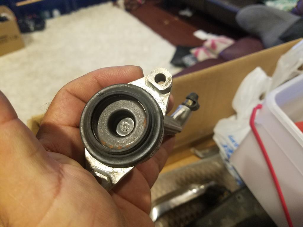

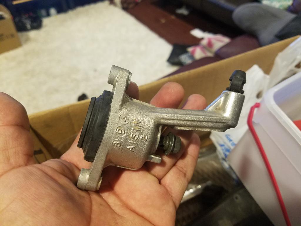

Poncho26 Posted September 21, 2017 Author #43 Posted September 21, 2017 Oh boy ! Top one is the new bottom old I see the new one is a little bit different is that bad? The rubber gasket has a fin that protrudes while the old one doesn't also I swear I can't find the damage in the bore of the old cylinder everybody talks about honning I'll add pictures for you yo see. Sent from my SM-G935T using Tapatalk
cowpuc Posted September 21, 2017 #44 Posted September 21, 2017 Ya the top one looks like its used IMHO. It has wear marks where it looks like the shaft that pushes the clutch open was wearing into the pocket on the piston and it appears to me that the rubber that tucks in behind the piston is sticking out = thinking that is what appears to the prutusion your seeing. To see the area that has to be honed on a rebuild you have to drive the piston out..
Poncho26 Posted September 21, 2017 Author #45 Posted September 21, 2017 Mr Puc nice to read you again how was surgery hope everything is ok. Well about the clutch slave cylinder i took the thing out and the inside looked good and I just finished Putting everything back tomorrow I will fill the master cylinder with dot 3 and let you know how it went good night. Sent from my SM-G935T using Tapatalk

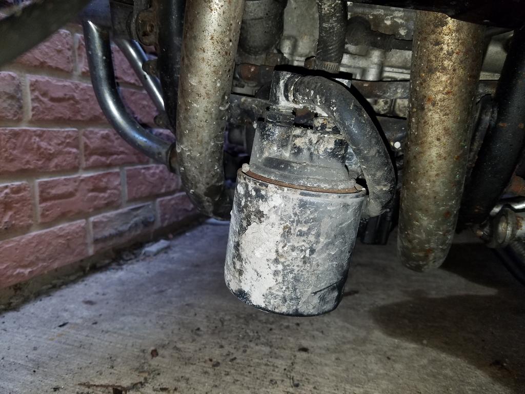

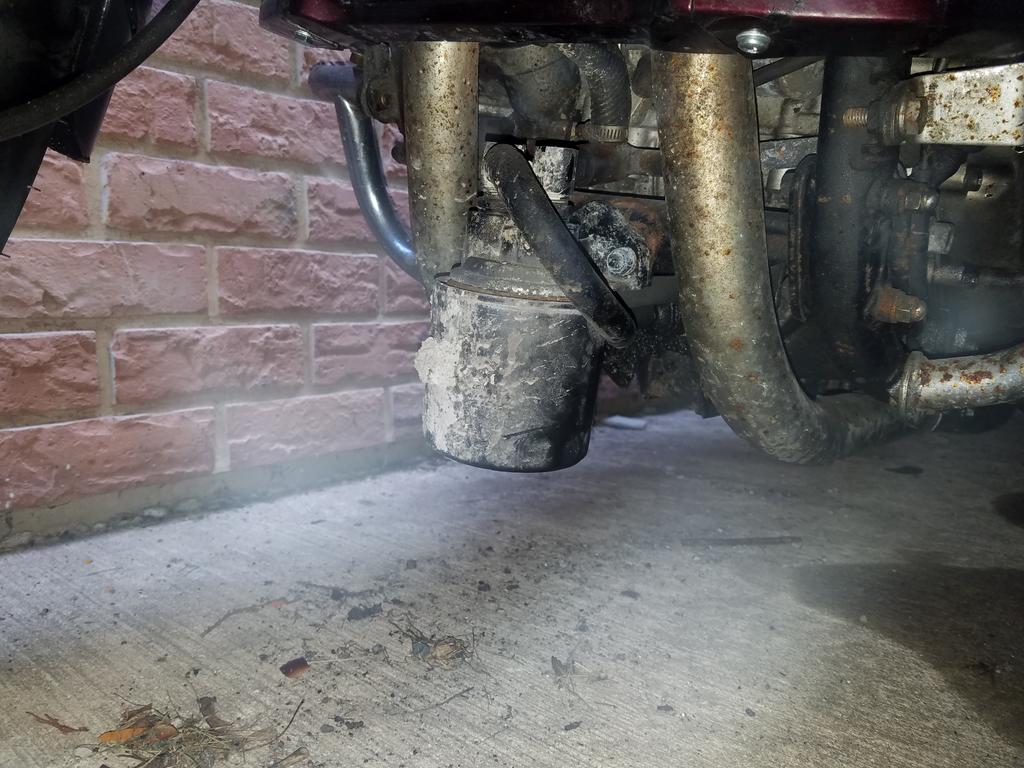

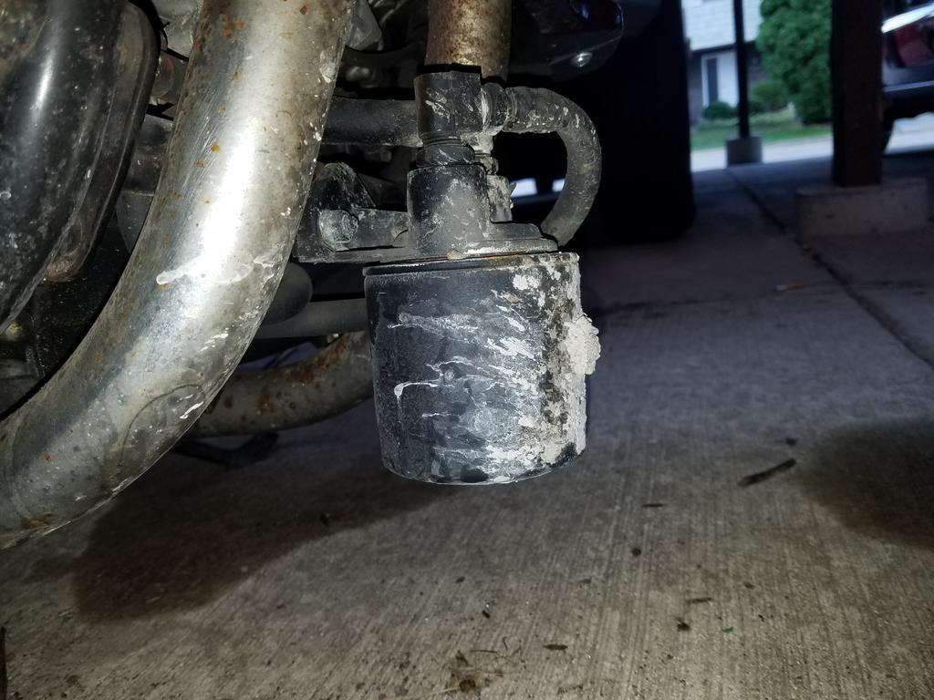

Poncho26 Posted September 22, 2017 Author #47 Posted September 22, 2017 Why my oil filter looks like this?
cowpuc Posted September 22, 2017 #48 Posted September 22, 2017 Why my oil filter looks like this?http://www.venturerider.org/forum/attachment.php?attachmentid=110475http://www.venturerider.org/forum/attachment.php?attachmentid=110476http://www.venturerider.org/forum/attachment.php?attachmentid=110477 WOWZY,,aint got near the time with these things as many of the guru's around here but I aint NEVER seen nuttin like that before.. Personally, that would never work for me - it would be laying under the scoot and oil would be shootin out of the front of my motor on our first day headed west.. Not good IMHO.. On the same token though, spinning a filter on and off would sure be east.. Do you know what they are suppose to look like Ponch? I can snap a pic for ya if you would like..
snyper316 Posted September 22, 2017 #49 Posted September 22, 2017 Why my oil filter looks like this?http://www.venturerider.org/forum/attachment.php?attachmentid=110475http://www.venturerider.org/forum/attachment.php?attachmentid=110476http://www.venturerider.org/forum/attachment.php?attachmentid=110477 :confused: ummmm What in the @$)@ is that.... Sure this 84 yamaha? nothing like i have ever seen... are you playing a funny on us.... odd

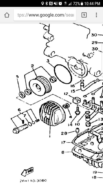

Poncho26 Posted September 22, 2017 Author #50 Posted September 22, 2017 Hahaha! Damn what I've gotten my self into Thank you Mr Puc but I dowloaded a drawing I wonder if i can go back to the stock filter
