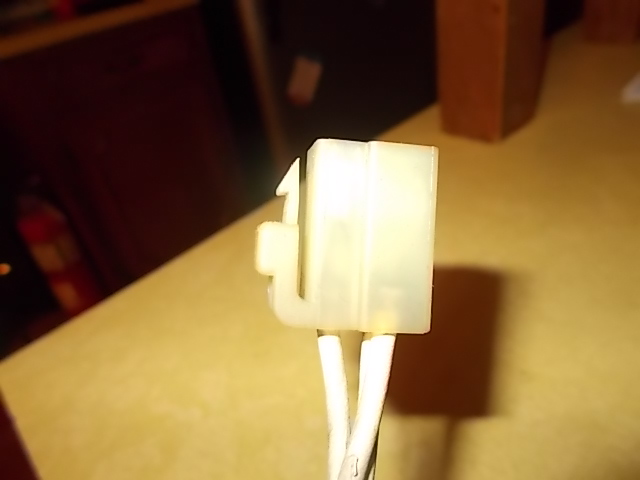

mm482 Posted August 29, 2017 #7 Posted August 29, 2017 This is the stator end plug, that's under and in front of the battery and fuel filter.
