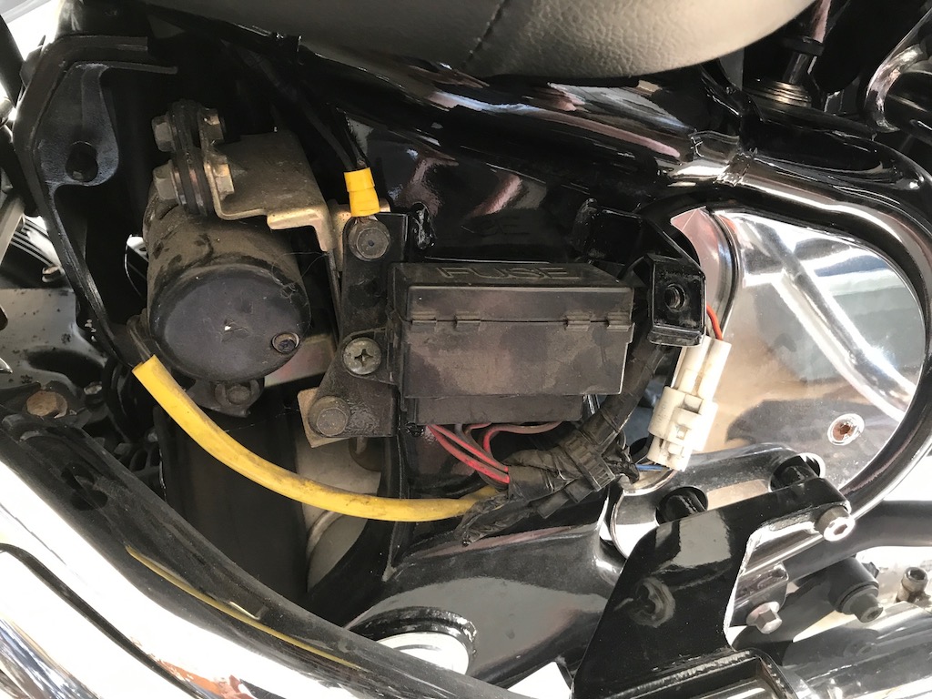

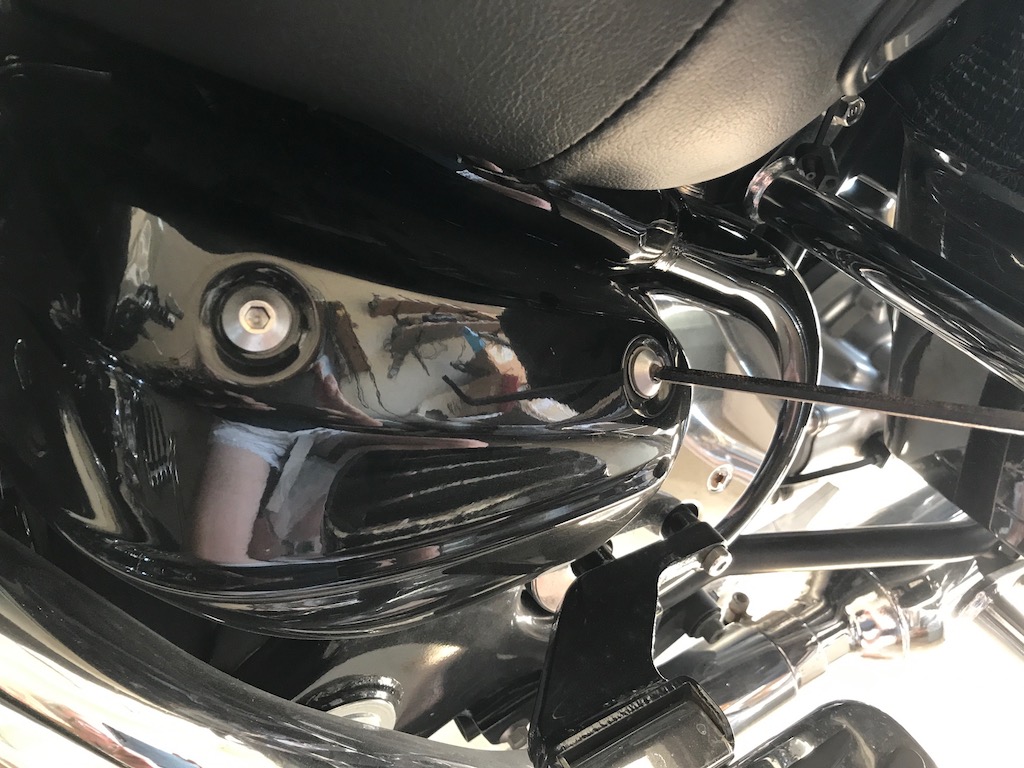

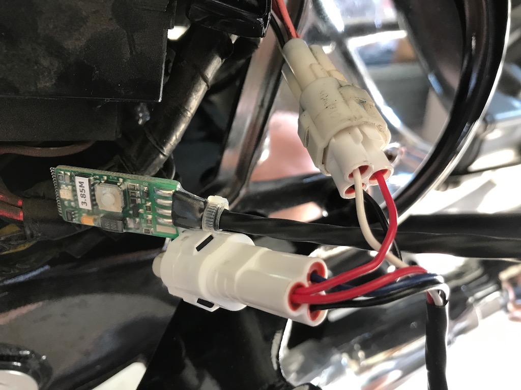

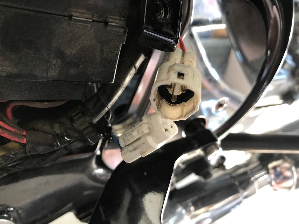

Freebird Posted September 4, 2017 Author Posted September 4, 2017 (edited) As promised, here are some pictures that show you where the SpeedoDRD installs. I had the SpeedoHealer on the '99 and it installed the same way. I'm not going into detail regarding the actual programming because I can't show you any better than what SpeedoDRD does on their website. I'll provide links to their instructions at the end of this though. First of all, simple remove the left side cover. You only need to remove the one screw where you see my allen wrench. The front one is a dummy. Remember that because that front one is what you need if you don't know to put blue locktite on your shifter. When you lose that screw on the highway, This front "dummy" screw will replace it. Anyway, remove the screw and then just pull straight out on the cover to pop it out of the rubber grommets on the front. Once you have removed the cover. This is what you will see. The white triangular connector is what you want. Simply depress the little tab and unplug the two halves. This is what you should see now. Now just plug the two connectors from the SpeedoDRD or your Speedohealer into those separated connectors. In this picture, you can see the small white button just above the white tag with the model number on it. That is the button that you will press to do the programming. That's all there is to it. Follow the instructions at these two links to learn how to find your speedometer error and then how to program the device. This is a job that literally ANYBODY can do. Don't worry about it. Just do it if you want to correct your speedometer. I used the GPS method to determine my error. You could also use mile markers and a stop watch if you wanted to. If you don't have a GPS, you can download an app for most any smartphone that will give you a pretty accurate speed reading. Here is what the SpeedoDRD says about it. "A GPS device is usually the best method, make sure the device has good signal strength, and you are traveling at least 55mph or 60mph (or 100kph) as displayed on your GPS, you'll want to hold the speed completely steady at least 5 to 10 seconds, so that both the vehicle speedometer and GPS is at a steady reading, then use those readings for your calculations. Also, another thing to remember is that most vehicle speedometers usually only give whole number readouts, as well as most GPS devices, thus when your GPS or vehicle speedometer reads 55mph, you could be traveling 55.0mph or 55.9mph, when calculating your error percentage at multiple speeds remember to take this into consideration, this situation as well as possible GPS accuracies, may very well account for any suspected speedometer dis-linearity." Once you have determined your indicated speed and the GPS speed, you can use this link to their online error calculator. When you do this, it will give instructions at the bottom for exactly how to program the unit. It literally takes about 5 minutes to install this thing. It takes longer to go for the ride and determine your error. http://www.12oclocklabs.com/sdrd_calc.htm Edited September 4, 2017 by Freebird

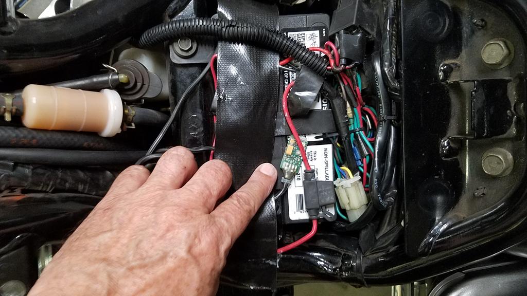

videoarizona Posted September 4, 2017 Posted September 4, 2017 Freebird, I tucked mine up under the seat, under the rubber battery tie-down. (I pulled it out to show). The cable run also has plastic ties along frame. They gave me enough cable to do so. That way it is out of the weather. They still come with enough cable to do this? Plus note where my fuel filter is. Previous owner did that, and boy am I thankful for his forward thinking!
Freebird Posted September 4, 2017 Author Posted September 4, 2017 Yes, there was probably enough cable. Maybe I'll do that the next time I have the seat off. To be honest, didn't even think about it. Not too concerned but your way would be better.

Condor Posted September 10, 2017 Posted September 10, 2017 Thanks for the pics. What a breeze to install... Now I have one question. Is there anything that covers the PC board to protect it from the elements?? Or does it just hang there in the breeze... pun intended... :-)
Freebird Posted September 10, 2017 Author Posted September 10, 2017 It just hangs there are wherever you put it. It comes with a couple of Nylon ties. It has a thick rubber like clear coating on it.
Condor Posted September 10, 2017 Posted September 10, 2017 It just hangs there are wherever you put it. It comes with a couple of Nylon ties. It has a thick rubber like clear coating on it. It didn't look like there was anything around it or covering it from the pics... Now I know... :-)
MikeWa Posted September 11, 2017 Posted September 11, 2017 I got to take a little longer test ride today. My speedo now agrees with my speedometer almost exactly. Tested at 25mph 30mph and 60mph. My speedometer and TomTom GPS now seem to agree almost exactly. As minor as it may seem it is a relief having an accurate speedometer. Mike PS The SpeedoDRD is coated with a rubber/plastic coating that should protect it from the elements.
