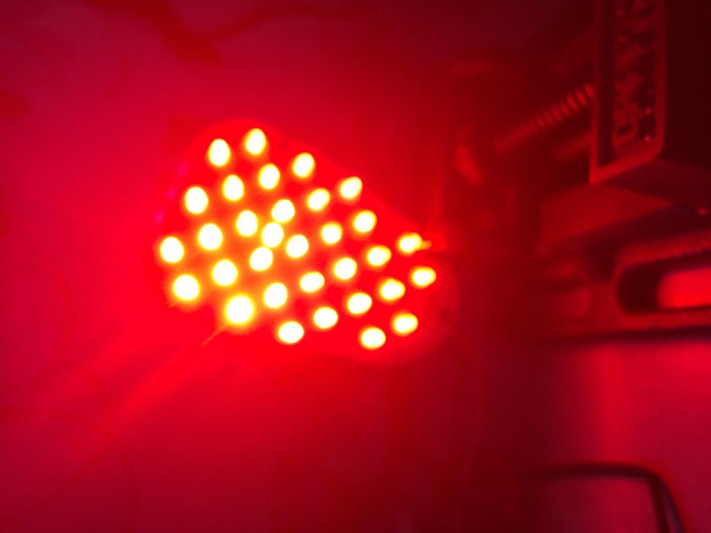

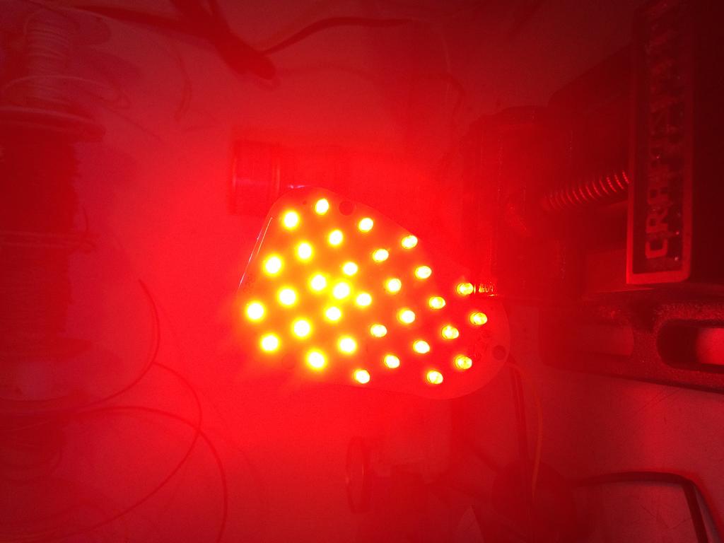

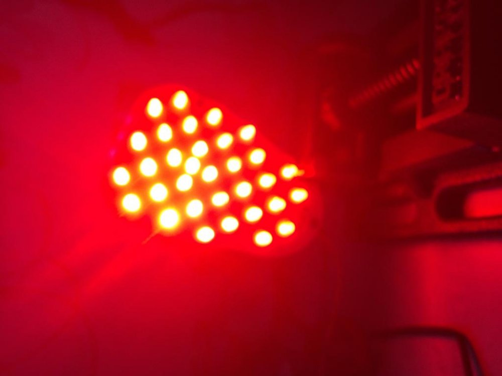

M61A1MECH Posted October 3, 2017 #26 Posted October 3, 2017 Steve: Let me know if you are able to repair it...just curious Thanks OK I have it basically repaired, it is working I am just not happy with how I grafted it on to a bulb base to make it plug and play, a bit more effort and research on that part is required.
Raven1294 Posted October 3, 2017 Author #27 Posted October 3, 2017 OK I have it basically repaired, it is working I am just not happy with how I grafted it on to a bulb base to make it plug and play, a bit more effort and research on that part is required. Glad to hear you got it fixed! If you need it or someone else does I hope they get good use out of it...Thanks Steve
M61A1MECH Posted October 3, 2017 #28 Posted October 3, 2017 I just found a premade bulb base with pig tails so that is on order, I have spare resistors and LED bulbs if any one else needs one repaired, now that I know how to do the repair and what parts are needed it will be easy to repair others.
Flyinfool Posted October 3, 2017 #29 Posted October 3, 2017 SOOOOOO Curious minds like to know. What was the issue?
M61A1MECH Posted October 4, 2017 #30 Posted October 4, 2017 SOOOOOO Curious minds like to know. What was the issue? Found one blown 180 ohm resistor and two blown LEDs, the resistor was first in that particular circuit and the two blown diodes where in series right behind it. The board is set up with one 180 ohm resistor for every 4 LEDs. There was no evidence of heat or arcing, so I am not sure what the initial fault was.
