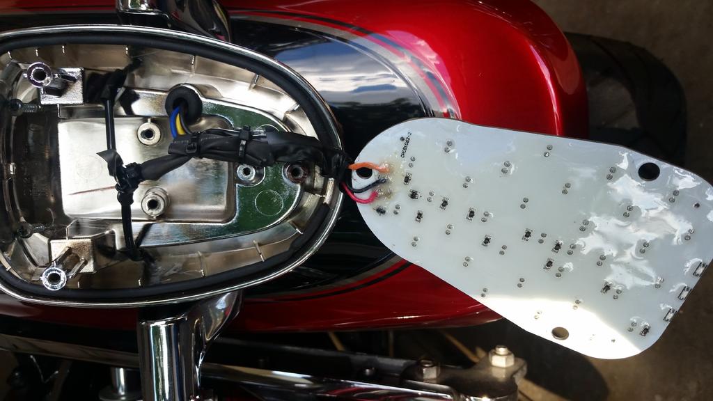

Raven1294 Posted August 21, 2017 Posted August 21, 2017 I have a 2005 RSTD and a few of the LED bulbs burnt out, was wanting to replace the board, I take the link below is the one I need? I notice it has a bulb base to plug into the socket but it appears someone cut it out and spliced the wires instead, guess I will have to cut the old one off and splice and solder in the new one? Didn't know they were so expensive either. http://www.ebay.com/itm/Yamaha-XVZ1300CT-Royal-Star-Tour-Deluxe-2005-2009-LED-Taillight-2010-0819-/361351162493?hash=item5422352a7d&vxp=mtr&rmvSB=true#ht_3761wt_869

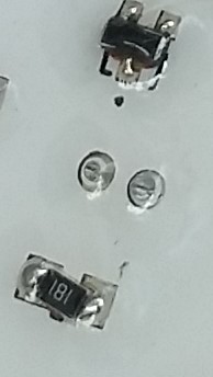

Flyinfool Posted August 22, 2017 Posted August 22, 2017 With as expensive as these are I would do some checking to see if I could repair it. With 4 out all in a group I am thinking a broken solder joint or a bad resistor on the board. Both very cheap and easy fixes.
Raven1294 Posted August 22, 2017 Author Posted August 22, 2017 (edited) Where would you get it repaired? I'm not any good at soldering myself and it looks like it may be one of these two or both that are bad on the board Edited August 22, 2017 by Raven1294

Raven1294 Posted August 22, 2017 Author Posted August 22, 2017 in the picture above of the wiring in the tail light the two wires going to the left and the right through those holes goes to the blinkers which are also LED, my question is does the board I have currently have integrated blinkers? Why would it be wired up like that?...Thanks
M61A1MECH Posted August 22, 2017 Posted August 22, 2017 in the picture above of the wiring in the tail light the two wires going to the left and the right through those holes goes to the blinkers which are also LED, my question is does the board I have currently have integrated blinkers? Why would it be wired up like that?...Thanks Do your blinkers also work as tail lights? Many of the after market LED turns are set up with red and amber LEDs so they can be running lights and turn signals. If this is the case they may have tapped into the tail light circuit there in the tail light housing.

Raven1294 Posted August 23, 2017 Author Posted August 23, 2017 Steve: You are correct Sir! The blinkers are being used as tail lights also.

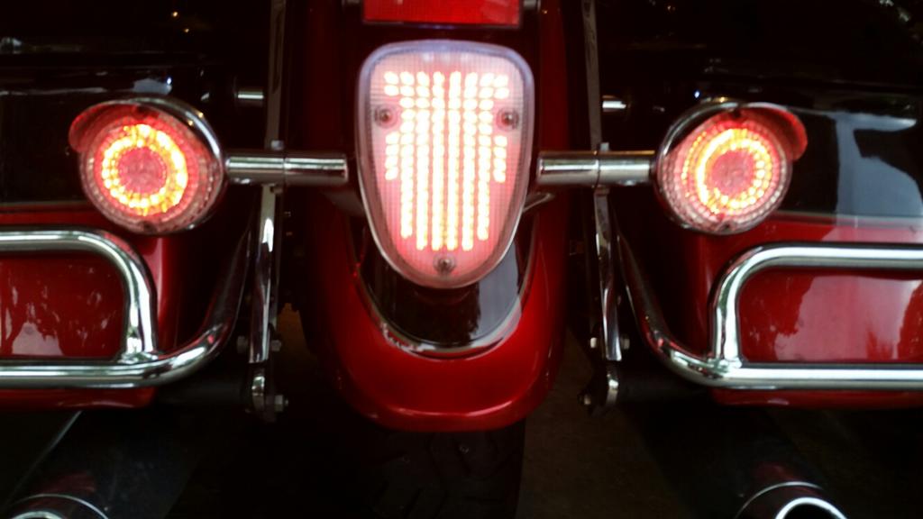

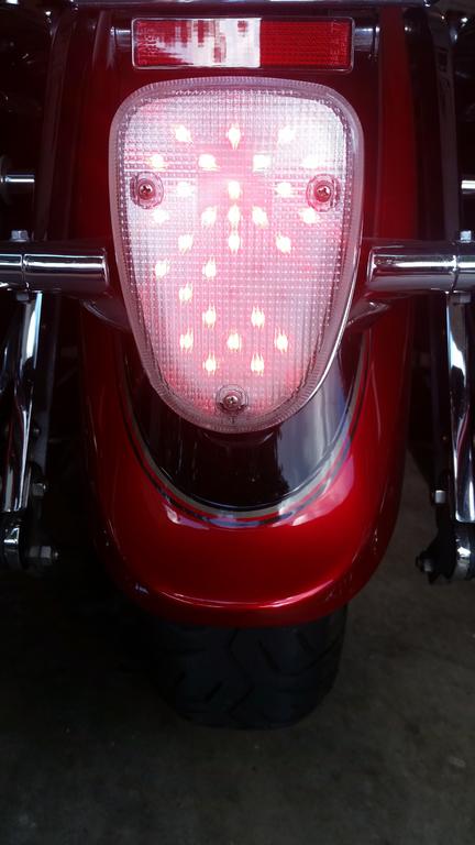

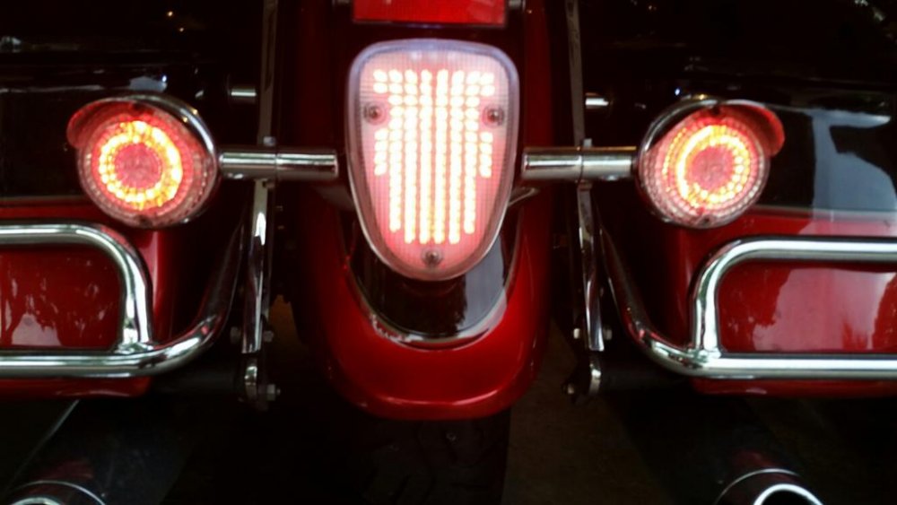

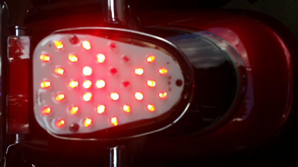

Raven1294 Posted August 29, 2017 Author Posted August 29, 2017 (edited) ok went ahead and ordered the new board and all soldered in place, looks great! Thanks guys! oh and Steve email your address and I will send you the old one if you still want it, pic of the old one with the 4 bad led bulbs and the new installed one. Edited August 30, 2017 by Raven1294
