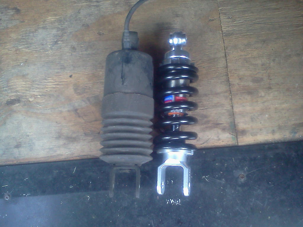

sfcrader Posted July 8, 2017 Posted July 8, 2017 Not to highjack the thread, but I just replaced my rear shock with Hagon last night. I tried to contact the dealer here in the USA but got the same reply. So I did the next best thing and contact the company in the United Kingdom. I sent them an email on June 14th and on June 16th received and email that they would start working on my shock. On July 3rd received email shock was ready just needed to provide payment info, Total cost shipped $394.42. On July 5th replacement shock depart the United Kingdom and arrived at my door step 11:30 am Yesterday July 7th. At this point I can say that the bike does sit about 1 inch higher than before, hope to take it for a ride this afternoon. To me the hardest part was getting the bike up and taking the old out. Not sure it the shock was bad, but the ride was not like it use to be, not a soft or smooth ride but hard when going over bumps and railroads crossings. Even on some of the same old roads I have done over and over it was not the same. sales@hagon-shocks.co.uk this is the email address I used. Emailed them weights riders, kind of style 50/50 (solo/dual) and that I tow a trailer once a year.

baylensman Posted July 12, 2017 Posted July 12, 2017 so HAGON us list the shock as $474.00 while Hagon UK list the shocks at 299. pounds sterling which at current exchange rate is $385.00. still looking for a good used one to throw in the shed. Mine still works holds air and doesn't leak. Maybe the PO had it done under warranty? Have to look closer one of these days
