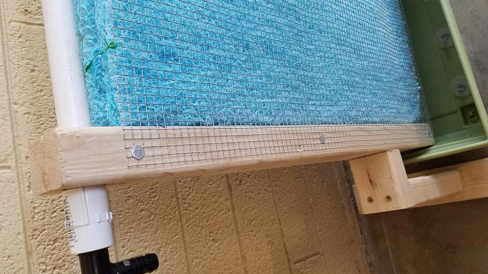

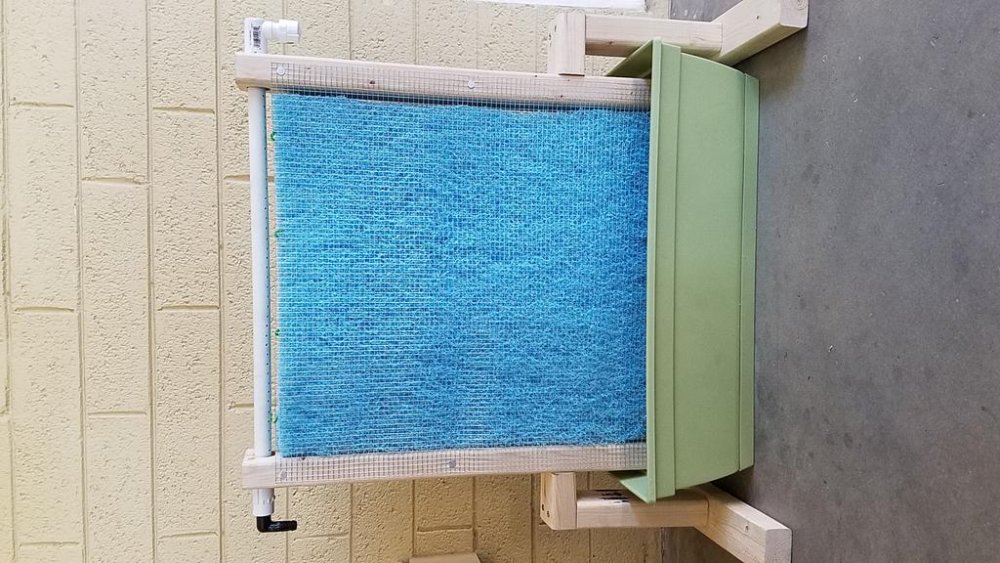

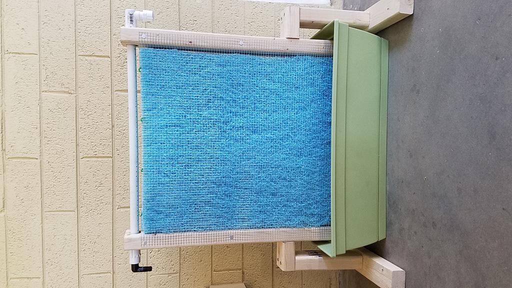

Decided to make a little swamp cooler for use in garage. Saw this little design on you tube.

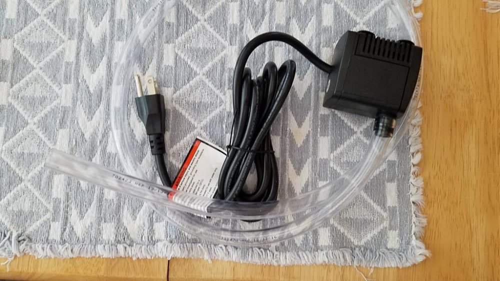

Uses a 2x3, Harbor Freight pump ($8), some screen material, 12 wood screws, 2ft of 1/2 inch pvc and two 90 degree elbows, hose bib and cap. Drill 1/8 holes in pvc.. About every 1/2 inch. The media is 2 courses of cooler media. And a window box for the water. Entire thing costs around $60.
I epoxied the drain holes in window box, built frame, used roofing rype nails to hold screen on frame.
Fun stuff...
Once epoxy has cured, I'll throw pump in box, add water then set a 20 inch box fan on one side. Turn everything on and enjoy cool air. At least it will be cooler than typical Arizona heat!
Btw, this will only work when the dew point is below 55 degrees. Any more than that, the air is to saturated to cool much.
