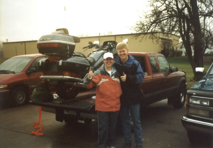

Bob K. Posted September 15, 2018 #23 Posted September 15, 2018 (edited) My trusty 1997 Ford Ranger has been carrying my 1993 Royale around for about 15 years. (Wow, who is that young guy???) I use multiple straps for a measure of failsafe-ness. One from each fork just above the lower pinch point to the front tie-down hardpoint in the bed corner. Then another strap through the triple-tree in case one of those primary straps breaks. I also learned not to compress the front forks too much but rather to let them compress and decompress as they wish. I think over-compressing them left me with a leaky seal one time. I ratcheted them down maybe a third of their normal travel length. Each of the two independent straps on each fork, then, was enough to hold it in place. When I went around corners, one strap would tighten and the other strap would loosen as the forks compressed. Then the forks would decompress and both straps would share the weight. The whole setup sorta lets the bike float comfortably in the bed. I've never had an issue with the load itself. As others have said, the hardest part is finding a place to load and unload it. I've used ditches, train loading ramps, motorcycle shop ramps, and commercial riding lawnmower shop ramps (the big concrete ones, not the independent metal ones used for ATVs, etc.). Edited September 15, 2018 by Bob K.
uhfradarwill Posted September 15, 2018 #24 Posted September 15, 2018 I got my 89VR home in the bed of a big honkin dual-wheel Dodge diesel. We hand a nice hill to back up on and aluminum ramps. Strapped her down and had no probs. Kudos to the guy haulin his Venture in the bed of the Ford Ranger!!
