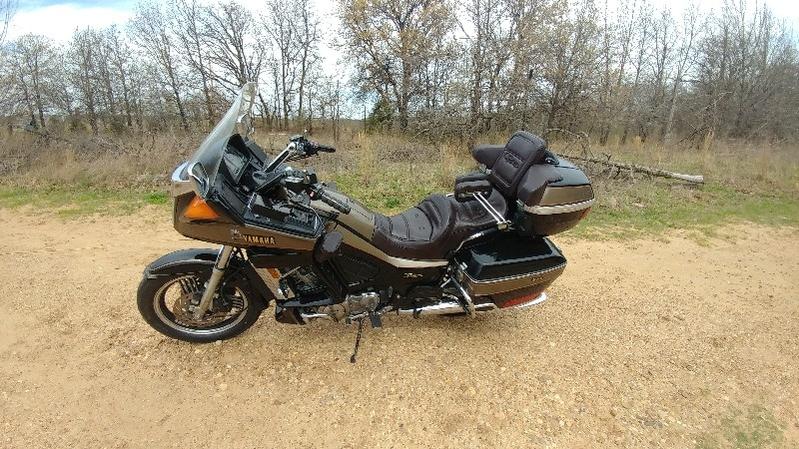

mcompton1973 Posted May 2, 2017 #1 Posted May 2, 2017 ok. I have my new to me '86 which is a gorgeous machine....but has a weird carb (or not carb issue) that has been detailed on here by the previous owner. Basically when good and hot, if you shut it down the carbs will overflow when you try to start it again. part of me wonders if this is actually a fuel pump issue. (had a jeep with a fuel pump go bad...wasnt a lot different symptoms) I am thinking that it would be worth the time to replace it regardless. 1. Any good "how to" on that. 2. I have seen a 'Mr Gasket' fuel pump....is that what I need to buy? Also, I now have a donor bike. another '86 Royale. It hasnt been titled in 4 years. I was told stator or something similar is wrong. I MIGHT at some point try to get it running (it has a title...lol) for now, it is parts bike. If I DO try to get it running, it would have to be a rat rod project. Missing much plastic, and over all rougher condition. Because the carbs on my bike have been a problem, was thinking of cleaning the ones off the parts bike....see also if that helps the issue. I have found this in the other sites tech library http://www.venturers.org/Tech_Library/index.php?action=article&cat_id=001010&id=366 1. Is that the best how too, or is there videos or something else I should look into? 2. Is the ebay carb kit going to be what I need for parts, or is there something better? 3. Anything else I should do when I have carbs off etc?

mcompton1973 Posted May 2, 2017 Author #6 Posted May 2, 2017 Is this that stunning 2 tone black/gold machine we saw a few weeks back with the carb difficulties? Yes.... Love, love, love the bike.... But I have been afraid to put many miles on it until I figure this issues out.
