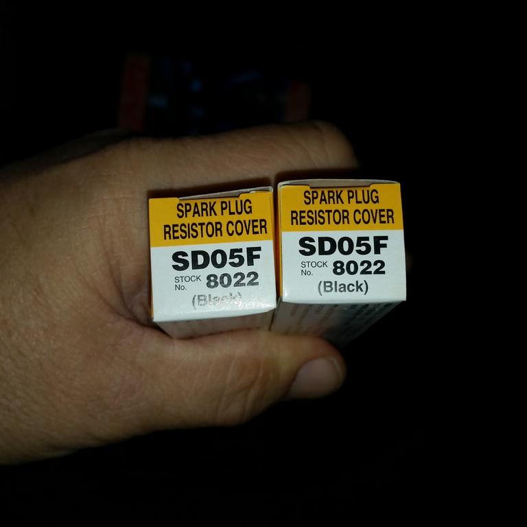

BlueSky Posted April 29, 2017 Posted April 29, 2017 Yeah, it's probably a design improvement having the whole cap/wire/unit sealed. Because as most of the 1st gen owners know moisture gets into the cap/wire joint and corrodes the wire and eventually causes a problem. The good part is that caps are $2.60 ea at NGK.com and copper wire is cheap. I suppose we should be using a touch of dielectric grease on the joints.

Liptoss Posted April 30, 2017 Posted April 30, 2017 Yamaha chose to make the wires a permanent install to the coils on my 1984 XJ750RL as well. This is not a new choice and procedure for them. I don't understand why they couldn't make the coils/wires/caps the same install as on the VMX12 line? Totall serviceable. With my XJ back in approximately 1986 or so, I found and purchased NGK caps only and installed them on the original wire ends easily. I can't recall if they had resisters in the caps, or not. I may have removed them though. The resistors are to suppress cross channel noise with regards to CB radios etc. I've been told. The cap I found are two right angle shorter read for the outer cylinders and two longer reach/deeper much like the Venture and VMax units. They've worked great for the 30 some odd years I've used them. ill post a picture when I get outta bed.
