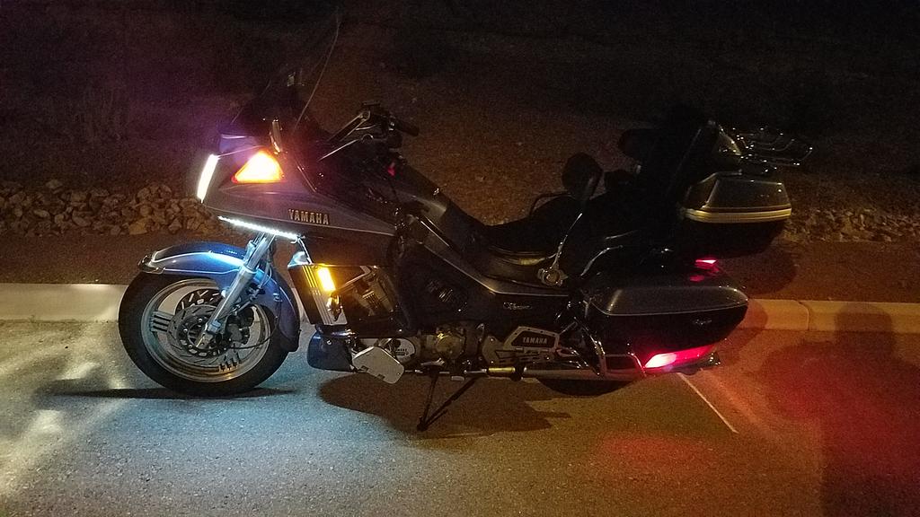

videoarizona Posted April 28, 2017 #8 Posted April 28, 2017 Puc, On a slightly different direction....(I'm still undecided about changing my 89's headlight bulb). But have added LED's up under the cowl connected to the running lights at the turn signals. They light up the road right under the front end for slow riding at night and make me more visible for cars as they pass me by... Bought the little strips at Wal.Mart. Simple stuff but I like the look. Thinking it would be great for you as you FTFW in the boonies looking for a place to pitch the tent!

cowpuc Posted April 28, 2017 Author #10 Posted April 28, 2017 (edited) videoarizona = WOWZY capowzy do I like the looks of that brother!!! DEFINITELY gotta go there!! THANK YOU!!! Might be in touch on hook up BUT - I already have a plan in my head using an existing toggle/tapping into wiring for lights on my crash bars that were already there - WOW does this bike have the bling already installed!! May also check into just swapping out the bulbs in the crash bar lights for LED's... Thanks Bongo and Fool for the jumpering tips - THAT is what I was looking for. Also Thanks to all who assisted.. Here is a link to the LED headlight I am thinking very seriously about going to - my buddy thinks he may be able to pick one of these up for me for about 100 bucks on his business account: http://www.ebay.com/itm/Truck-Lite-27450C-One-Rectangular-LED-5-X-7-Ford-GM-Van-Jeep-XJ-YJ-Headlight/182540011083?_trksid=p2047675.c100005.m1851&_trkparms=aid%3D222007%26algo%3DSIC.MBE%26ao%3D2%26asc%3D40130%26meid%3D241075847f5d4969ab04e33af6768c3f%26pid%3D100005%26rk%3D6%26rkt%3D6%26sd%3D252834342344 I did take one of the old lights that my neighbor had in his semi (before he went to this type) and BINGO - it set right in the mounting bezel like it was made for it.. He is driving right now (probably down in Texas as I type this) but he/I will pull one of his LED headlights when he gets back - jumper those wires and see what happens... This could get interesting.. I've been using "The Force" for so long at night I hope I am able to do this... Edited April 28, 2017 by cowpuc
