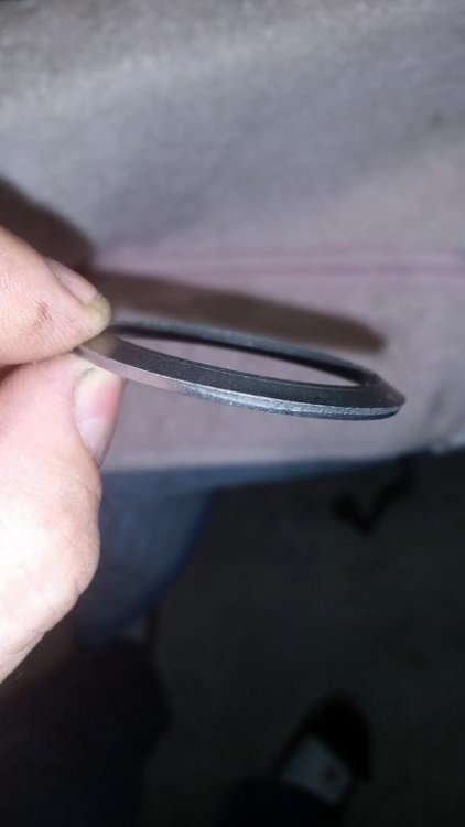

CaseyJ955 Posted September 10, 2017 Author Posted September 10, 2017 Might as well kick this zombie thread in the pants. I started this when I blew the right fork seal after a fresh rebuild. Just yesterday the left one blew. Freshly rebuilt forks, I'm getting sick of tearing these things apart. I'm going to go make a seal saver out of a coke bottle and try that first. When these things blow they dont just weep, they piss the oil out for real. Man this is frustrating but at least it didnt fail on my last road trip.
camos Posted September 10, 2017 Posted September 10, 2017 I'm going to go make a seal saver out of a coke bottle and try that first.How does that work? Can't imagine a coke bottle being good for anything other than bleeding brake fluid into.
CaseyJ955 Posted September 11, 2017 Author Posted September 11, 2017 How does that work? Can't imagine a coke bottle being good for anything other than bleeding brake fluid into. It's quite a bit like a poor mans seal saver. For some reason I suspect it's all coming apart again.
camos Posted September 11, 2017 Posted September 11, 2017 It's quite a bit like a poor mans seal saver. For some reason I suspect it's all coming apart again.So hang a plastic bottle on your forks? You wouldn't do that to your Venture...would you? Put some gaiters/shock boots on, they aren't that expensive. They were OEM on my 90 VR and I put a set on my 89 VR because they are such a good idea.
cowpuc Posted September 11, 2017 Posted September 11, 2017 So hang a plastic bottle on your forks? You wouldn't do that to your Venture...would you? Put some gaiters/shock boots on, they aren't that expensive. They were OEM on my 90 VR and I put a set on my 89 VR because they are such a good idea. and here I thought Casey was talking about using the edge of a plastic coke bottle that he had sliced open with a knife to slide down in between the seal and the tube to clean out the garbage in the seal allowing it to seal again.. I have used old 35mm film for this for years and know that a company caught onto that idea and started making a plastic shaped pointed thingy to accomplish the same thing.. Back in my mx days it was very common to clean the seals because of the dirt involved with the sport.. If a person rides a fair amount on the road even bug splatter on the tubes can cause issues.. I can certainly see where fork gators would be the cats meow for extra protection.. Had those for years on the early dirt bikes, later models like my KX500, CR's and stuff we had plastice covers over the front of the forks which served the same purpose (called em fork roost protectors) and did great.. I have a set of roost protectors on my 1st Gen now - get this,, they are even CHROME!! I can see where slicing up a plastic coke bottle and using it for a roost protector could EASILY and fully do the same job with no where near the hassle of rippin the forks down to do gators = maybe Casey and I are related if thats what he is referring to
camos Posted September 11, 2017 Posted September 11, 2017 I can see where slicing up a plastic coke bottle and using it for a roost protector could EASILY and fully do the same job with no where near the hassle of rippin the forks down to do gators = maybe Casey and I are related if thats what he is referring to Somebody on here offered some leather covers that did the job and looked quite nice. If Casey has to replace the seals then he will most likely have the forks apart anyway. These are the ones I put on my 89. They fit perfectly and I prefer how they look.
CaseyJ955 Posted September 11, 2017 Author Posted September 11, 2017 and here I thought Casey was talking about using the edge of a plastic coke bottle that he had sliced open with a knife to slide down in between the seal and the tube to clean out the garbage in the seal allowing it to seal again.. Yup, thats what I had in mind. When the other side blew (mind you, with all new OEM parts and very few miles) I tried it unsuccessfully, so not sure it's going to work this time. Somebody on here offered some leather covers that did the job and looked quite nice. If Casey has to replace the seals then he will most likely have the forks apart anyway. These are the ones I put on my 89. They fit perfectly and I prefer how they look. You guys are awesome, I had quite a chuckle picturing cut up coke bottles serving as fork protectors. I guess duct tape and zip ties would be the finest way to make this dream a reality mwahahahaha. This bike has the chrome shields that hose clamp to the upper tube. I'm going to try the seal saver sweep today and hope it works, not sure whats inside. When the right side blew there were metal shavings inside and I never could figure out where they were coming from. Nothing was scarred or grooved, no signs of contact, the fork compressed and expanded freely with no scuffing or drama. It's a mystery at best. I'm not wanting it to be down for long, the last few weeks of amazing riding season are upon us now, the tourists are mostly gone.
