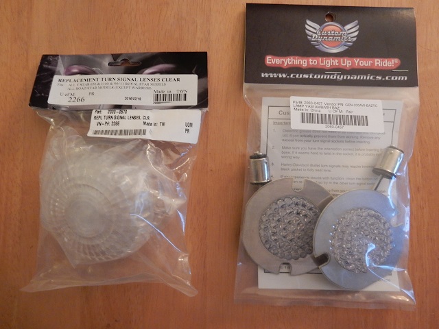

Custom Dynamics makes LED replacement for turn signals that allows them to function as both turn signals and driving lights.
Switching from light bulbs to LED's affects the blinker rate. To correct this, Custom Dynamics recommends a load equalizer, 7.5 ohms to ground
on each light. They caution that unit gets hot, and recommend that unit be mounted under seat. Any suggestions on how to locate unit under seat
and tie into signal wires with the posi-locks?
Thanks!

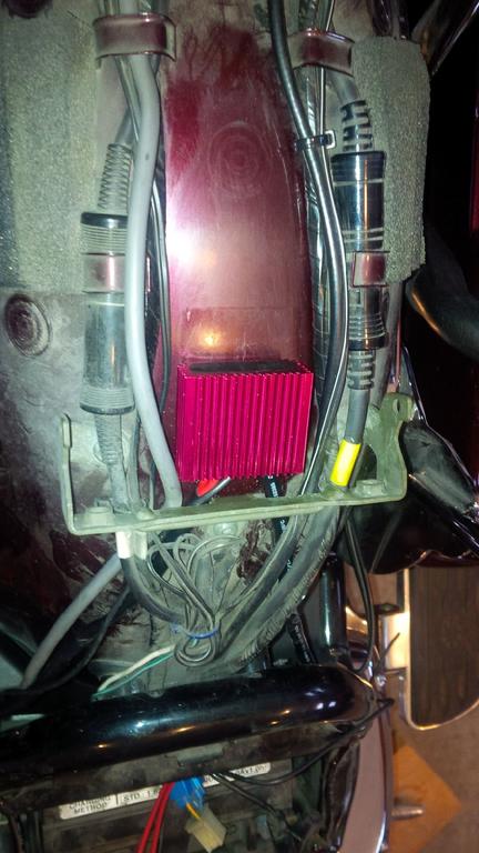

I used a quad load equalizer and placed it under the passenger seat on top of the rear fender. This way the heat sink contacts the fender directly and offloads the heat. At this spot it was easy to connect to rear harness but I had to run separate wires to the front lights in the channels under the gas tank. Hope this helps. I attached a pic of the quad equalizer. Its from Big Bike Parts.
Have to pull my seat and tank anyway, so I'll see what I can do. Since I have a trike, there is no metal fender, but should be
able to find some metal. Thanks Bert!

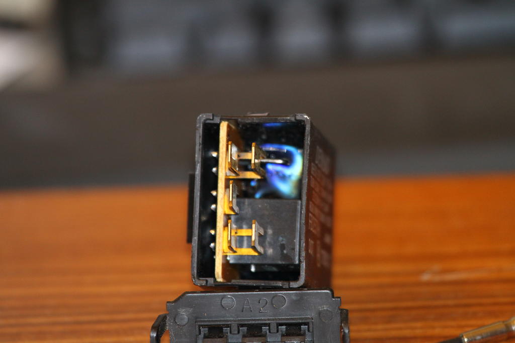

Steve, Flasher mod looks like a great way to go. Had the flasher in hand but couldn't open it. I was concerned about damaging it. Now I have
a dilemma. Please hold off on sending me the aux harness. I'll take another look at the flasher to see if I can make sense of it. Thanks!

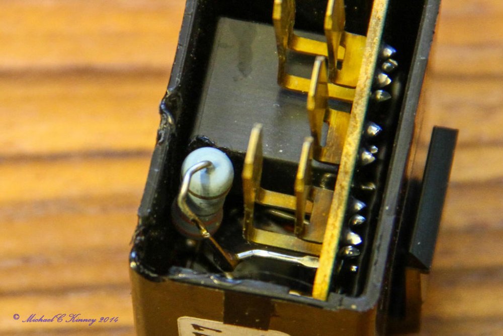

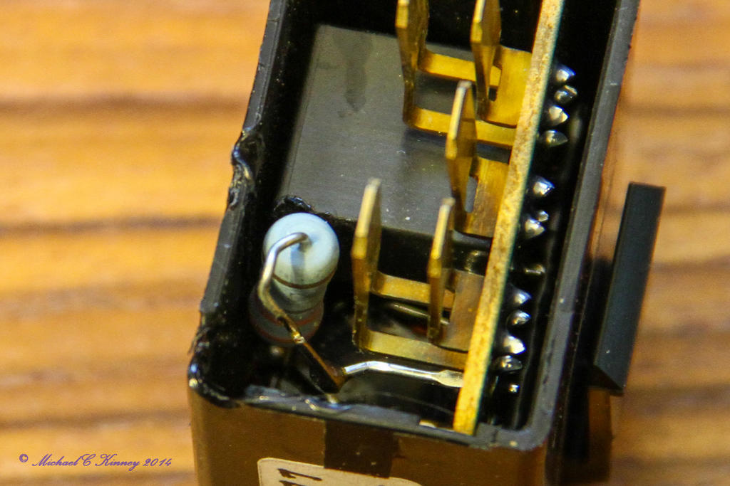

Ok this is something I have posted about before. If you open the flasher. Cut the bare wire as seen in the photographs and solder in a .33 ohm resistor it will slow the flasher rate.
Mike

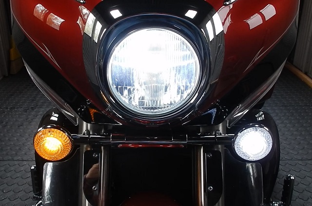

Okay, all trike lights are LED, except dash lights. Not sure flasher mod or load equalizers are necessary for turn signals. Looks okay to me, and
leaves motorcycle with standard flasher. On to next project... :thumbsup2:
