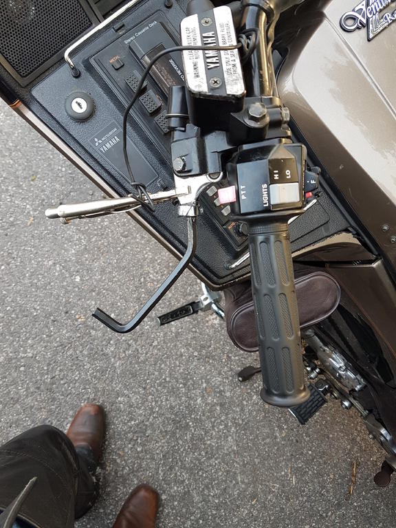

uhfradarwill Posted September 17, 2018 #16 Posted September 17, 2018 Smooth clutch handles are for sissys. I like the allen wrench/vise grip combo. A real mans clutch lol
greg_in_london Posted September 17, 2018 Author #17 Posted September 17, 2018 (edited) Unfortunately the 'proper' way of checking the fuel level is to check it on the bike with the engine running and with the mid-cover off and the clutch bits off I don't want to start her up. I don't really want to take the carbs off before putting the clutch system back together - one thing at a time I'll know I'll get on with, but too many things at once and it becomes a project that gets left forever. I ordered a set of those welder cleaners though. I have found somewhere in the UK that does the pilot jets for £5 each, so I may invest in those once I check the engine numbers to be sure which model I have - my manual covers different markets with different jetting and I should have written down exactly what I have a long time ago. Or rather I should have kept it - years ago I had a long running thread collating as much information on carb setups and what mpg people were getting. Oops - just looking for that mpg post I found a thread ten years ago when I was talking about a rebuild. It sorted itself out then, but it does look like the kit is justified now... https://www.venturerider.org/forum/showthread.php?27144-Clutch-lever-actuating-pin-(between-lever-and-master-cylinder) I found the mpg one - the table that we kept updating doesn't show properly anymore: https://www.venturerider.org/forum/showthread.php?20950-What-gas-mileage-do-you-get/page11 At least I can see that I wrote down what model I have (XVZ12DL - 41V-000125) Right now I keep looking at the clutch bits trying to work out what is/was wrong. I'm going to order the kits though and keep polishing the (already smooth) slave cylinder bore: Edited September 17, 2018 by greg_in_london

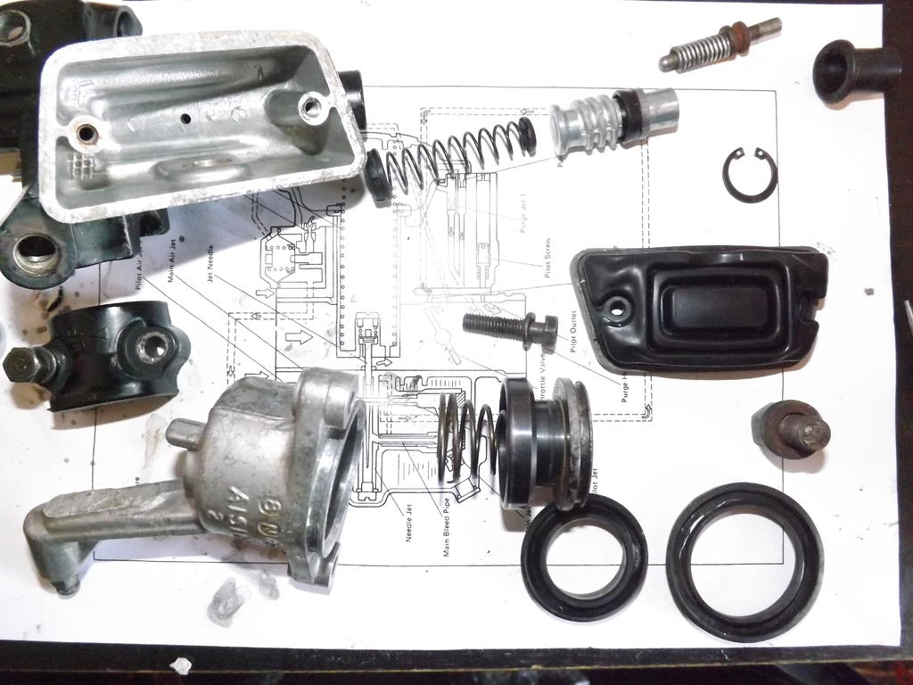

greg_in_london Posted September 20, 2018 Author #18 Posted September 20, 2018 The kits arrived yesterday and so I've rebuilt both slave and master cylinder. Work is starting again today, but hopefully I'll make time to get to the garage and put them back on. Then I'll be able to see if the carbs are continuing to improve or if I need to do a better job on them (the nozzle cleaners were also due yesterday or today, though I'll have to see if they go small enough).
