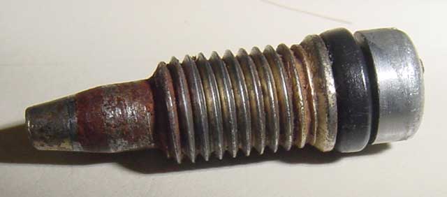

Flyinfool Posted April 6, 2017 Share #21 Posted April 6, 2017 Here is the screw out of a junk carb. I can see where if your screws look like this that the mechanic might want to replace them. This one has definite rust pitting on the taper part where it seals. BUT then If it were mine and I could not find replacements, I would probably just clean it up with some emery paper and stick it back in there. Link to comment Share on other sites More sharing options...
CaseyJ955 Posted April 6, 2017 Share #22 Posted April 6, 2017 I heard from Danny this morning and he has only the older style plugs too. Sorry no luck yet. If your carbs are off can the plugs be reinstalled and the rack given some fuel to check for seal? Link to comment Share on other sites More sharing options...
