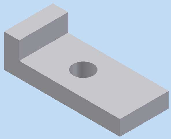

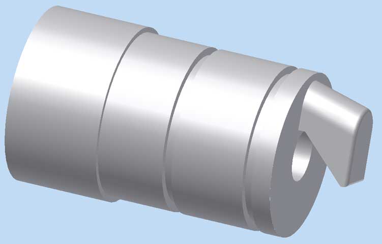

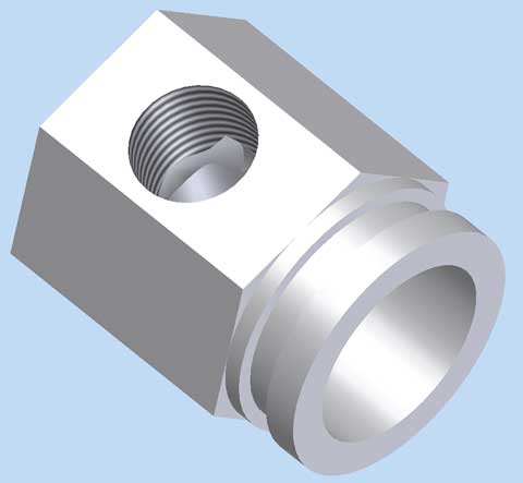

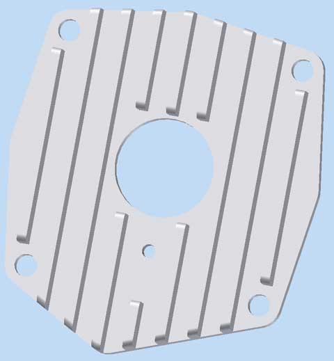

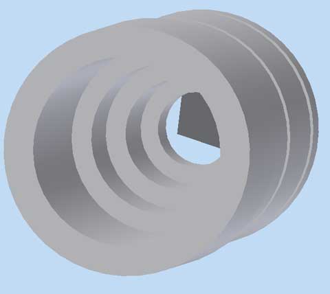

Flyinfool Posted April 5, 2017 Author Posted April 5, 2017 (edited) The engineer in me is leaking out, I lost count of how many times I have modified the design. There is always a better way to do it. It started out with the design being purely functional, but it was not nice to look at. I now have it looking much better but also a lot harder to make. For instance, the finned cover with the hole in the middle, It started life as just a flat piece of 1/8 thick aluminum plate. I added the fins just for the sake of appearance. this plate replaces the diaphragm cover on the carb so it is right out there and visible. I intend to make the cover black and then mill the edges of the fins back to bright, then clear coat to keep it looking good over time, should look much nicer that just a flat plate. Once I get the injectors, the injector will be sticking out through that hole in the plate, injectors are not very pretty so I may redesign the cover to hide more of it or see if I can come up with a cover for the injector, its wires and the gas line. Although I think I am going to use braided stainless gas lines just for the looks so I may not have to hide them. So far the design exists only in my computer and between my ears. My ears have been known to leak ideas out also....... As I mentioned earlier, this is a long term project, due to both financial and time reasons. Some of the parts I will have to buy expensive tooling to be able to make them. While the guy that designed the basic system has CNC to make the parts I am all manual machines so it will take a lot of time. My biggest concern is getting fuel mapping correct, to lean and the engine melts real quick. To save some cash I will be building the controller myself from a bag of resistors diodes capacitors ICs and other electrical goodies. The controller will be able to do both EFI and ignition. But this in its self will take a lot of time. As to if I will sell any or all of the parts, It will depend on just how much time it takes to make them, how much of a PITA it is to make them, and can I make them at a reasonable cost. I am expecting this conversion to cost me between $1500 and $2000 just in parts and materials alone, that includes nothing for all of the time it will take to make the parts that are custom to the application. Edited April 5, 2017 by Flyinfool

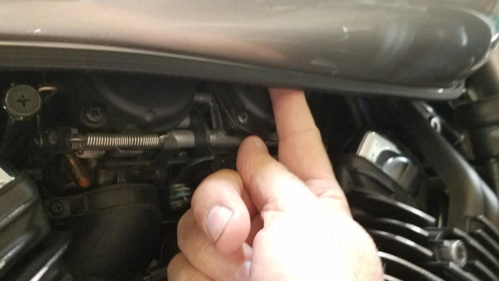

videoarizona Posted June 16, 2017 Posted June 16, 2017 (edited) Jeff, If you do want to offer this kit to the masses (us)...then you need to take into account the 2nd gen gas tank partially covers the diaphrams on the carbs....IE... need a right angle injector or plenum for each carb. Wonder if this might be a good time to mention two injectors on a throttle body deep in the "V" where the carbs now sit, feeding 2 carbs each, may be a lot easier...or whatever it takes for our V4's. But thinking vertical here... Here is a pic of my finger stuck in the small space between the carb cover and the bottom edge of the gas tank. Edited June 17, 2017 by videoarizona Correcting for the "duh".

Flyinfool Posted June 17, 2017 Author Posted June 17, 2017 Vid I never even thought of the 2nd gens, there is a lot of stuff to find places for, no one near me has a 2nd gen for me to look at. The farther that I get into this I am not so sure that it is suitable for the masses, at least not by me. There is a lot of electrical work to do and I know that scares a lot of people, there is welding to do, and a lot of mechanical assembly of all the bits and pieces. There is also a huge amount of time needed for me to make all of the custom parts since I do not have access to CNC. My basement is all manual machines. I started working on a BOM and parts list, from a distance it is looking like it will sneak up on the 2K mark, my cost, not including any tools I have to buy. I am not going the cheapest route for everything, cheap is sometimes more expensive in the long run. Once I buy the O2 sensor and the weld on bung I can start to play with ideas of where to put it. I was hoping to fit it on top of the collector. so it can read an average of all 4 cylinders, It has been recommended to me to just put it on any one down pipes close to the valve. I think that it would be fairly easy to hide on one of the front pipes way up high. And a LOT easier than dropping the collector. Did I ever mention that I hate carbs, even more than most of you hate snow.

Flyinfool Posted June 18, 2017 Author Posted June 18, 2017 Jeff, If you do want to offer this kit to the masses (us)...then you need to take into account the 2nd gen gas tank partially covers the diaphrams on the carbs....IE... need a right angle injector or plenum for each carb. Wonder if this might be a good time to mention two injectors on a throttle body deep in the "V" where the carbs now sit, feeding 2 carbs each, may be a lot easier...or whatever it takes for our V4's. But thinking vertical here... Here is a pic of my finger stuck in the small space between the carb cover and the bottom edge of the gas tank. http://www.venturerider.org/forum/attachment.php?attachmentid=109406 Ya know........................... Looking at this pic some more. The diaphragm covers are raised quite a bit above the surface that the screw heads bear on. I would have to look at a 2nd gen a lot closer but I think this might just fit inside of the tank. It will be real close.
