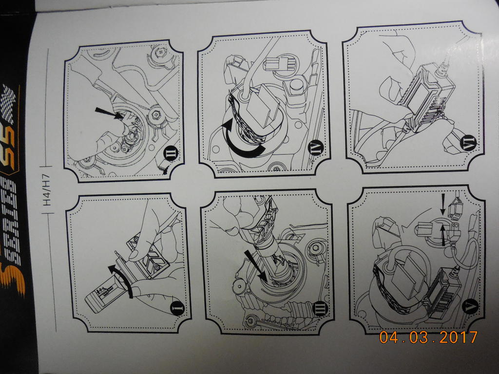

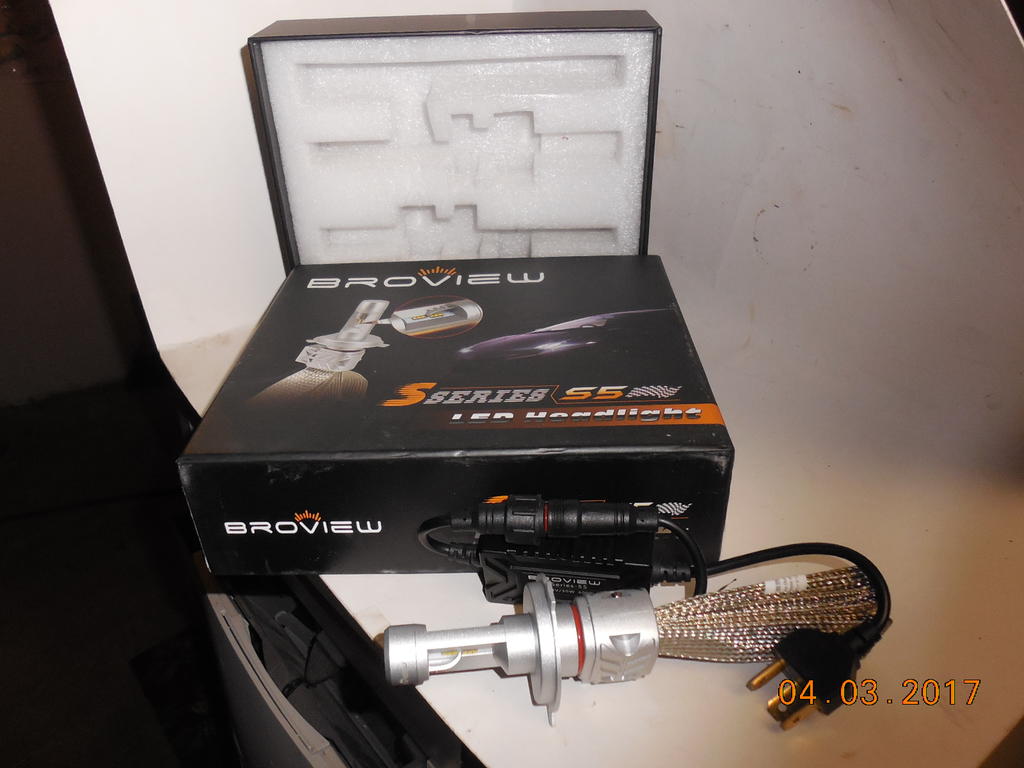

gggGary Posted March 23, 2017 #4 Posted March 23, 2017 Put a Broview S5 LED in last year ran it about 6K miles mostly daylight It uses braid for cooling instead of a fan, great light pattern with excellent proper cut off on low beam. Put two in my FJR because I like this one so much. Completely plug and play no wiring changes cuts or other connectors needed. Probably best to pull the outer fairing for the install you need to mount the power block. I have a series of pics with it installed.

1stbkadventure Posted April 3, 2017 #14 Posted April 3, 2017 You need the H4/9003, I put the Broview on my 2010 and can attest to it's brightness. Couldn't get it installed without taking the front fairing off though. Sent from my QMV7A using Tapatalk

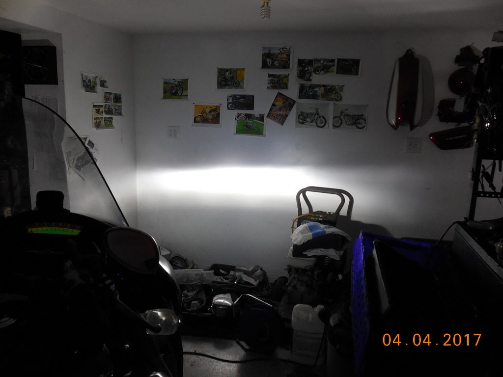

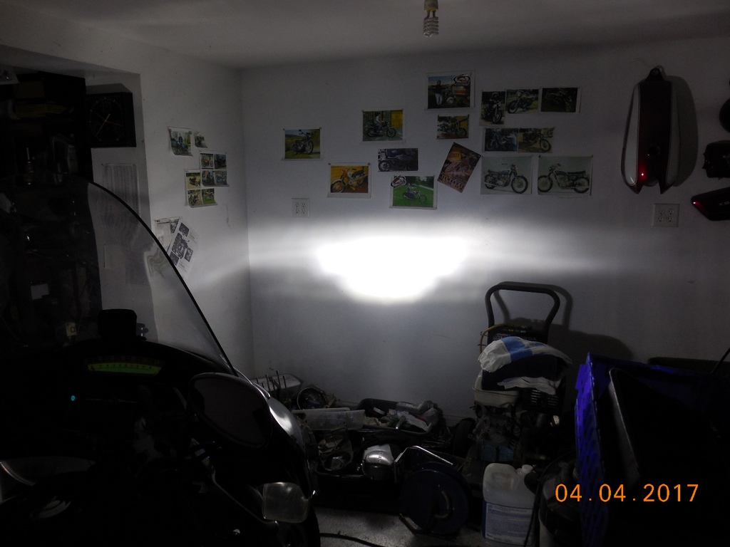

Spyder Posted April 4, 2017 #16 Posted April 4, 2017 I've been following this thread with interest. I tried this bulb https://www.amazon.com/gp/product/B00WVJR0D8/ref=oh_aui_detailpage_o04_s00?ie=UTF8&psc=1 and found it to be much brighter than any other upgrades I've tried. The problem was that it did not have a good cut off line. I made sure to readjust it when I installed it but couldn't find a good compromise that didn't annoy my buddies when I was behind them. Since Gary said the one he used has the proper cut off I'm going to order as soon as I find them for a decent price. I hate to admit how many different bulbs I've tried.
gggGary Posted April 4, 2017 #17 Posted April 4, 2017 I've been following this thread with interest. I tried this bulb https://www.amazon.com/gp/product/B00WVJR0D8/ref=oh_aui_detailpage_o04_s00?ie=UTF8&psc=1 and found it to be much brighter than any other upgrades I've tried. The problem was that it did not have a good cut off line. I made sure to readjust it when I installed it but couldn't find a good compromise that didn't annoy my buddies when I was behind them. Since Gary said the one he used has the proper cut off I'm going to order as soon as I find them for a decent price. I hate to admit how many different bulbs I've tried. Yes a proper cut off is super important. LOTS of LEDs out there, don't buy unless they show installed light pattern photos. Long night trip monday, and the number of cars coming at me with crap aftermarket LED or HID headlights seems to be on the increase. Get a lot of glare, flash them and they demonstrate that their high beam is even WORSE! You can get an idea by closely looking at the bulb, the LED needs to have a shape profile that closely mimics the Halogen bulb filament that the reflector is designed for. There are a lot of LEDs that are "scatterguns", spraying too bright light everywhere. IMHO I want the guy coming the other way to be able to see the road also!!!!! My intense interest in LEDs started at the end of a road trip two years ago, I made a 200 miles "run for home" on a misty night on the BMW K1200LT. Even with "super bright" halogen it was a miserable, hope no deer are standing in the road, night. I don't ride at night a lot, but when I do............... I'll try going out and shooting a few night "road scenes" with this bulb. Stay thirsty my friends.

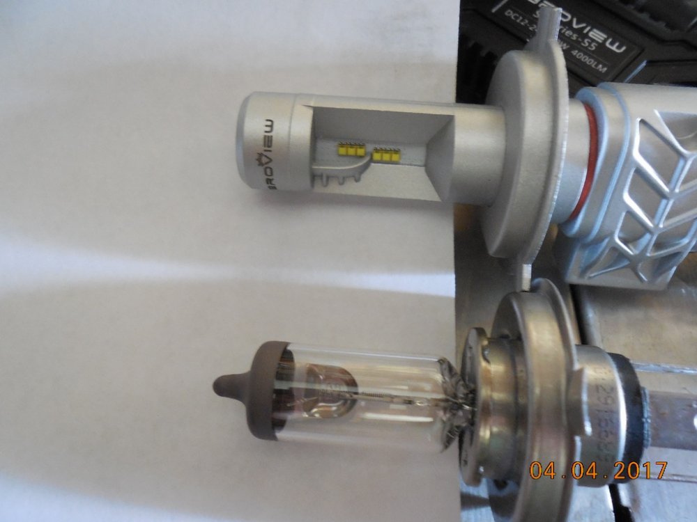

gggGary Posted April 4, 2017 #21 Posted April 4, 2017 Looking at the draw of the various bulbs above, I think the ammeter confirms what I saw when I tried that "100/80 watt" bulb in the RSV, it's more like a 65/60 bulb, mostly marketing, not fact in the claimed wattage.
gggGary Posted April 4, 2017 #22 Posted April 4, 2017 The ebay ad claims 60W but I believe that is for a par in a car. so it would be 30W each. they do not say what the wattage is for Hi or Low beam on the H4. All of the dual beam LEDs that I have looked at are double the wattage for HI beam. In the specs they like to list the LO beam wattage and the HI beam light output. I could not find a proper description for these specific bulbs to know for sure what they are..... This bulb is like a halogen in that it switches between two elements, doesn't just add more elements for high beam so the difference from high to low is not great. More testing needed for sure. I know I am starting to sound like a broview commercial but beyond buying a few I have no connection with them. Looking around I see several other LEDs now available that appear to be using similar designs to get proper light output. I have set of bulbs to try in my van also.

gggGary Posted April 4, 2017 #24 Posted April 4, 2017 Hmmm... conflicting information on the eBay listing. http://www.ebay.com/itm/132064359512?var=431419956768 The "Item Description" section says: dc 12v-24v 30w a piece 6000k-6500k output 8000 LM total 4000 LM low + 4000 LM high Where as further down in the body of the listing is says "Motorcycle:" 5500k - 6500k 20w output 2200 LM Yeah; I bought a "motorcycle single headlight" off that ad, turns out it was a different "fan cooled" headlight. I returned it for a full refund and got a pair of the "car" headlights. I think they have dropped the "single H4 motorcycle bulb" from the choices and that blurb just didn't get removed. PS I don't think you are going to get a fan cooled bulb in the RSV, not enough room.
BratmanXj Posted April 4, 2017 #25 Posted April 4, 2017 Yeah; I bought a "motorcycle single headlight" off that ad, turns out it was a different "fan cooled" headlight. I returned it for a full refund and got a pair of the "car" headlights. I think they have dropped the "single H4 motorcycle bulb" from the choices and that blurb just didn't get removed. So $52 gets me 2 H4 LED lights... even better deal!
