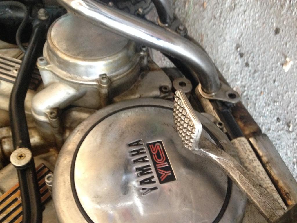

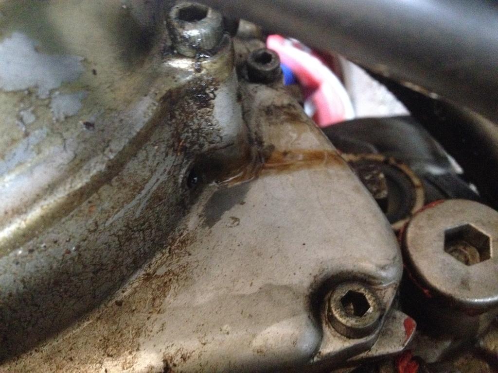

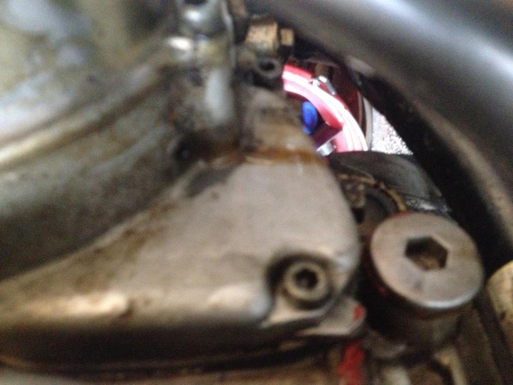

superdrizzle Posted March 14, 2017 #1 Posted March 14, 2017 Hello Ive been putting some miles on my old 83 Venture, and there has been a lot of oil leaking out the last year, it seems to be coming from the water pump overflow valve, if thats even a thing. Im not sure would love any help in stopping the bleeding!
MiCarl Posted March 15, 2017 #2 Posted March 15, 2017 There are two seals back there. One on the pump side to keep coolant in the pump and one on the engine side to keep oil in the engine. That drain is between them so you find out you have a bad seal before filling the crankcase with coolant. You need to replace the seal.
Condor Posted March 15, 2017 #3 Posted March 15, 2017 From the pics to me it looks like the bottom hex is where the oil is coming from, and maybe it needs nothing more than a crush washer to stem the leak. A lot like the bottom hex on the middle gear cover.....

Flyinfool Posted March 16, 2017 #5 Posted March 16, 2017 It sure looks like the oil is actually coming from above somewhere that is out of the picture frame. The oil is running all the way down the side of the engine case and the water pump housing. It might just be something as simple as you over filled the oil in the crankcase. Over filled oil will blow up into the air cleaner box and then drip back down onto the engine. The oil level in the sight glass should not be more that the bottom fill mark with the bike upright on a level surface. Clean everything up and then keep a close eye on it to see where the oil leak is starting from.
gaj1917 Posted March 17, 2017 #6 Posted March 17, 2017 (edited) Finding the source of an oil leak in and around a convoluted engine is a challenge. I've found that engine oil dye helps, a lot. The product I've used is Tracer Products TP34000601 UV Fluorescent Leak Detection Dye. Add that to your engine crankcase and then run the engine. Then shine a UV flashlight anywhere oil appears. It will appear a greenish colour. You'll then be able to trace the oil stream back to its origin. Yellow lens safety glasses help. The dye and flashlight are available on Amazon, and at various auto supply doors I would think. Edited March 17, 2017 by gaj1917
