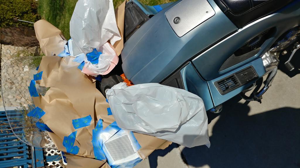

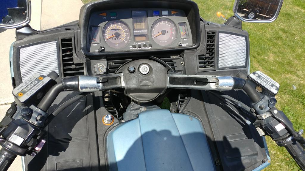

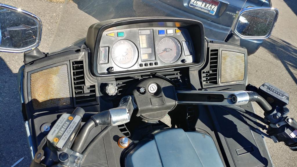

happypunch Posted April 4, 2017 Author Posted April 4, 2017 I have been sick and not wanting to do much but got real tired of the gross looking speaker covers. It probably would have been easy to remove them but I just taped up the bike and sprayed them with primer and silver paint. I wanted gold or glittery purple, you know... and obnoxious color! But my wife talked sense into me. I didnt want black because I would have to paint everything to match the shade. Here are some before and after pics. It made a big difference, the old covers were just so ugly!
CaseyJ955 Posted April 4, 2017 Posted April 4, 2017 Thats a huge improvement. Honestly the metal flake fucia or purple would have been much better, this is why we should never listen to anyone that tries to talk sense into us, now that its boring silver where will the Hello Kitty stickers go? Ill bet she didnt think of that!
happypunch Posted April 5, 2017 Author Posted April 5, 2017 I was thinking that something gaudy would distract from the steaming pile the rest of the bike is. Don't get me wrong, I love it, but it's going to take a lot of work to make it pretty. Right now I'm in the "polishing a turd" phase and hope to soon get it up to "tired and seen some miles" one day it might get all the way up to "decent." The more I look, the more broken tabs and missing fasteners I find... Still not sure how it stays together on the freeway, someone must have used good bubble gum and bailing wire. Looking at the mirror and windshield, can someone tell me which part is supposed to be on top? Can't tell if the black or the blue goes on top since it was broken and glued together and it looks like it might be incorrect.
