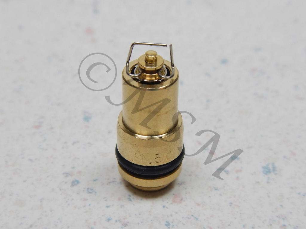

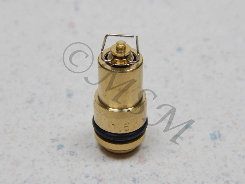

CaseyJ955 Posted March 13, 2017 Posted March 13, 2017 Genuine Yamaha is obviously excellent but spendy. Of the aftermarket I have read that the Japanese made K&L is the only route to go, anything else is a crap shoot and probably made in China. I know the guys on the Vmax side have had good luck with K&L but not others. When I did my jet block plugs I had to soak them for 2 days before they started to soften up and take their normal shape but they were rock hard and distorted when I began. After a 2 day soak I could feel they were softer and had taken their normal shape, had to wiggle them back in and they were quite snug. You did use 100% wintergreen oil with the alcohol? I believe it was cimmer (I think) that iterated how important the jet block plugs are in the other thread. Since the bike is together may I suggest a wet float level test. If the fuel level is maintaining it's proper level then I think we can rule out floats/needles/seats and move on to other possibilities. Hoping we can narrow the problem down by ruling things out. I'll attach a page on the wet float level check. We'll get to the bottom of this. I assume the air box was installed during the tests, these carbs wont behave well at all w/o the air box installed. I know there are some guys here that have been doing this longer than I have so there is a better way please step in and correct me.Wet Float Measurement (1).pdf

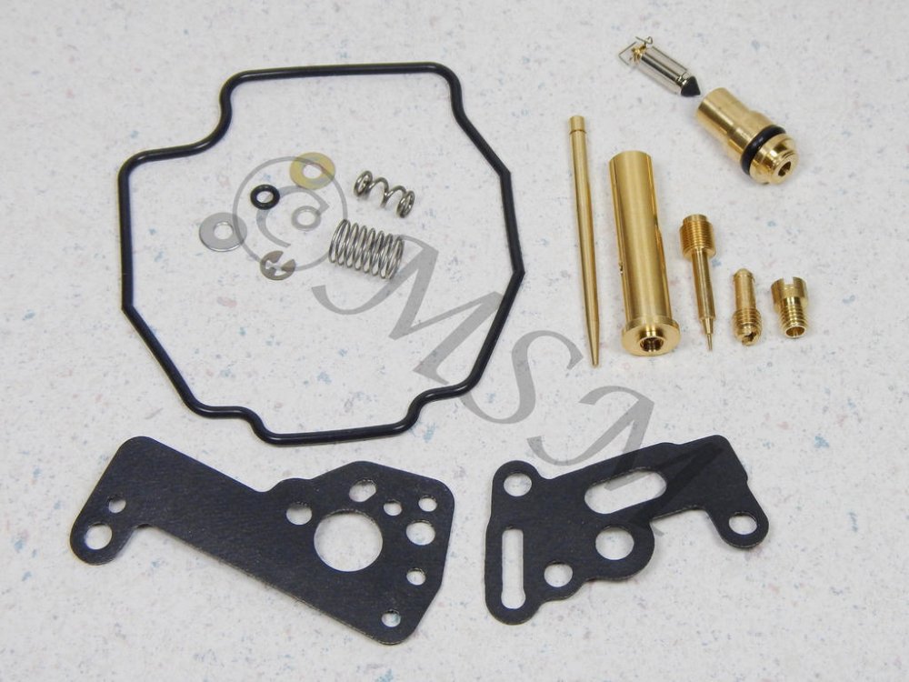

cimmer Posted March 13, 2017 Posted March 13, 2017 One thing comes to mind and just want to check with you... The needle valve for the fuel inlet has a wire attach to it that has a cut in the wire. Are you fitting the float tab into the cut of the wire. That is how it is suppose to go. I have included a photo of the Keyster Carb kit, K-1359YK. It is available on ebay or I ordered mine from http://www.siriusconinc.com. They also have a set of rubber plugs for the bottoms of the jet block for under $20 for all 8. I did order these also but I have tried them to see how they fit but I did just disassemble a carb tonight and can try them tomorrow for you and let you know. It is strange that the carbs are not venting out the tubes on top of the float bowl covers. I take it you can blow air thru those tubes as well. Sorry for some of the basic questions but just mentioning everything. Have you check to see if maybe you have a bad float. Setting the float height when dry is on thing but what about when they are wet. Before you disassemble the carbs again, do the wet float check on them with some clear tubing. The procedure is listed in the service manual and might be worth the time to do it. Least it let you know if the floats are good or if maybe one is sinking a bit and letting too much gas in. Let us know what you find and good luck. Rick F.
BlueSky Posted March 13, 2017 Posted March 13, 2017 I used K&L needles and seats in my Kawasaki carbs and they did great. Yep, if a float has a hole in it or is saturated depending on the material and sinking, that would explain the gas coming in.

cimmer Posted March 15, 2017 Posted March 15, 2017 The issue with just picking needles is there need to be the correct size. Using the Yamaha parts listing for the different bikes doesnt tell us if they will actually fit. If we had the Mikuni part numbers from them might help us get something close that might work. I have the Keyster K-1359YK carb kit to use on my 4 carbs next month, has to warm up enough in the garage to work. It is made in Japan and does include a replacement needle, labeled as a Y-338, but I have no idea if it work with the Venture as I am guess it is more for the Vmax. I been searching the net for some replacement but not having much luck and am considering a set of Yamaha stock Vmax needles as they still sell them. They are close and might just work and if not, they are very easily changed out. Here are the measurement I have came up with so far from different sources online. Part no. Mark Slots Length Dist.1 Dia 1 Dia2 K1 K2 K3 K4 K5 K6 A1 A2 A3 A4 A5 A6 J8-5EZ43 5EZ43 1 50.600 3.000 3.000 0.000 16.400 39.400 0.000 0.000 0.000 0.000 1.15 10.00 0.00 0.00 0.00 0.00 Vmax 1200 J8-5DZ03 5DZ3 1 50.500 3.000 3.000 0.000 15.700 36.700 0.000 0.000 0.000 0.000 1.00 8.00 0.00 0.00 0.00 0.00 Venture 1300 J8-5GLZ37 5GLZ37 1 50.500 3.000 3.000 0.000 16.300 20.300 34.300 0.000 0.000 0.000 1.45 3.00 7.00 0.00 0.00 0.00 Venture 1200 Anyway if we can find out the part number of the needles in question, we might find something close to use. Rick F.
