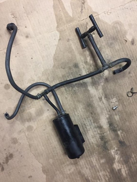

Javenmcd Posted March 9, 2017 Author Posted March 9, 2017 that image is definitely not the fuel pump...my pump is factory and near the left rear footrest. No one has been able to tell me exactly what that component is but others with an 86 have the same setup....as for the canister, I pulled the line from the carb and put a bit of pressurized air down the line into the canister and it spewed fuel out of the nipple in the bottom so I know it's not full of fuel...just had some in it. Does that make sense?

cowpuc Posted March 10, 2017 Posted March 10, 2017 Image 0690, right side pic......the brass thing looks like a fuel pump to me. One side is connected to something and the other spicket is wide open. Nothing connected to it. I say it "looks" like a fuel pump because our pumps are brass on the middle with a black end where the two hoses connect...one in from filter/tank the other out to the main fuel line that goes to all four carbs. There may even be a vent line to the side...don't remember. The top has a black plastic case with wires coming out of it. That is where the fuel pump points are located. So why is one side of the fuel pump (if it is that) not connected? And...why is the fuel pump there? isn't a first gen pump located down on the lower left part of the frame by the passenger foot rest??? An extra pump? Relocated? Am I nuts? (that is debateable but another story!!) cowpuc you see what I see? Had to step out for a couple days here chasing more Cancer related stuff - came home and got the message on this one - thanks for paging me VZ... Getting caught back up on where we were helping Jav here - looked at those pics (never did see nothing like that before on no 1st Gen of mine ) but gotta tell ya David - I thought EXACTLY the same thing you did about that looking like a fuel pump in there - sure looks familiar dont it! Why would Mom Yam hang an extra pump way up there WOWZY is that different.. Glad to see you guys are little by little getting it ironed out. Having never owned or worked on a 1st Gen steed with a California brand on it,, I can only think of what I do know about California epa reasoning for what all that stuff is about.. Our bikes over flow the carbs onto the roadway under the bike (to atmosphere) - I highly doubt that California allows for this type of plumbing. Ours do crank vent back up to the airbox and many of us have discovered that adding to much oil on an oil change that when the crankcase gets hot it will aspirate oil into the airbox and then leak that excess oil out onto the engine - sound familiar? Thinking out loud here,, brains a little tired but trying.. I wonder if Mom Yam eliminated the overflow tubes for the carb bowls that run down the backbone of the bike and normally exit in front of the rear shock.. If they eliminated that circuitry and ran the over flows into some sort of vaporizing canister(s) (possibly what that thing that looks like a highly technical black cup holder with the hoses connected to it could be:confused24:). Wonder if that is what the nipple on the bottom of the carb does = replacing the overflow lines on our bikes.. Also wondering if that whole system but then be routed in junction with the crankcase/top end venting system back up to the airbox for complete the "NO VENTING TO ATMOSPHERE" rule that California might be requiring.. Jav - if what I am thinking has any accuracy at all,, I wonder if its possible that the canister(s) and vent system got filled with raw fuel back when she hydrolocked.. If so,, and being close to the engine like it is - I wonder if its possible that raw fuel is getting warmed up and forced back into the carbs... Not knowing exactly how that the lines for that system are routed or possible linked to the fuel system - also wondering if there may be a diaphram that is cracked somewhere that is allowing raw fuel to be pumped thru the venting system instead of thru the normal paths in the carbs.. I think if it were mine I would disconnect that system from the carbs so I knew there was no way I was getting fuel back into them from that possible source. I would then remove the air filter so I could see into the carbs, turn the key on - toggle the kill switch so the fuel pump clicks and she's pumping - keep doing it till it either stops clicking - indicating the carbs are full all the while watching the little main jet air vents right at the top of the throats of the carbs for overflow and also that nipple on the carb that connects to the cannister.. If it primes up with no sign of float valve or float issues - I'd fire that puppy up, keep a close eye on it and see if she holds.. In the end,, I would definitely be in the process of eliminating all that California stuff and getting her back to normal.. If those carbs are still overflowing and,if its plumbed like I think it may be (no over flow tubes running down to the front of the rear shock - all carbs over flows being tied together and exiting out that single nipple in the picture?) - I wonder if its possible that one carb has a hung up float or improperly set float height and that is causing all the carbs to "overflow" because they are all tied together on yours.. The 1st Gens I am familiar with have individual overflow tubes coming from the top of each carb - a hose connects to each one of them - then the group of four hoses pass under the airbox to the rear - down the frame of the bike being held in place by passage wire - those hoses will appear in front of your center stand/mono shock if you have them.. If what I am thinking is true and your bike does not have these tubes - it may be difficult to figure out what carb is problematic...

Javenmcd Posted March 11, 2017 Author Posted March 11, 2017 UPDATE: I pulled off/disconnected all the CA emissions crap (charcoal canister removed, disconnected the canister line to the carb and left it venting to atmosphere, fuel tank vent valve removed, disconnected the vent lines that ran to the air vent control valve) and ran temporary clear carb vent lines. Took it for a short ride and warmed it up several times and it didn't flood itself!!!! I did notice that the temporary vent lines I'd run were a little long so they curled back up and collected some fuel in them. Do I still have a float level issue? I set them (inverted) at 1.125" last time I had them off. I did install aftermarket K&L needles and seats so I don't know if that will affect my levels or not.....but hey, I'm making progress.
