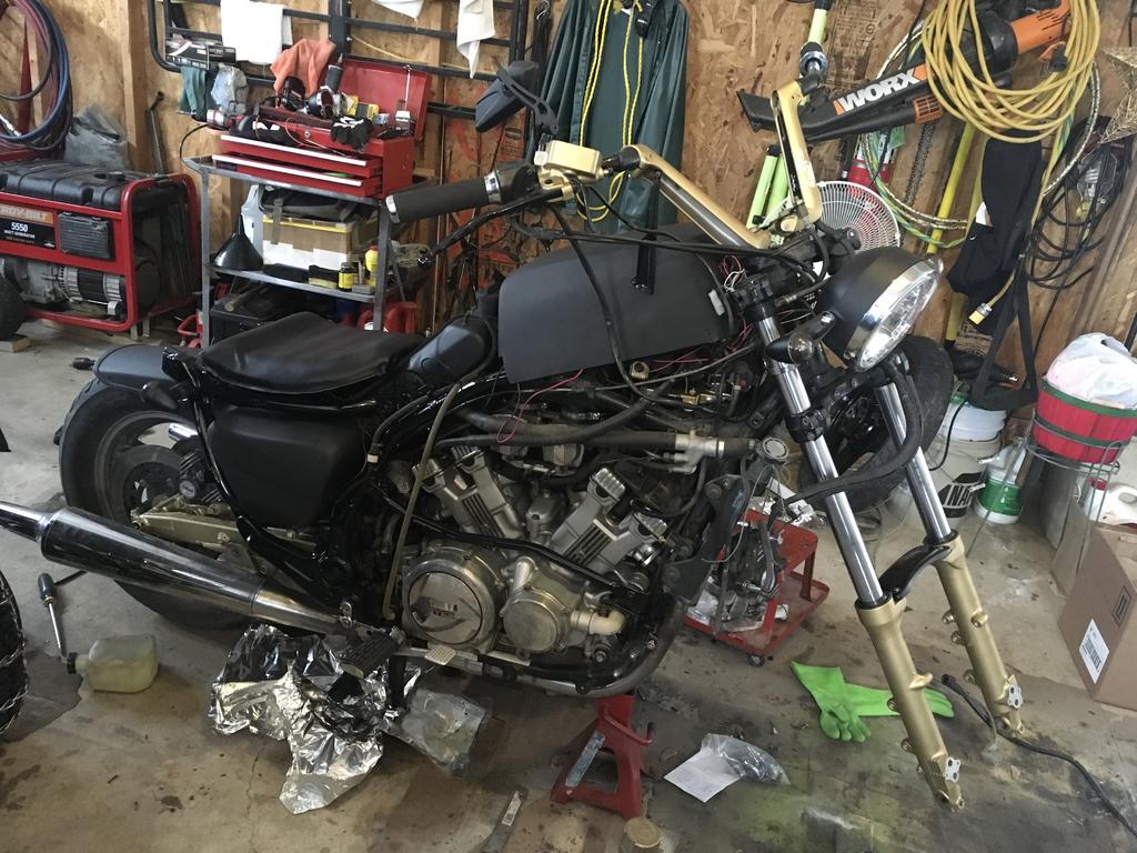

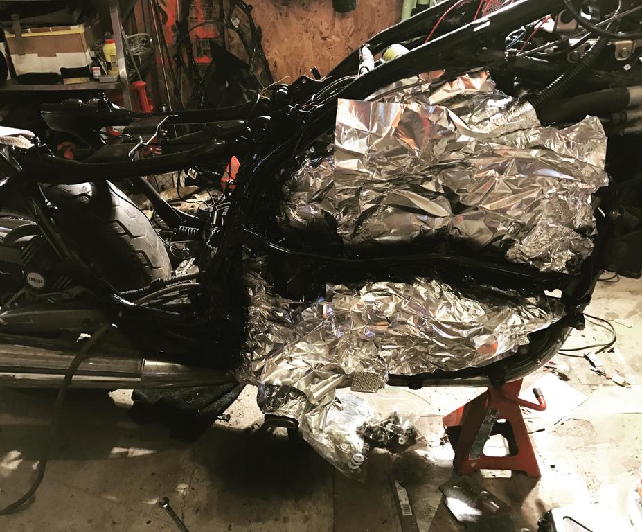

snyper316 Posted March 13, 2017 Share #60 Posted March 13, 2017 Interesting use of Aluminum foil... Link to comment Share on other sites More sharing options...
BlueSky Posted March 13, 2017 Share #61 Posted March 13, 2017 For Yamaha to get around it is easy they just designed the whole system to work together, they are not using an aftermarket off the shelf tach. Sometimes on a tach you can lie to it about what it is connected to. I once had a car with wasted spark ignition on a V8, I told the tach it was connected to a 4 cyl to get it to read correctly. If your tach has a selection for 2 cycle engine, use that it it will then read correct. Just have to play with what they give you till you find what works out. I often lie to various pieces of electronics to get the end result that I am after. Kind of like lying to your girl friends to get what you wanted back in the day! Link to comment Share on other sites More sharing options...
Bassett Posted March 14, 2017 Author Share #62 Posted March 14, 2017 Interesting use of Aluminum foil... Lol. I love aluminum foil for painting. It is shape-able for around hard to do places and costs less than tape!! Link to comment Share on other sites More sharing options...
snyper316 Posted March 14, 2017 Share #63 Posted March 14, 2017 Hey whatever works, kinda like duct tape.... Living life one curve after the other. Vroom scooting, thru the countryside. Link to comment Share on other sites More sharing options...

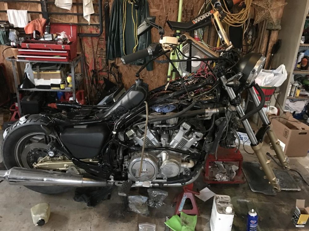

Bassett Posted March 14, 2017 Author Share #64 Posted March 14, 2017 Some more pictures. Link to comment Share on other sites More sharing options...

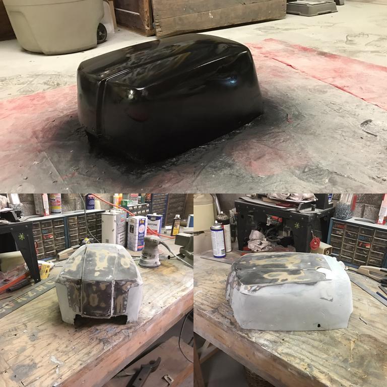

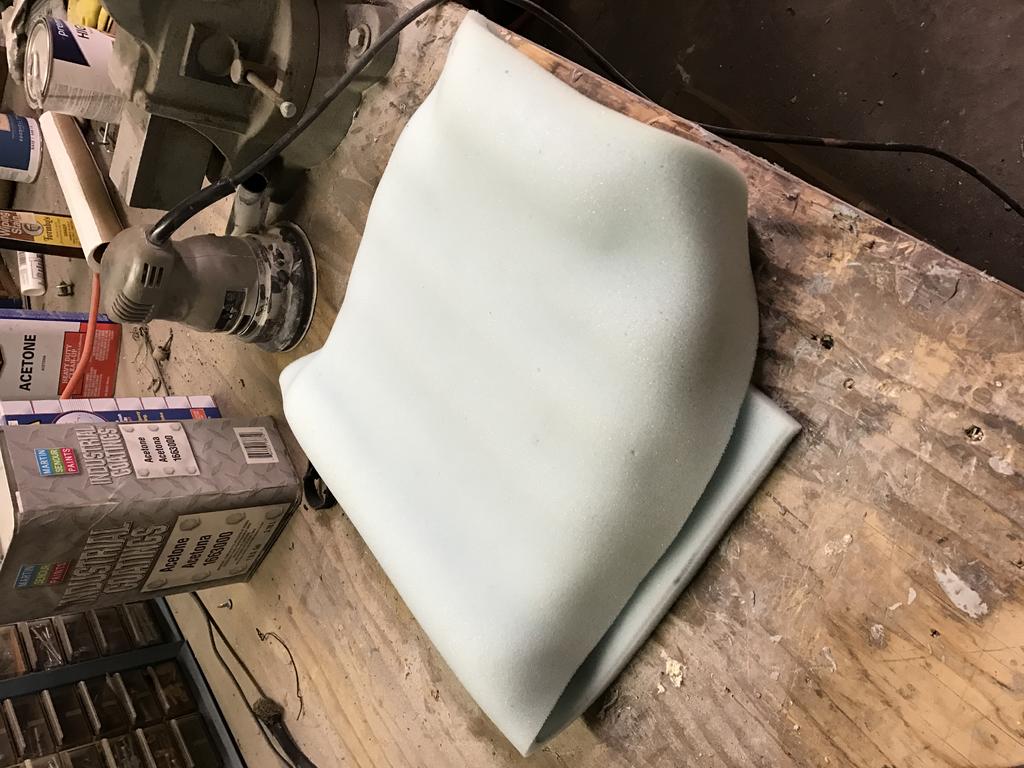

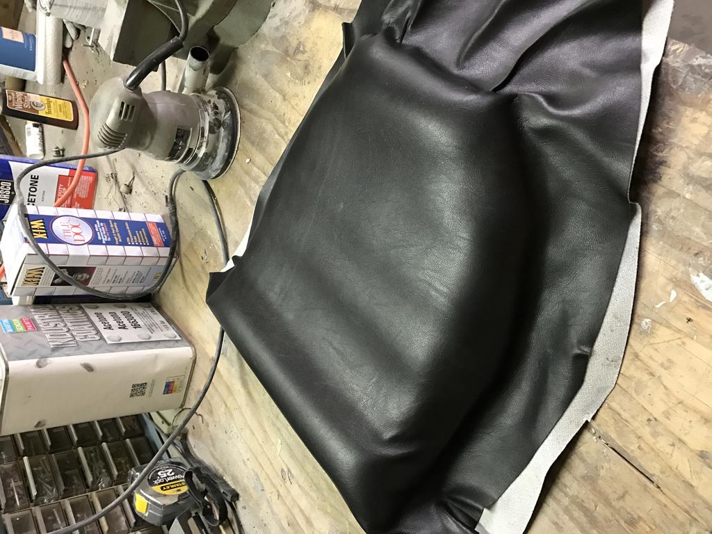

Bassett Posted March 14, 2017 Author Share #69 Posted March 14, 2017 Seat rear fender cap Link to comment Share on other sites More sharing options...

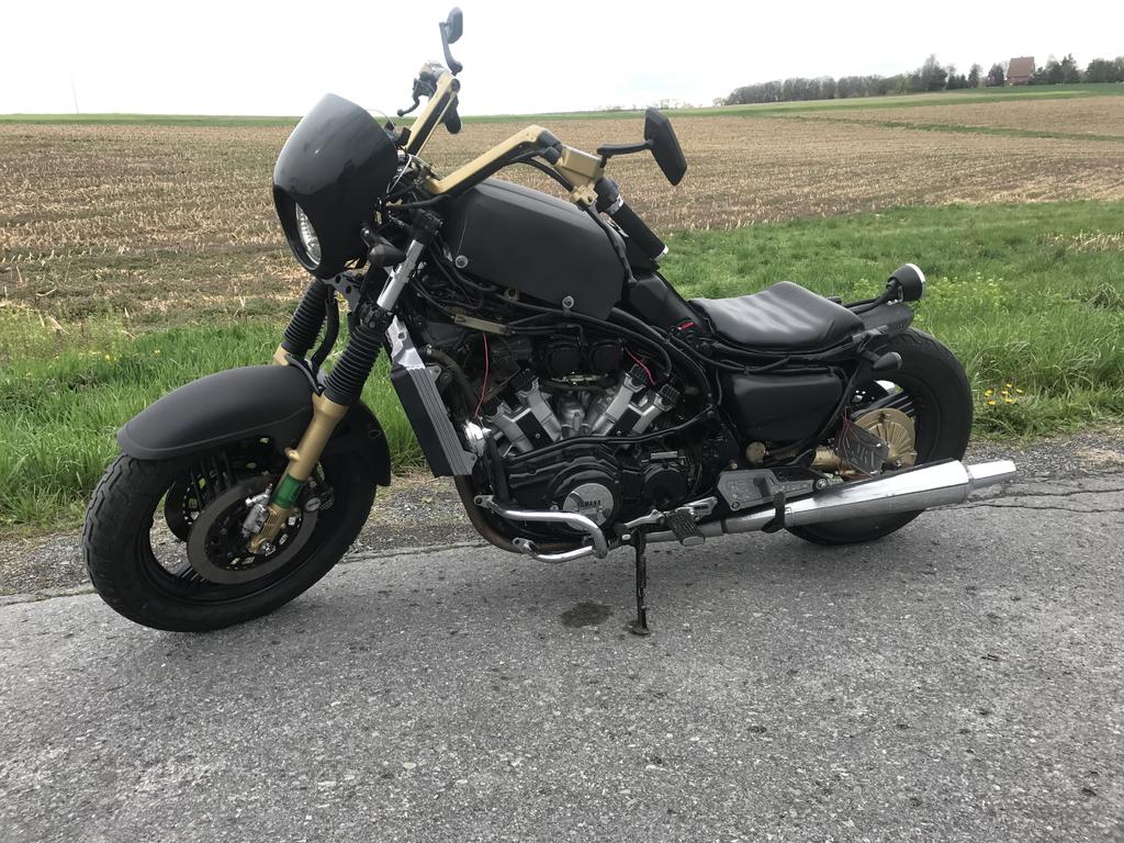

Bassett Posted April 24, 2017 Author Share #71 Posted April 24, 2017 Complete Link to comment Share on other sites More sharing options...
Condor Posted April 24, 2017 Share #72 Posted April 24, 2017 COOL..... Link to comment Share on other sites More sharing options...
bongobobny Posted April 24, 2017 Share #73 Posted April 24, 2017 Not too shabby Bassett!! Bring it up to the WNY Rally in August!! Link to comment Share on other sites More sharing options...
Flyinfool Posted April 24, 2017 Share #74 Posted April 24, 2017 Awesome! I cant wait to meet it in person somewhere. Link to comment Share on other sites More sharing options...
zagger Posted April 24, 2017 Share #75 Posted April 24, 2017 Looks good! What is under the cover that looks like a standard gas tank? zag Link to comment Share on other sites More sharing options...
