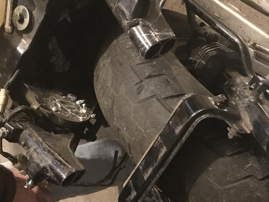

Bassett Posted February 4, 2017 Share #1 Posted February 4, 2017 Hey guys and gals. Has anyone bobbed a venture and had good success with it? How'd they drop the back with the tank and shaft? Venture handlebars are weird too! Any way to modify them? Link to comment Share on other sites More sharing options...
cowpuc Posted February 4, 2017 Share #2 Posted February 4, 2017 There's a varmint in our Club named @zagger who did an AWESOME job of Chopping one, Zag's bike has a custom front end and some top notch - one off - very creative other features too.. I have always been a long bike Chopper fanatic myself, built a number of them (never a Venture though - always wanted to but never took the time) from Harley's and 750 Honda's - just never got into the bobber end.. Thinking you may find dropping the back end fairly easy by building a set of custom mono linkages - still be able to have rear suspention.. Of course, hard tailing is always an option.. Tank wise, with the bike already wired for a fuel pump - you could literally move the tank anywhere you wanted.. Pull the sub frame, remove the stock tank - open that area up and put a drop seat on springs down there in the hollow. As far as bars go - you can put "clip ons" on anything with forks or,,, a simply swap out to conventional bar mounts looks way doable to me.. Personally though - I have really come to like the custom look and design of the stock Venture bars (1st Gen).. Cleaned up and simplified a little so the pivot joints and major engineering designs of that piece work can easily been seen would look AWESOME on a Bobber IMHO... Ditch the fake cover over the battery, move the battery down below, disgard the airbox and either run pods or stacks. Built a set of drag pipes for one of my Ventures one time. made the pipes out of thin wall chain link fence pipe. took some tin - drew out a set of "fish tails" on it - cut it out and welded the fins together - banged the ends of the pipes in a little and welded on the fins - "tuned" the pipes by bending the fins together to get a little back pressure. Was amazed at how well they tuned out in the end = bike sounded AWESOME!! Even the Sturgis Harley riders were jealous of that beat up ol 200k mile Venture when I pinned it and they could hear it over their Big Twins!!! NOTHING sounds sweeter than a small block v-4 revving out when it is opened up so it can breath!!! Loose the front fender and you can get a LOT bigger tire on there.. Not gonna anything on the back end though by loosing the rear fender - swing arm space is limiting factor BUT - you will end up with pretty much a matching set of larger (150's maybe) tires by loosing the front tire. Ditching the fairing is gonna be somewhat challenging cause of all the lectrics happening under there.. aint no where near enough room in a headlight bucket to hide the stuff.. Also gonna be challenging swapping out the dash board cause a lot happening there too.. Thinking if it were me, I would build a custom electrical box with all the goodies in it - maybe mount it forward on the frame like to look like an old oil cooler like we had on our shovels.. Could also do something similar for a fuel tank - those tool boxes on the WLA's could be redesigned - enlarged and end up with a fuel bag that would look like a tool kit from the day.... I gotta a massive collection of Easy Rider mags from days gone by - lots of custom scoots in em.. I get a chance I will thumb thru em and see if anyone has done a bob similar to what your talking.. Most of that stuff is Harley based but hey,, ya never know! If you do decide to go forward with a bobbed Venture, you may wanna consider joining us as a club member here!! Lots and lots of really sharp people with many years of experience on the Yam V-4's.. Probably find this bunch of misfits an invaluable wealth of info for what your about to do!! Either way though, glad you found us, good job of for a first post and WELCOME to VR!! Puc Link to comment Share on other sites More sharing options...

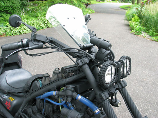

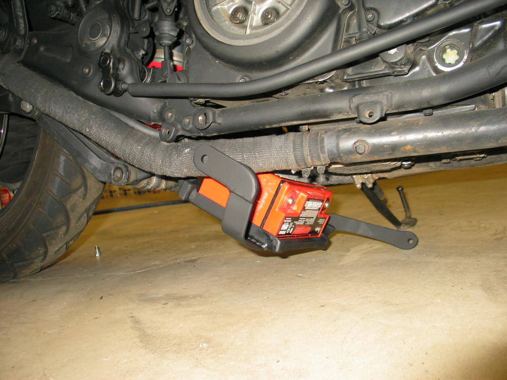

zagger Posted February 5, 2017 Share #10 Posted February 5, 2017 (edited) Hey guys and gals. Has anyone bobbed a venture and had good success with it? How'd they drop the back with the tank and shaft? Venture handlebars are weird too! Any way to modify them? Hi - here are a couple of pictures of my 83. More of a chopper than a bobber. Fuel tank is stock (under the seat). Lower section of the handlebars are basically stock but the ends are custom. Battery is mounted horizontally under the engine. Added Vboost from a Vmax (doubles air and gas by connecting each intake to two carbs) but it is operated with a bicycle shift lever mounted on the end of the left handlebar. Bike has very low CG and good handling. The leading link suspension for the front wheel reduces the trail dimension down to 3", about what a sportbike might have. I first tried extended hydraulic forks but the handling was very slow (long trail dimension) so I built a new front end with a custom leading link. The clear cover over the clutch lets you see the parts whizzing around inside. I had so many people ask if I had used Harley components, I welded up the mounting of the headlights using an old primary chain from a Harley - but it turned out that the joke was on me since few Harley riders seem to know that their engine uses a primary chain to connect to the transmission! zag Edited February 5, 2017 by zagger Link to comment Share on other sites More sharing options...
Bassett Posted February 5, 2017 Author Share #11 Posted February 5, 2017 Hi - here are a couple of pictures of my 83. More of a chopper than a bobber. Fuel tank is stock (under the seat). Lower section of the handlebars are basically stock but the ends are custom. Battery is mounted horizontally under the engine. Added Vboost from a Vmax (doubles air and gas by connecting each intake to two carbs) but it is operated with a bicycle shift lever mounted on the end of the left handlebar. Bike has very low CG and good handling. The leading link suspension for the front wheel reduces the trail dimension down to 3", about what a sportbike might have. I first tried extended hydraulic forks but the handling was very slow (long trail dimension) so I built a new front end with a custom leading link. The clear cover over the clutch lets you see the parts whizzing around inside. I had so many people ask if I had used Harley components, I welded up the mounting of the headlights using an old primary chain from a Harley - but it turned out that the joke was on me since few Harley riders seem to know that their engine uses a primary chain to connect to the transmission! http://www.venturerider.org/forum/attachment.php?attachmentid=108264 http://www.venturerider.org/forum/attachment.php?attachmentid=108265 zag Awesome job!!! Electrically speaking, what do you have hooked up? Link to comment Share on other sites More sharing options...

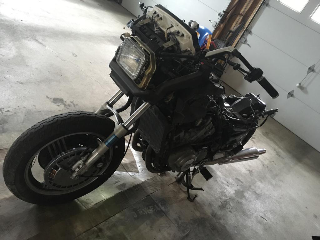

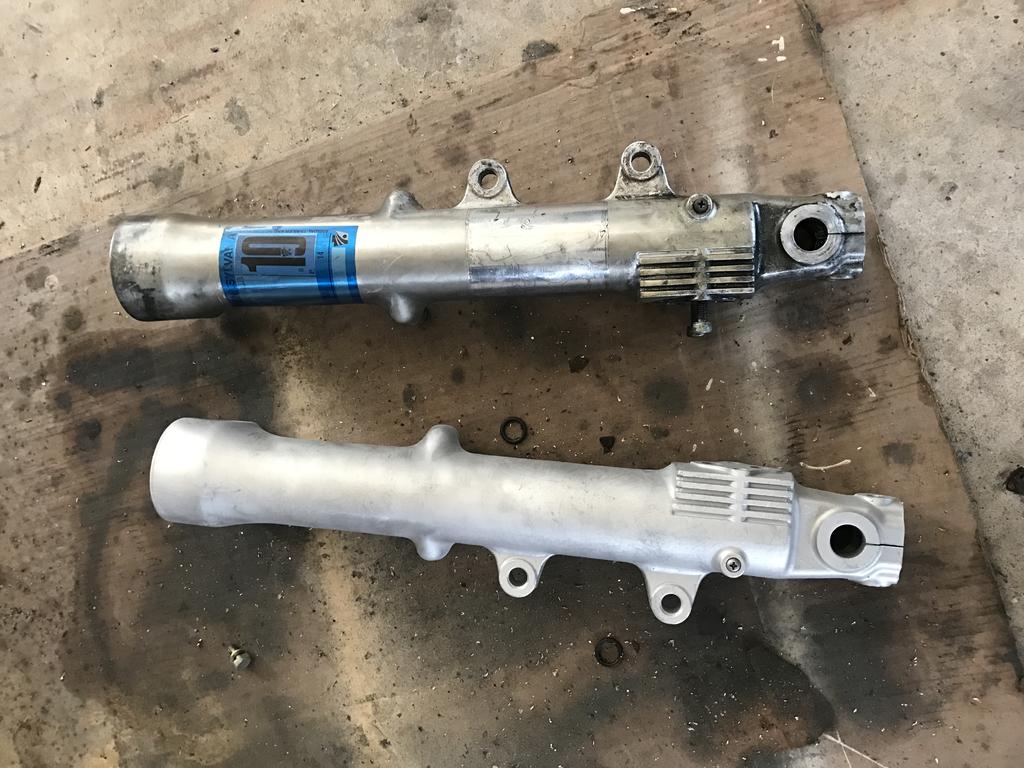

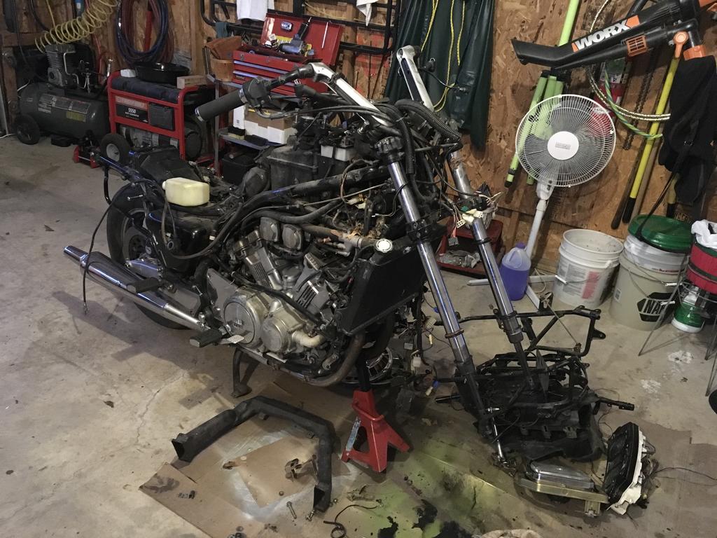

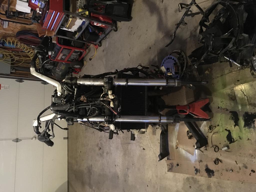

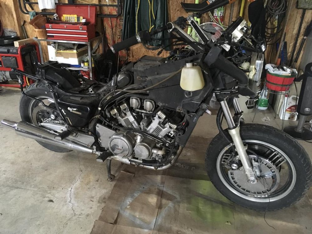

Bassett Posted February 5, 2017 Author Share #18 Posted February 5, 2017 More progress... I stripped the bottom bolt head on the right fork so I will be needing a new one. Debating on keeping chrome rotor covers... thoughts? Powdercoating lower tubes this week. Any ideas where or how to stuff electrical? Link to comment Share on other sites More sharing options...
snyper316 Posted February 5, 2017 Share #19 Posted February 5, 2017 Yeah my thought on chrome covers, If you don't want them for some reason let me know. I been trying to find a decent set. Link to comment Share on other sites More sharing options...
Bassett Posted February 6, 2017 Author Share #20 Posted February 6, 2017 Yeah my thought on chrome covers, If you don't want them for some reason let me know. I been trying to find a decent set. Haha. Ok I'll let you know!! I have A LOT of parts for sale. Keeping hard cases, and side fairings. But everything else is for sale! Link to comment Share on other sites More sharing options...

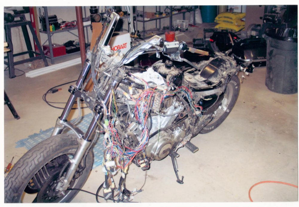

zagger Posted February 6, 2017 Share #21 Posted February 6, 2017 Any ideas where or how to stuff electrical? I packed all everything into the area just ahead of the carb intakes and made a cover for the stuff. I did eliminate about 90% of the electrical wiring, relays, and whatever - kept just the necessary things and made new wiring that was short and clean. If you try to keep all of the stock wiring (picture below) then you will have a real mess. zag Link to comment Share on other sites More sharing options...

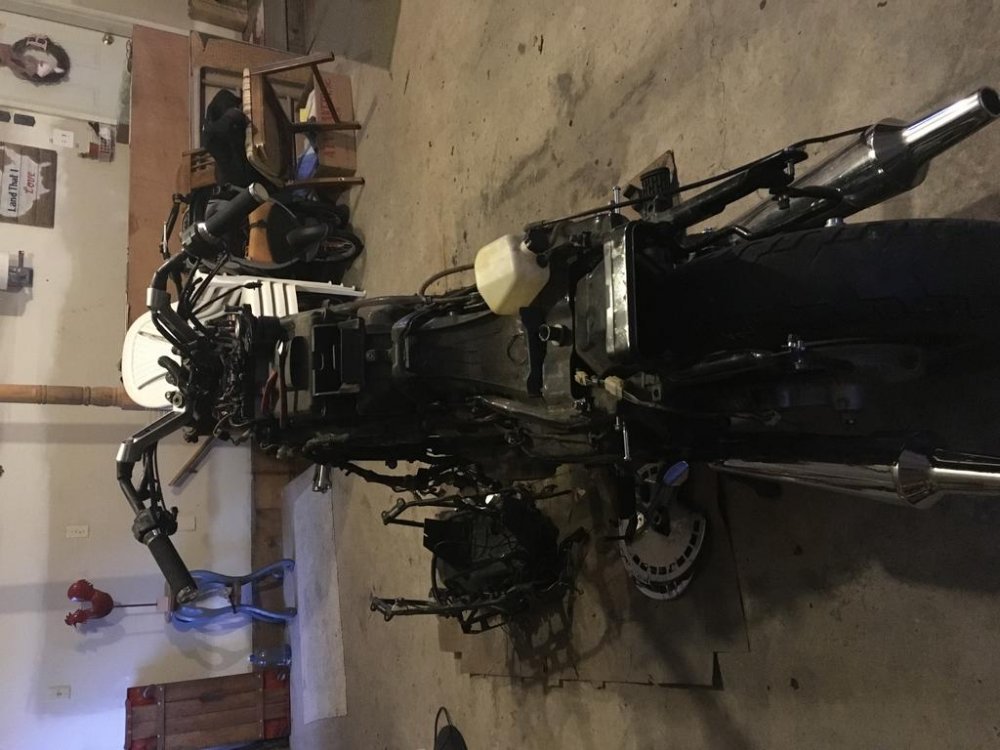

Bassett Posted February 11, 2017 Author Share #23 Posted February 11, 2017 Here we go! Link to comment Share on other sites More sharing options...
Bassett Posted February 11, 2017 Author Share #24 Posted February 11, 2017 Fun in the sun. Link to comment Share on other sites More sharing options...
Bassett Posted February 11, 2017 Author Share #25 Posted February 11, 2017 Shorty Link to comment Share on other sites More sharing options...
