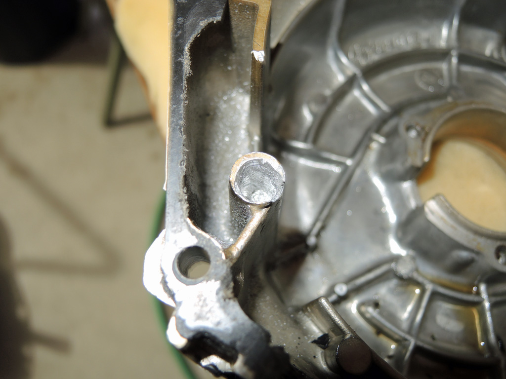

Max Posted January 12, 2017 Posted January 12, 2017 Winter project. In the process of resealing stator wire ports on of my spare 87 and swapping it out on the regular bike to eliminate a pesky leak. Nooo, Don't listen to the pro's, I think it was Marcarl who said the screws have factory locktite and use an impact driver. Broke the head off first attempt by hand. The other 4 screws with impact removed in a minute. Could have saved a couple of days if I'd listened. After breaking off an 'easy out' and about 3 titanium drills in the hole, I got most of innards cleaned out. My question is what would be my next option. I have access to a shop that could fill in hole with aluminum or could I fill in hole with JB weld and retap.(I have a set of taps) I have JB, but not sure if it has the strength. There is quite a bit of meat around the circumference of the inside, however, the top of one edge is thin. Any suggestions welcomed.
Flyinfool Posted January 13, 2017 Posted January 13, 2017 If you have access to TIG welding, that is the very best option. Face drill and tap and you are good as new. Just watch the heat so you do not get an ugly heat spot on the other side. Next choice would be a Helicoil, but it looks like you may already have opened the hole up to far for that. In this application I would not trust JB Weld. If that screw fails it can be very expensive.
Marcarl Posted January 13, 2017 Posted January 13, 2017 Yep, you'll either need a good welder who leaves no airpockets or take a chance on JB weld. If you decide to go JB, do not put too much hardner in the mix, so be sure to get it very close to right and then leave it for at least 72 hours at warm temp.
bongobobny Posted January 13, 2017 Posted January 13, 2017 Might be easier and cheaper, in the long run, to just find another cover on fleabay, they come up often for a cheap price...
Marcarl Posted January 13, 2017 Posted January 13, 2017 Thanks Bob for having me take a second look, I thought it was the engine case,,,, getting old I guess. Seems to me, just looking at it, that you haven't drilled deep enough yet. There seems to be enough room to go deeper and re-thread the deeper portion. The left over piece of collar will have to stay in place, but if you can drill deeper then get a longer screw you might be able to make it work. Best get the right screw though before you tap the bore or you might get it wrong.
Max Posted January 13, 2017 Author Posted January 13, 2017 Thanks for the prompt responses. The JB weld option is out, sounds a little risky. The reason the hole looks way out of round, had a lot of trouble drilling out the 'easy out' and broken drill bit ends. There is still a small piece of Titanium bit tip embedded in the bottom. Thought it better to 'tap out' before there's more damage. I can just set the original screw inside and center. Never occurred to me to use a Helicoil. In hind site, that would have been the perfect solution in this case. In the end, I'll take the case and original 3/4", and metric 1" screw to the shop next week and hopefully they'll bail me out. Even the small stuff can turn into a headache. I'll tell ya, I've learned more about cycle wrenching in the last five years from this site alone, thanks to it's members and tech's. The only reason this ol' 87 is still in our garage. Followup to come.
Pegasus1300 Posted January 14, 2017 Posted January 14, 2017 If you have access to TIG welding, that is the very best option. Face drill and tap and you are good as new. Just watch the heat so you do not get an ugly heat spot on the other side. Next choice would be a Helicoil, but it looks like you may already have opened the hole up to far for that. In this application I would not trust JB Weld. If that screw fails it can be very expensive. Try this stuff, the durobond 7025 aluminum putty. withstands temps to 1000* and is machinable. http://www.cotronics.com/vo/cotr/rm_putties.htm?gclid=CMadsZevwNECFQNrfgodNMsD0g
Flyinfool Posted January 14, 2017 Posted January 14, 2017 Thanks for the prompt responses. The JB weld option is out, sounds a little risky. The reason the hole looks way out of round, had a lot of trouble drilling out the 'easy out' and broken drill bit ends. There is still a small piece of Titanium bit tip embedded in the bottom. Thought it better to 'tap out' before there's more damage. I can just set the original screw inside and center. Never occurred to me to use a Helicoil. In hind site, that would have been the perfect solution in this case. In the end, I'll take the case and original 3/4", and metric 1" screw to the shop next week and hopefully they'll bail me out. Even the small stuff can turn into a headache. I'll tell ya, I've learned more about cycle wrenching in the last five years from this site alone, thanks to it's members and tech's. The only reason this ol' 87 is still in our garage. Followup to come. If there is still some drill bit or screw left in the hole it has to come out before welding. Molten aluminum and molten steel do not play well together. The welding arc will melt all metals. Best way to clean it out without further damage is to set it up in a mill and plunge the hole with a center cutting solid carbide end mill, go very slow so that you do not break off the carbide end mill, carbide is real hard to get out of the hole.

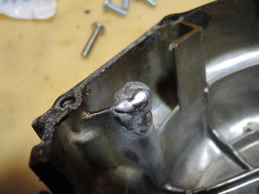

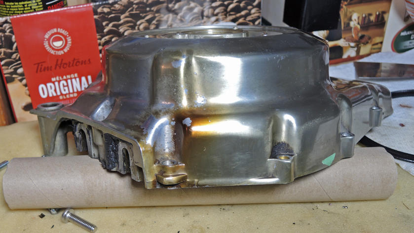

Max Posted January 17, 2017 Author Posted January 17, 2017 If you have access to TIG welding, that is the very best option. Face drill and tap and you are good as new. Just watch the heat so you do not get an ugly heat spot on the other side. I took it to the shop this morning. Bob says TIG welding it is. Got it back this aft and looks not too bad, lots of metal to work with. Did get a heat burn on the outside, looks as if the clear coat browned on the corner. I can live that as a 30 year old bike lol. I'll flush grind, drill and tap later.
Flyinfool Posted January 17, 2017 Posted January 17, 2017 That should do the trick. You can use the part that mounts there to help accurately mark the hole location.

bikenut Posted January 18, 2017 Posted January 18, 2017 (edited) You can remove the clear coat with paint remover and polish with a electric drill and buffing wheel and alum polish to look like new then coat with VHT high temp clear . I just did mine on my 86 trike. I took it to the shop this morning. Bob says TIG welding it is. Got it back this aft and looks not too bad, lots of metal to work with. Did get a heat burn on the outside, looks as if the clear coat browned on the corner. I can live that as a 30 year old bike lol. I'll flush grind, drill and tap later. http://www.venturerider.org/forum/attachment.php?attachmentid=108098 http://www.venturerider.org/forum/attachment.php?attachmentid=108099 Edited January 18, 2017 by bikenut forgot picture
Max Posted January 19, 2017 Author Posted January 19, 2017 You can remove the clear coat with paint remover and polish with a electric drill and buffing wheel and alum polish to look like new then coat with VHT high temp clear . I just did mine on my 86 trike. First I gotta say, bikenut, dude, that is one beauty job ! You got me thinking now. Got lots of stuff to strip paint. Did you oven bake clear coat after application ? The VHT cc flameproof website recommends a 3 stage temperature curing process. I would even consider taking it to the shop for the CC application alone.
bikenut Posted January 19, 2017 Posted January 19, 2017 The cans of VHT I got from Amazon stated to cure in a oven at 200 for 1 hour and that was all. It is not hard to do and looks like new. I have done it on both sides of the bike and very happy of the turn out. Good luck on yours First I gotta say, bikenut, dude, that is one beauty job ! You got me thinking now. Got lots of stuff to strip paint. Did you oven bake clear coat after application ? The VHT cc flameproof website recommends a 3 stage temperature curing process. I would even consider taking it to the shop for the CC application alone.

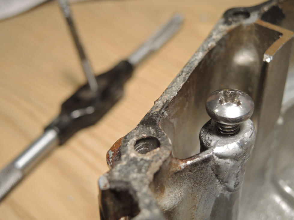

Max Posted January 19, 2017 Author Posted January 19, 2017 Used a Dremel reinforced cut off wheel disc to grind surface flush, drilled and tapped.. success. Gasket remover, clean-up and that's about it, not bad for a first. Thanks for the help y'all. In hind sight, as mention in orig post, use an impact driver to remove these screws!! Hope this help's out someone with similar issue and inexperience.
bikenut Posted January 19, 2017 Posted January 19, 2017 Just a little trick to get screws out that have locktite on is to heat them up with a torch a little and they come out easier. Good luck on your next repair Used a Dremel reinforced cut off wheel disc to grind surface flush, drilled and tapped.. success. Gasket remover, clean-up and that's about it, not bad for a first. Thanks for the help y'all. In hind sight, as mention in orig post, use an impact driver to remove these screws!! Hope this help's out someone with similar issue and inexperience. http://www.venturerider.org/forum/attachment.php?attachmentid=108149
bongobobny Posted January 20, 2017 Posted January 20, 2017 OK, one thing to mention here, when ANYONE is working on these bikes, make sure to use JIS Phillips screwdrivers, not SAE drivers. The difference between the two is the angle of the teeth. If you use SAE on a JIS screw, you stand a good chance of stripping out the head. I mention this because when I look at your picture, the head does look a little bit rounded out. I will say that with the larger P3 and P4 heads the chance of rounding them out is less than with the P1 and P2 but it still can happen. As mentioned, a little heat helps to soften the Loctite, and use an impact driver to break them loose. Myself, when I installed my stator I switched to metric hex head bolts... Very glad you were able to get things squared away!! Hopefully, the information in this thread will be helpful to the next person!
Flyinfool Posted January 20, 2017 Posted January 20, 2017 OK Silly question time. Now that Bob mentioned it, That screw head does not look so much like it is rounded out as it looks like it IS a SAE Philips head. What thread did you tap that hole out to?
