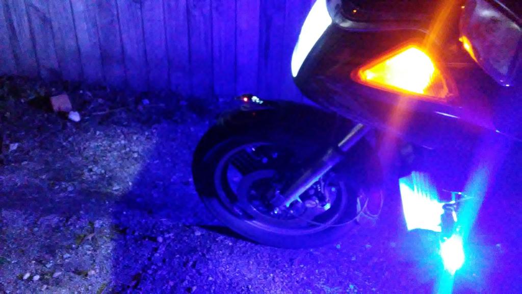

snyper316 Posted April 5, 2017 #76 Posted April 5, 2017 Thank you!! i love the adornment on the fender!! This one is just to taunt you a little bit. How is the bike coming along?
