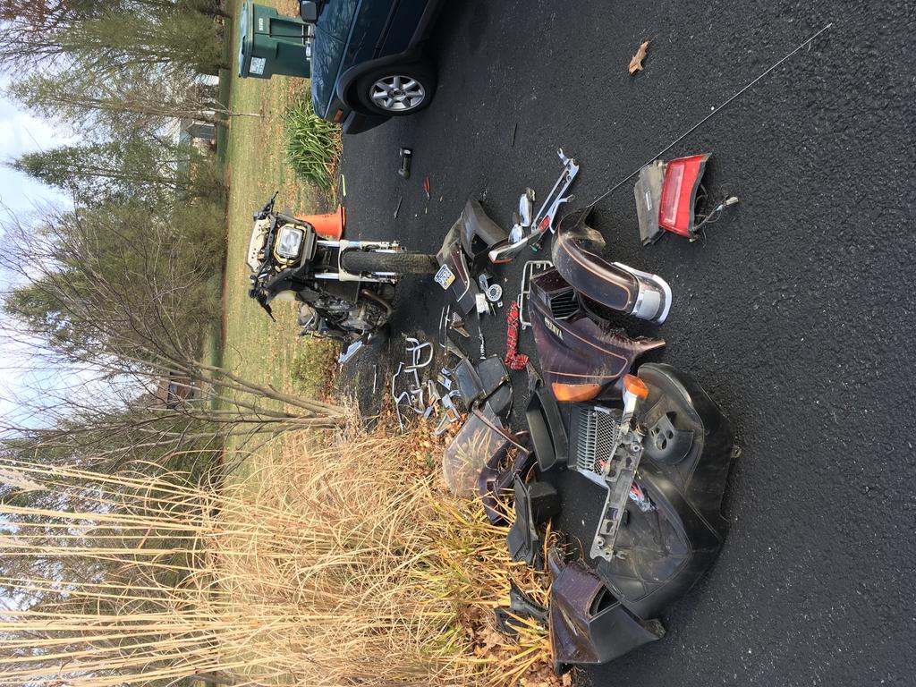

bongobobny Posted December 1, 2016 #3 Posted December 1, 2016 Looks like the aftermath of a collision!! Yup!! Just ask away, we will be GLAD to give you all the advice and assistance we can!! Honest!!
Bassett Posted December 1, 2016 Author #4 Posted December 1, 2016 From my observation, this bike was knocked over a few times, and attempted to be repaired at various times by owners. I stripped the bike down when I got it home, dumped a can do seafoam in, and circulated it through the carbs. Is that ok to sit in there over the winter? Or should I drain the treated gasoline out of the bowls? Idk how fussy Yamaha engines are, I'm coming from Honda V4 muscle bikes (Sabres & Magnas.) Also, I noticed between the exhaust down pipes there is a coolant drain plug that started leaking. But it doesn't tighten..? Is this a common problem with these bikes? Also, hoping to paint the bike "Black Cherry Pearl", comments appreciated! I have finished polishing all the bikes chrome pieces, and am very impressed with the lack of pitting. In addition, the fairing consoles and trim pieces have been painted. Next, I'm hoping to plastic repair. Following that, I will move on to paint. The issues that that the bike has come with include: no hydrolic clutch, I have already bought master and slave kit, weak brake, battery that needs replacing, rear tire, front tire should be also, one factory side bag key turns to "lock and set" but not open? (Any suggestions?), fork seals should be replaced from sitting, and the seat with the rip at the front is already at the leather shop! Cheers! Bassett

bongobobny Posted December 1, 2016 #10 Posted December 1, 2016 OK several of the issues have been already addressed, but I'm going to put my two cents in as well, just because I'm that sort of guy! My first comment, as far as the clutch slave cylinder I wish you luck with the rebuild, but, depending on just how pitted the cylinder wall is and how much you hone it, chances are the rebuild will not be that effective! Many of us have found through experience you are better off just REPLACING the slave cylinder with a new one, they are not really that expensive! Second, yes the brakes, even when new, are anemic at best on the MK1 Venture. You will be best served finding a good set of MK2 forks and rebuilding them and convert the front brakes to better 4 piston calipers instead of the stock 2 piston ones on the MK1. There IS a reason Yamaha changed them over!! The reason you need MK2 forks, or at least the bottom halves, is the bolt spacing for the calipers. MK1 is 87mm (?) as opposed to 100mm on the MK2. You also have to change the rotors as well due to different diameters, but that is a good thing as the MK2 rotors are slotted as opposed to the solid rotors of the MK1. Also with the 100mm spacing, it allows you to use more efficient calipers from a Yami R1 or R6. The best ones to get are the "Gold dot" ones from early 2000's R1 as the pistons are anodized aluminum and won't rust! The Blue dot ones are steel pistons. That along with the use of stainless steel brake lines (the braided ones) make a night and day difference in stopping your beast once you get it running to its full potential! The SS lines do not expand like the regular rubber ones do which wastes braking power. The other issue to address is the anti dive solenoids which are hydraulic on the MK1 (another hydraulic power waste) vs electrical on the MK2. Once again there IS a reason Yamaha changed things! Now I'm not going to get into an argument as to whether or not to even use the anti dive system or not, and whether or not the electric anti dives rob battery power (They are only on when the brakes are applied) nor am I going to discuss the pros and cons of "delinking" the brake system, that is all personal preference. As far as the anti dive I personally like them but prefer the electric ones. The anti dives are triggered by a relay which is triggered by the yellow "brake light" wire. There are pros and cons to delinking, I kind of like the linked system but have had an experience where it got me in trouble... BTW yes you can switch the rear brake over to MK2 but youy need both the caliper mounting bracket, and at bare minimum the pivot part from a MK2 swing arm or machine yourself a proper sized pivot. Granted the rear brake only does about 1/4 of the actual braking but yes there is a noticible difference, and yes the rotors need swapping out... As far as leaving the seafoam mixture in the bowls goes, well it won't do any harm but it also won't do much good either! Seafoam needs to make contact with the crud that may form in the jets, around the valves, etc. In other words, it needs to circulate to do anything! The REAL issue is good old grandpappy's corn squeezings, or ethanol setting in the carbs over an extended period of time! If you don't drain your carbs over winter then yes, by all means have some seafoam mixed in with your gas and/or another product called Stabil as well! I also invest in a tank of high test over the winter, the octane is going to break down anyway, so why not start out with a higher number! Last point, for now, the frame issue with the '83 only Venture. There is an issue with the mounting for the rear shock rusting from the inside out and breaking the shock mount off!! They modified the mounting starting with the '84 model year. When those mounts break loose it is quite the pucker moment when all of a sudden your rear goes down and you have no rear suspension at all!! There are several articles on this here on the site! Trust us, once you get your Venture running properly and all the bugs ironed out you will enjoy one of the finest touring bikes ever made! The 1st gen in particular also has a heart of a sports bike and you will be impressed with how well such a behemoth bike can handle!!!
