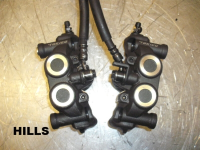

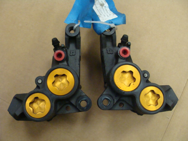

If you buy Mid 90's AXIAL MOUNT R1 or R6 calipers (blue dot or gold dots) they fit any venture from '86 and up.

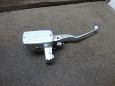

If you have a Royal Star and looking to keep the silver/chrome calipers you can search for late model Road Star 1700cc models ('04-up), Stratoliners & Roadliners came with a version of the Blue dot calipers. Early model Road Star Warrior ('02 - '05) came in black & chrome. The Road Star & Warrior chrome/silver 14mm master cyliners fit the Royal Star line of bikes, I'm not certain on fitment of masters on early Ventures ('86-'93).
