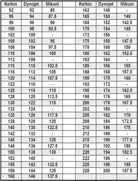

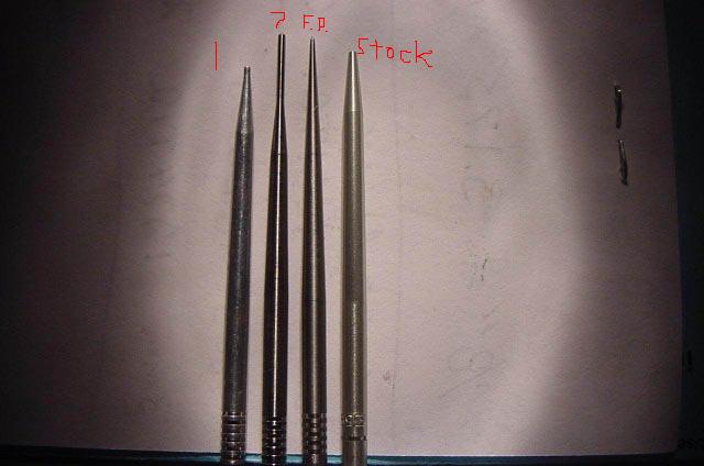

CaseyJ955 Posted December 13, 2016 Author Posted December 13, 2016 The only items I'm lacking to start my conversion are head gaskets, a marks exhaust collector ( I might make my own at work), a gel battery so I can relocate it for the vmax airbox, and the jets and needles for the carbs. I will keep in touch and we will get these projects figured out! I plan on starting sometime before the end of the year, but something always gets in the way lol. If I could sell my Cavalcade I would order everything I need right now.... oh well it will happen sooner or later. Here is a good article on jetting from the Vmax forum. It's probably a great jumping off point for snagging the first few sets of jets, one thing I learned on my Vmax is definitely avoid Dyna Jet kits for the Yamaha V4. They get it way to rich and in spite of the Vmax heads and cams it runs best a tad on the lean side. One thing I dont know is if Vmax needles will work properly on the Venture carbs (34mm vs 35mm, otherwise identical I believe). Some of the aftermarket needles have the 5 notches, and with a needle shim kit I would imagine enough adjustability to make it work awesome. Vmax jetting discussion. http://vmaxforum.net/showthread.php?t=1024 I got my cheapest jets from Sean at Morleys. I'm thinking the experience I have gained dialing in my Vmax will serve well in getting this conversion done on the Venture. I noticed OEM parts/gaskets/seals et al very reasonably priced on boats.net also, maybe head gaskets too. FYI for anyone embarking on jetting, you may or may not know that jets sizes are not alike. The MK and DJ jets are numbered differently. I'll post up a conversion chart below in hopes that it will be handy and avoid confusion, ask me how I know Also I'll put up an illustration of the different needles commonly available for Vmax. I'll be trying the FP (factory pro) needles in my Vmax next. I have had stage 1 and stage 7 now. I do not see myself using DJ needles on a Venture, they are just to damn thin for any MPG. I think for the Venture I'll try stock Vmax needles or FP needles and leave the slides and springs stock for best MPG while still allowing for proper vboost operation and the extra RPMs at the top. I dont have an image of the Venture needle so not sure how it compares to the OEM Vmax needle. I'm not sure if shimming would make a stock Venture needle work well with Vboost. If one does buy a Dyna Jet kit for the Vmax to jet a Venture, it will include stage 1/7 springs and a drill bit for drilling out the slides. I know I wont be doing this on a Venture, it causes the needles to come in closer to 3k rpm rather than the stock 4k rpm. I cant see this helping MPG. Because I'm going to use Vmax heads and cams I'll probably start with stock vmax needles and jetting, or leaner. The Vmax is jetting a little rich from the factory and stupid rich if you use a Dyna Jet kit. I know others have jetting for this and I would hope to also learn from their experience (and altitude) on what it took to get it running as it should. I'm really anxious to see how much it will be like jetting a Vmax.
Horton3791 Posted December 14, 2016 Posted December 14, 2016 Just from experience I have used a slide out of my v-max (Ripped the diaphragm on the venture so I was using the max slide for testing) with the max needle in place on the venture and I couldn't even tell a difference. Since my max is down right now with 3rd gear blown out I still have that slide in my venture, but I have since switched out the needles after I found out they are different after all. Since I will be running a Marks collector and I'm going to free up my exhaust some, I think I will start out with stock max carb settings and go from there. This will be mains,pilots,air jets,slide needles, etc... to me it just makes since to start at that point since we are basically putting together a vmax engine. If it needs to be adjusted from there I will use left over main jets out of my Morley Muscle kit and find the right mixture. I totally agree with you about using stock mikuni jets. I've tried dyno jets in other toys in the past and they never seemed to work as well as stock jets in my experience... even after converting the numbers over for the right jetting.
