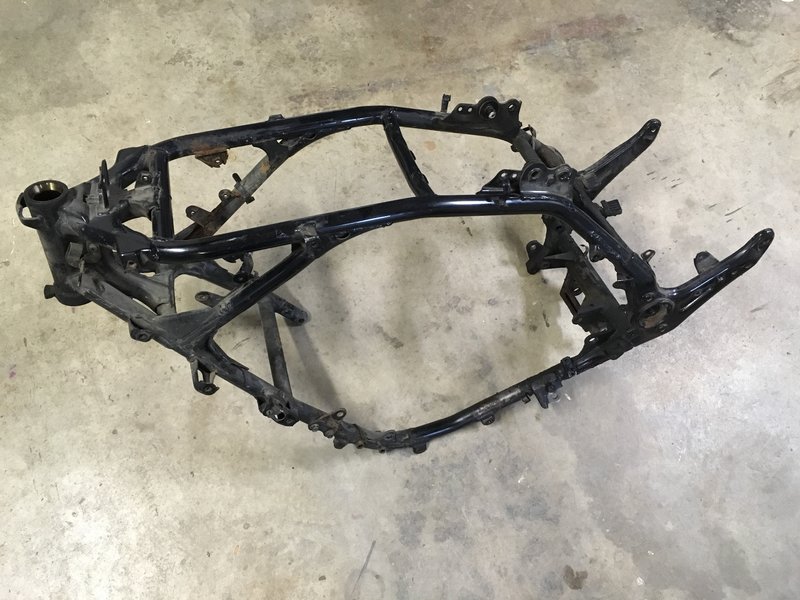

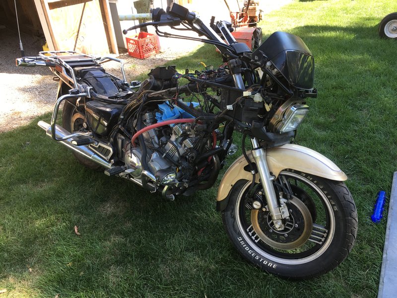

Johnnycyclone Posted October 27, 2016 #1 Posted October 27, 2016 I picked up a project bike this fall, some of you have already seen it in another post. I thought I would start a thread and show my progress on the rebuild as I go. Here is a pic of what I started with. The bike was disassembled to replace some sensors and to put in an updated stator. The owner ran out of interest in putting it back together. It's missing some parts, but parts are pretty cheap to buy so I've already started buying what I am missing for the project. It looks pretty good in the picture, but it's pretty rough and will take a lot of work to bring it back to like new condition. Sounds like fun to me!

Johnnycyclone Posted October 27, 2016 Author #3 Posted October 27, 2016 The time line on the project is about a year if possible, but it may take a little longer. I have another major project I am working on right now, so time may be limited. I have had some time to work on it, mainly because I wanted to get started on disassembly and as of tonight we are down to the bare frame. The frame looks good, no cracks, which is a possible problem with the 83 model year, at least from what I have read. I am going to have this sand blasted and then either powder coated or epoxy painted, not sure which yet. The deciding factor will be the cost of the work. This is a project with a small budget so we will try to save some money when possible. I am not on here everyday, but I will check back at least weekly, maybe a little more if time permits. Stay tuned, more to come later.
Flyinfool Posted October 27, 2016 #4 Posted October 27, 2016 Since it is an 83 with the known possible frame issues, it might be a great time to weld in the braces to prevent future cracking of the frame.
mraf Posted October 27, 2016 #5 Posted October 27, 2016 If my memory serves me right the cracked frame issue was due to the frame rusting on the inside. So seeing a crack might be impossible. As Flyinfool says now is the time before it happens. I had a 83 once it would run circles around my current 86, handing and power wise. I would still have it but she who must be obeyed wanted more storage, end of story.
Johnnycyclone Posted October 31, 2016 Author #6 Posted October 31, 2016 Flyinfool, mraf - I wasn't planning on adding any extra braces, but you both make good points, so I will add it to the list. Thanks for the suggestion!

Flyinfool Posted October 31, 2016 #8 Posted October 31, 2016 I found the thread with the pics. http://www.venturerider.org/forum/showthread.php?1521-83-Broken-frame 1
Johnnycyclone Posted October 31, 2016 Author #9 Posted October 31, 2016 I found the thread with the pics. http://www.venturerider.org/forum/showthread.php?1521-83-Broken-frame Yep, as soon as I read your post on the issue, I did a search and came across the same thread. Thanks for posting! I might do mine a little different, but it will have the same affect. I will post a pic or two when I get it done. Thanks again!

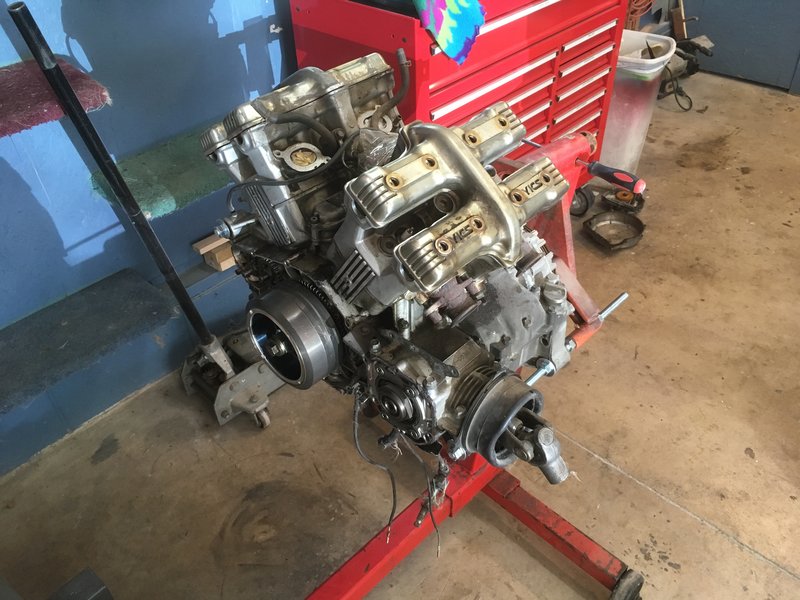

Johnnycyclone Posted October 10, 2017 Author #16 Posted October 10, 2017 Been awhile since my last post, and not much has happened until this past week. As I mentioned before I have another big project I'm working on right now. It's a restoration of an 81 Corvette. Three years into the project and probably about 10 months to go. Anyway, getting itchy to get going on this one and tired of seeing the engine sitting on the garage floor. So hopefully I can start devoting some time each week to work on this. First step, getting the engine on a stand. More to come shortly.

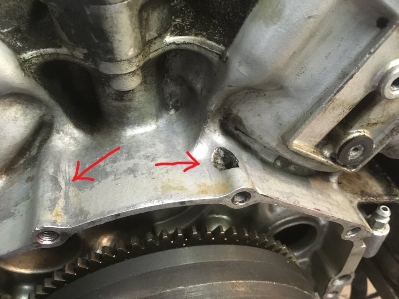

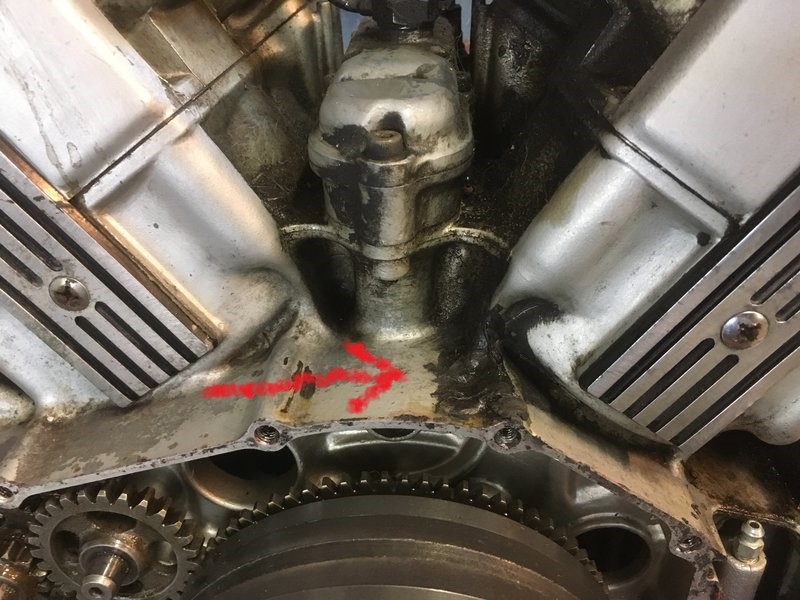

Johnnycyclone Posted October 10, 2017 Author #17 Posted October 10, 2017 First is to start cleaning and see what we uncover. An area of interest was on the left side of the case. You can see an area where a lot of silicone was applied. Once removed it exposed a hole at the end where the bolt for the cover threads in. You can also see a crack on the one next to it. It appears they half filled them with silicon and when tightening the bolts the pressure cracked the case. We are going to finish cleaning and then tear it down a little further. Not sure how far yet, but will probably remove the heads and go with a complete new gasket set before re-assembly.

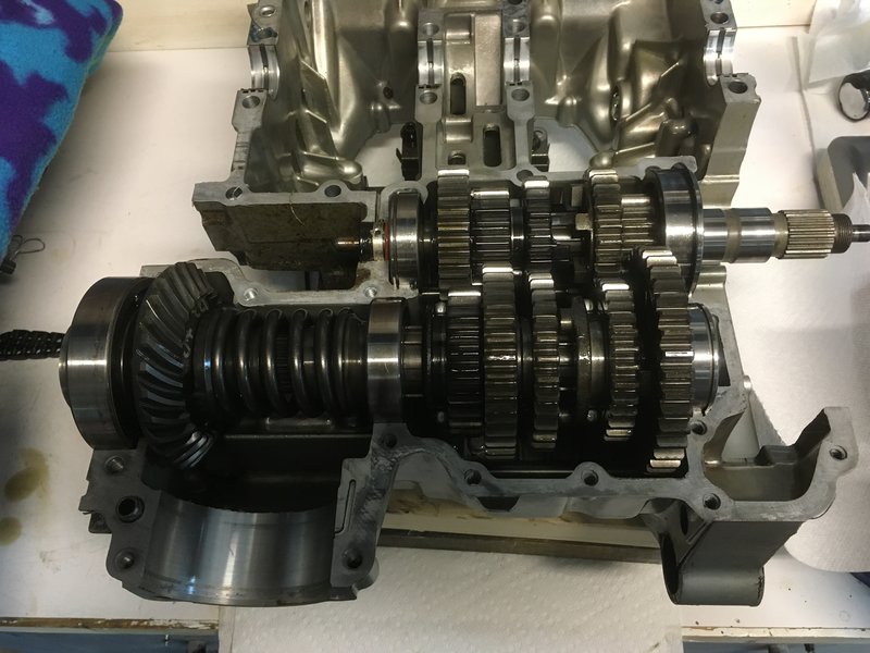

Johnnycyclone Posted October 25, 2017 Author #18 Posted October 25, 2017 Got the engine tore down this week. Everything looks like new on the inside, very little wear. Transmission looks good, no issues that I can see, and 2nd gear engagement looks good also. It would be great to just put it back together and run it the way it is. The previous owner said there were no issue with shifting, so it's tempting to just reassemble as is. But with that said, since it's all torn down now is the time to fix an issue that could arise at a latter date. I think the best route is to buy a transmission from one of the newer models that already had the repair done. Money is a little tight so it may be a little while before we can source the parts. For now you can take a look at the transmission as it sits right now. More to come later.
Yammer Dan Posted October 25, 2017 #19 Posted October 25, 2017 Replace Thrust washers and check 2nd Gear dogs.
stanG Posted October 25, 2017 #20 Posted October 25, 2017 Oh yeah. Since you already have it torn down the $25 bucks for the washers is well worth it. I would also undercut the second gear dogs for better engagement since there is minimal contact when those gears come together.
gaj1917 Posted October 25, 2017 #21 Posted October 25, 2017 Boy, I'd be inclined to replace the 2nd gear wheel while you have the trannie exposed. You'll never have a better chance. A new 2nd wheel (upgraded wider) can be had for around $100. The wheel, along with the thrust washers, caused the infamous 2nd gear failure in these early Ventures.
Flyinfool Posted October 25, 2017 #22 Posted October 25, 2017 Another option is to put in a trans from a 2nd gen and then do the V-Max rear end. This combination will get you lower engine RPMs cruising down the highway and a lower first gear for better hole shots or getting a trailer or 2 up moving more easily. Those that have done this have been very happy with it. I am looking for a Vmax rear I can snag cheap.
Johnnycyclone Posted October 25, 2017 Author #23 Posted October 25, 2017 All good suggestions and so noted. The reason I tore it down this far was to specifically take a look at the 2nd gear issue. Right now I don't think there is an issue, but I also want to make sure there isn't an issue in the future. So I am planning on going a little further with the disassembly and then we can then look at the suspect parts. Any issues will be fixed. Like has been said, now is the time to make the repairs. I will update you when we get the gears apart. First I need to build a make shift press.
snyper316 Posted October 25, 2017 #24 Posted October 25, 2017 Oh yeah. Since you already have it torn down the $25 bucks for the washers is well worth it. I would also undercut the second gear dogs for better engagement since there is minimal contact when those gears come together. Can you please show me where these dogs are you are talking about, all I see is shiny metal.... Ok I am not advanced enough but what is the dogs you speak of and where would this washer be that needs the replacing on these bikes?
Johnnycyclone Posted October 25, 2017 Author #25 Posted October 25, 2017 Can you please show me where these dogs are you are talking about, all I see is shiny metal.... Ok I am not advanced enough but what is the dogs you speak of and where would this washer be that needs the replacing on these bikes? A picture is worth a thousand words, so when I get it apart I will post some pics of the dogs and the washer.
