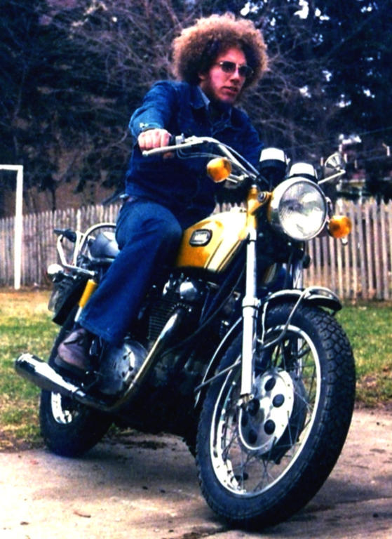

gggGary Posted October 31, 2016 #24 Posted October 31, 2016 Yes firm push forward on both grips has worked for me to damp out both wobble and weave situations. Back in about 1974 on an early XS650 Survival was not a given when it happened to me at 80 MPH. The front tire was hopping up in the air and landing a few inches to one side and then the other. In that situation PUSHING forward hard on both handlebars will go long way to damp out the oscillations. Pulling on the bars will make it worse. Figuring that out on the fly was a matter of luck that probably saved a lot of hide if not my life. Watch your loading, while I don't have any photos the event above was during a March spring break trip to Florida and back from Wisconsin. I can only guess there was a bunch of stuff tied to the luggage rack. Prolly Dunlaps, tread cupping can cause weave. That weave wobble video is all old bikes on Dunlops, just say'n....
