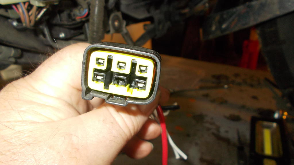

mm482 Posted September 21, 2016 #5 Posted September 21, 2016 One of the weak areas of the charging system is the connector at the voltage reg. If the battery and grounds check good, I would drop the VR and look at the connector.
utadventure Posted September 21, 2016 #6 Posted September 21, 2016 mm482 said: One of the weak areas of the charging system is the connector at the voltage reg. If the battery and grounds check good, I would drop the VR and look at the connector. I had to replace mine with the new stator. One of the connections, the plastic had melted into the R/R. Dave
