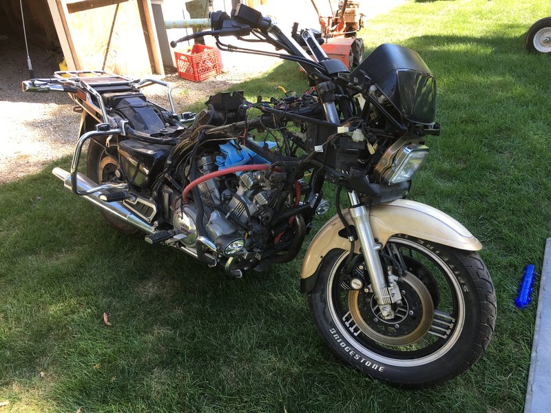

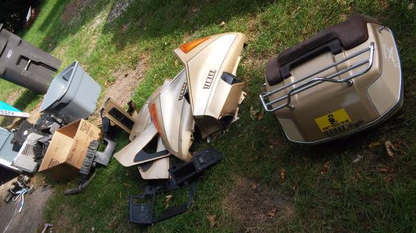

so i was looking on craigslist for parts here in the mitten, found a bike that owner says needs to just be put back together. $500
1983 XVZ12 same as mine, talked a bit and his wife wants it gone, so now price is $350.
so i will get it but do you think sight un seen i should part it out or re build it and sell?
what parts would you keep as just in case parts? one thing i may want is the dash as mine is from canada and is in kilometers
my 83 is running great, just want to clean stuff,
input from forum?
pics from ad
I always say rebuild.
Lots of parts off the bike but if you have those parts and can get it put together and make it run then do it.

The first thing you need to do is to make sure the engine is not rusted and locked up due to airbox being off. I would take the small side cover off where the stator is and put a socket on it and see if the crank will rotate. You might want to pull the plugs first. And, you will most likely have the 2nd gear issue to deal with.
Randy
yes about second gear, that gets you coming and going on the 1200's. Any non runner you gotta figure 2nd gear is out. Then the value of any 1200 is dogged by the perception that 2nd gear is gonna go, making the bike scrap. My 2 cents. I bought, rode, and sold a 1200 that had a perfectly good second gear about a decade ago.
Not to be argumentative, but loss of second gear doesn't make the bike scrap. It just makes the purchase price more reasonable! I have an '84 that I ride frequently, go where I want, when I want, as fast as I want without second gear. But don't get me wrong, you can have a multitude of very expensive problems with a bike that hasn't been ridden for a long time. :2cents:

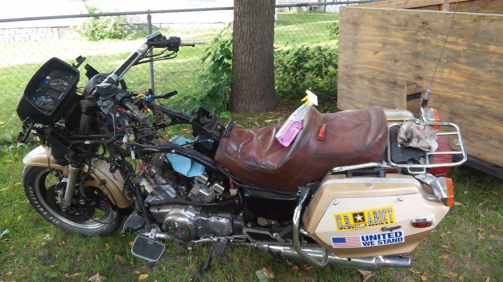

My vote is to rebuild, and I guess that's why I ended up bringing it home. It's more like therapy for me to have a project like this to work on. There's something about taking each part and working on it to bring it back to like new condition. Then to assemble all of the parts, make it run for the first time again, and get it out into the wind is a great experience. Right now it's in storage, but shortly I will be starting on the project. We will be going right down to the frame and working our way back to a complete bike again. My goal is to have it back on the road by this time next year. We will see how it goes and I will post a pic of the finished project when done. I may even start a thread to show the progress over the winter and summer.

Since you are planning to tackle lots of things on the bike, the second gear issue really isn't that much more effort to fix. I bought mine without the second gear problem but tore it down enough to replace the split washer thingy with a new hardened one. The old one was pretty deeply worn but hadn't quite become a problem. Of course, the engine does have to come out of the frame to get it apart enough for this work. And you need to rig up a way to compress the big stiff spring that puts constant load on the washer. After all that, sticking in the new part takes only a second!
I guess you can ride without second gear, but why do it if you can simply fix the problem? It has been quite a few years, but I doubt that it took more than a couple of evenings work since the bike was already in pieces.
