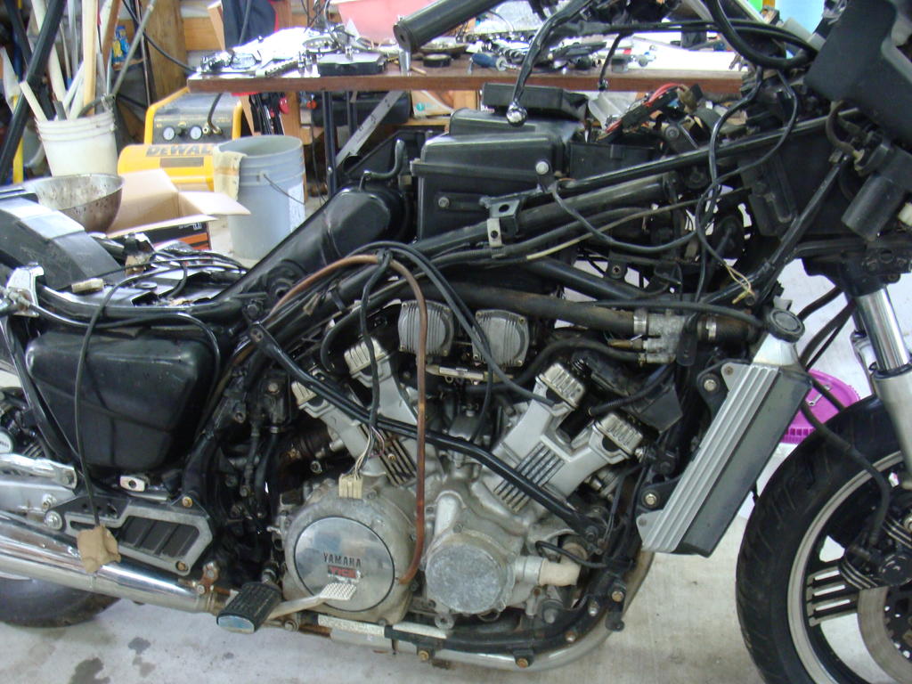

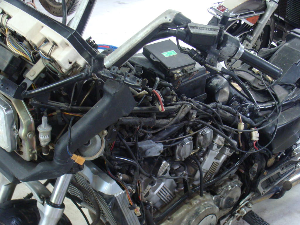

Asher1877 Posted September 14, 2016 Posted September 14, 2016 So, I picked up an 86 Venture Royale for free. It needs a full rebuild and resto. Here's the photos that I have taken today of a walk-around. http://i1159.photobucket.com/albums/p635/matthew_lee3/14264053_198885963857962_2360986998045106899_n.jpg http://i1159.photobucket.com/albums/p635/matthew_lee3/14264258_198886060524619_2688322584853031883_n.jpg http://i1159.photobucket.com/albums/p635/matthew_lee3/14359093_198885743857984_8639332482141754444_n.jpg http://i1159.photobucket.com/albums/p635/matthew_lee3/14369940_198886177191274_1774682196244863137_n%201.jpg http://i1159.photobucket.com/albums/p635/matthew_lee3/14238312_198885853857973_965086558919007892_n.jpg So, as you can ascertain to state the obvious she's in need of a LOT of love. It is my intention to use this thread to document the restoration of back to showroom floor condition. There is no timeline or deadline for this project as it is obviously going to have to be pieced together here and there as finances permit. There's parts available that came with the bike, but for the time being are stuck in storage until such time as I'm able to get them cleaned up properly. Wish me luck.

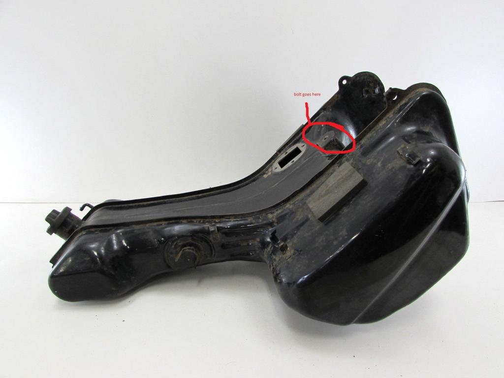

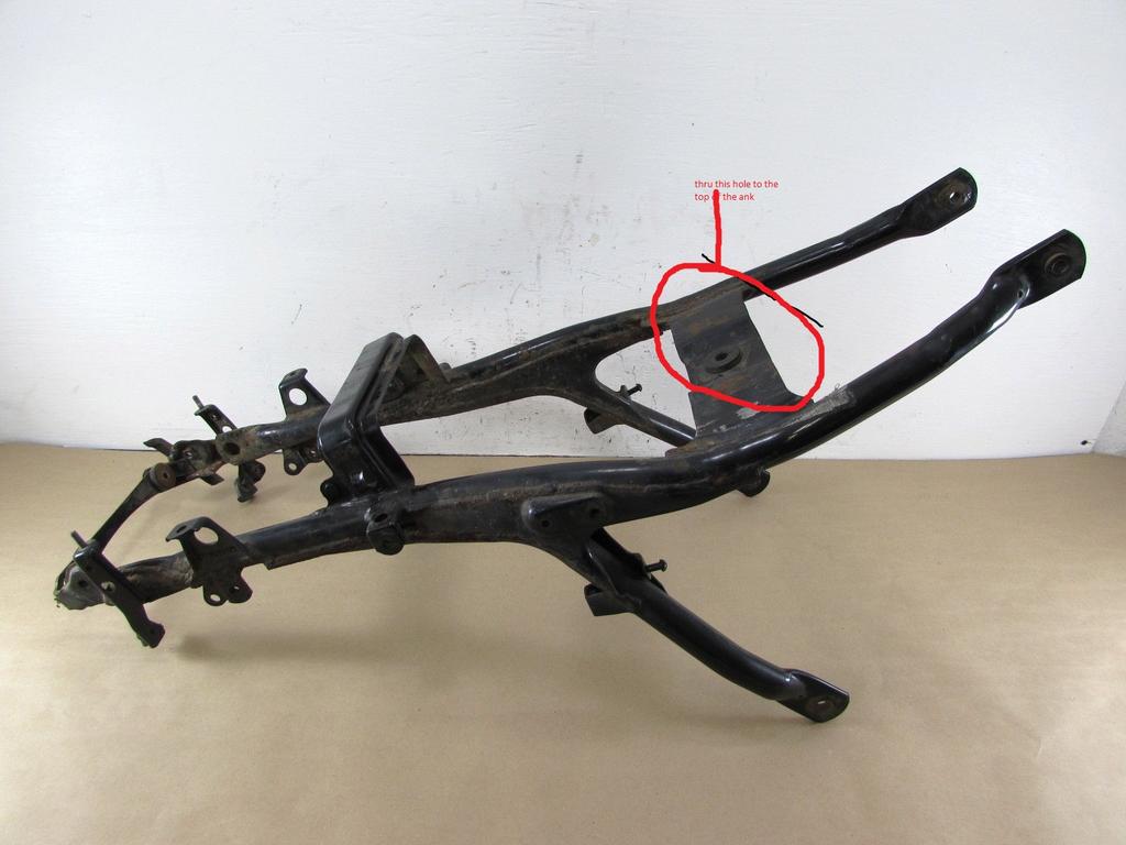

Asher1877 Posted September 16, 2016 Author Posted September 16, 2016 Okay I'm under the impression I put the cart before the horse. As you can see from my original photos, the subframe and gas tank were removed. Upon reading a different post, I learned that the subframe has to be removed in order to remove the gas tank (yes I have the subframe and the gas tank) Does the subframe have to be off in order to re-install the gas tank? I'm unaccustomed to having the under-seat tank so I'm attempting to mentally engineer this in my noggin. I've been going over the technical manual (.pdf) trying to find the information in the technical manual and I haven't come across what I'm looking for as of yet.
Dragonslayer Posted September 16, 2016 Posted September 16, 2016 (edited) Well as far as why I'm doing what I'm doing? The answer for me is very simple: the pride of building something with 8 fingers and 2 thumbs. It is very true that I could just go out and purchase a pre-owned venture/wing/evo electra-glide, but ask anyone that has done a DIY item, there's an intangible pride that comes with standing back and looking at the finished product and going "yeah that's me, all me". I also have to state that I have the bags, tour trunk, air dam, tank cover, upper and lower fairings, windshield, rider backrest, front fender all in a storage unit. I just haven't been able to get up to the storage unit to take photos of my inventory as of recent and there are more parts that I have on the way on Monday. There's no rational reason for riding or working on motorcycles. What we do is fundamentally based on passion, it's illogical for us to ride on 2 wheels when we could be in a caged vehicle with safety features, back up cameras, airbags, etc. So far as I'm able to decipher (and yes pics will be coming from the storage unit as to what I have because there are quite a few that Idk wtf they are) that the bike outside of the nuts, bolts, and fasteners is mostly all there. The only two body parts that I know that I have that are questionable are the upper fairing halves. What do I want out of the endgame? A custom painted Venture as close to factory specs as I can get. I have a fully functioning workshop and this isn't my first project. It is my first metric though. The lion's share of my experience comes from rebuilding basketcase shovelheads, evo's and sportsters. Make no mistake, when I first pulled in to pick the bike up, I almost drove away and went home. This bike for me feels special for some reason though. I wouldn't set it up and gone forward with the project if I truly in my heart felt it was impossible. I'm going to say that my biggest blessing with this bike is I have my wife's support to go forward with it. All I can say is that it's a labor of love. I WANT to do this bike, to put as much of myself into it as I can. It's not to flip and turn a profit, it's just to say that I did it my way. Edit: Forgot to mention that I ordered the bolts to reattach the subframe to the frame today, predicted day for delivery is thursday. So, it's the journey you seek. I think we all get that being in the brotherhood of bikedom. I too, as many others have taken the 1st gen pilgrimage you are about to embark on. And haven done so, are proud to offer our advice and wisdom and insite to aid you in the mission you are anxious to undertake. As for my earlier point of view, for myself,at this stage of life, I find that once a Dragon has been slain there is no need to slay it again. But, to you I say have at it and God's speed. P.S. it's good you have all 8 fingers and both thumbs, you are gonna need them. :-) Edited September 16, 2016 by Dragonslayer
snyper316 Posted September 17, 2016 Posted September 17, 2016 Okay I'm under the impression I put the cart before the horse. As you can see from my original photos, the subframe and gas tank were removed. Upon reading a different post, I learned that the subframe has to be removed in order to remove the gas tank (yes I have the subframe and the gas tank) Does the subframe have to be off in order to re-install the gas tank? I'm unaccustomed to having the under-seat tank so I'm attempting to mentally engineer this in my noggin. I've been going over the technical manual (.pdf) trying to find the information in the technical manual and I haven't come across what I'm looking for as of yet. Ok I have done this... The subframe goes on after you put the gas tank in there is a bracket at the top of the tank that I put on losely to kinda hold the gas tank. Then I put the 2 bolts in the back where the crash bars are and kinda role it into position over the tank. Then I take the bolt that screws to the top of the tank and thread it a couple of turns. Then I go to the front of that frame and line up the holes and screw them in some and double check to make sure I haven't missed anything then I tighten up the neck bracket then do the to front bolts to the frame. Then I tighten up the bolt for the tank. Then I go to lower bolt and nut. Only one problem I have an 83 But I can't imagine it being much difference other then how the saddle bags go on.
Asher1877 Posted September 26, 2016 Author Posted September 26, 2016 Apologies for the lack of updates, we're moving this week and then a week from now we have a business trip to vegas so expect about two weeks to three weeks before any further updates beyond I've purchased a cover for the bike and I now have the bolts to connect the subframe to the frame. I'm also in the process of trying to decipher how to secure the fuel tank to the frame.

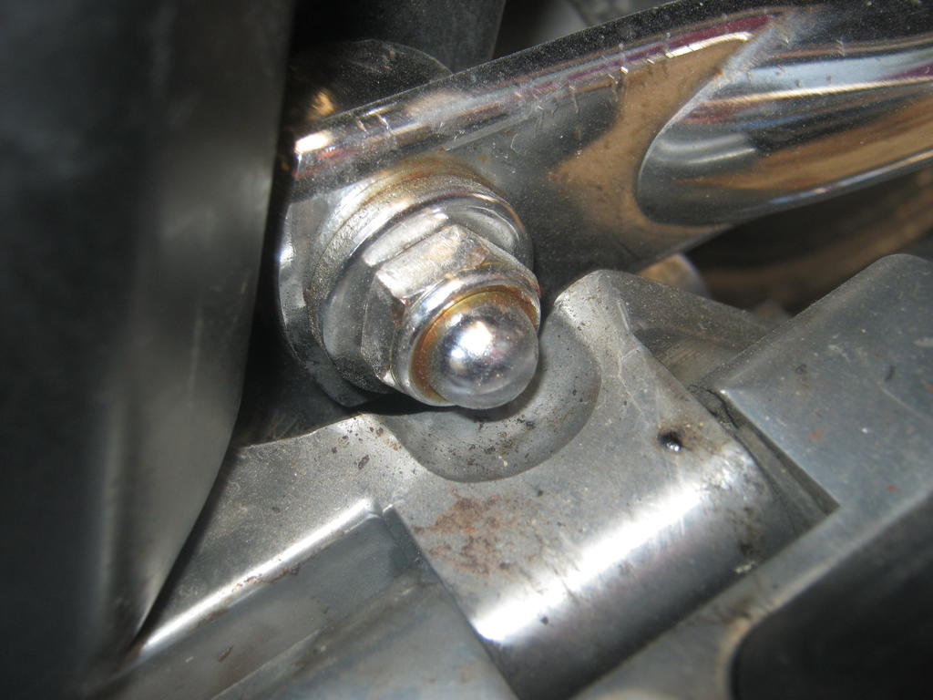

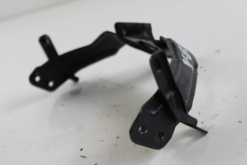

snyper316 Posted September 26, 2016 Posted September 26, 2016 Apologies for the lack of updates, we're moving this week and then a week from now we have a business trip to vegas so expect about two weeks to three weeks before any further updates beyond I've purchased a cover for the bike and I now have the bolts to connect the subframe to the frame. I'm also in the process of trying to decipher how to secure the fuel tank to the frame. Its a long bolt in the center of the subframe I put the gas tank on and put this small bracket over the neck loosely. then I bring up the sub frame and put it up loosely. Then I Put the long bolt in and snug it.. Then I tighten everything else on. Hope this helps you decipher.
Asher1877 Posted September 26, 2016 Author Posted September 26, 2016 Its a long bolt in the center of the subframe http://www.venturerider.org/forum/attachment.php?attachmentid=107509http://www.venturerider.org/forum/attachment.php?attachmentid=107508http://www.venturerider.org/forum/attachment.php?attachmentid=107507http://www.venturerider.org/forum/attachment.php?attachmentid=107510 I put the gas tank on and put this small bracket over the neck loosely. then I bring up the sub frame and put it up loosely. Then I Put the long bolt in and snug it.. Then I tighten everything else on. Hope this helps you decipher. Thank you so very much!

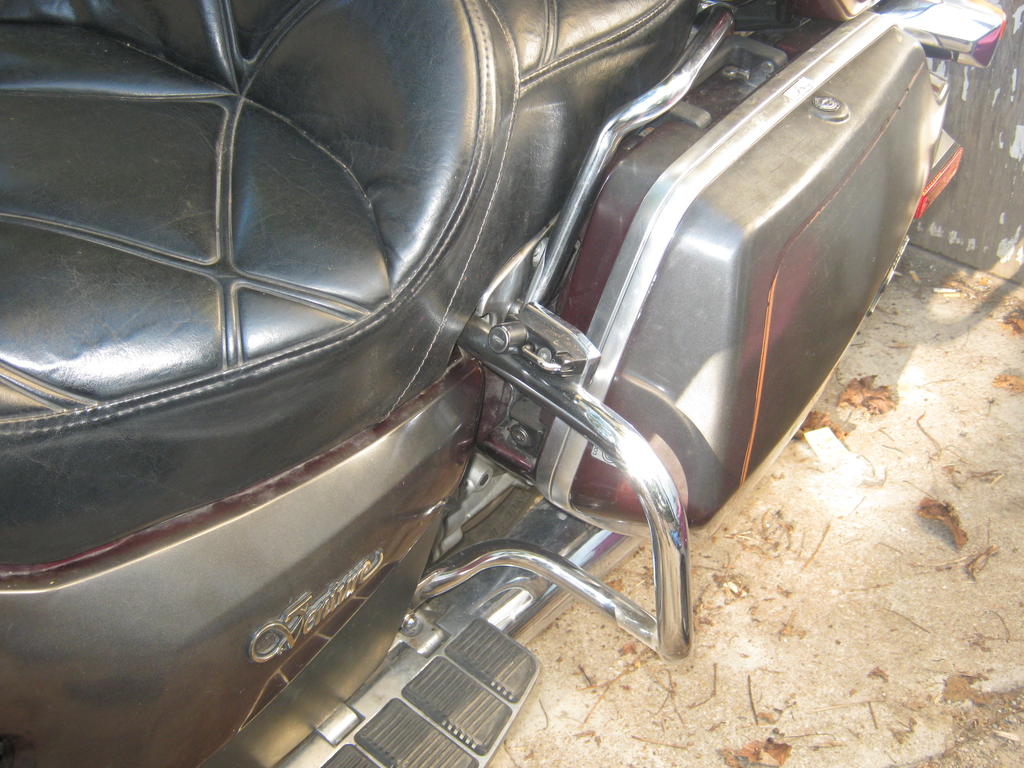

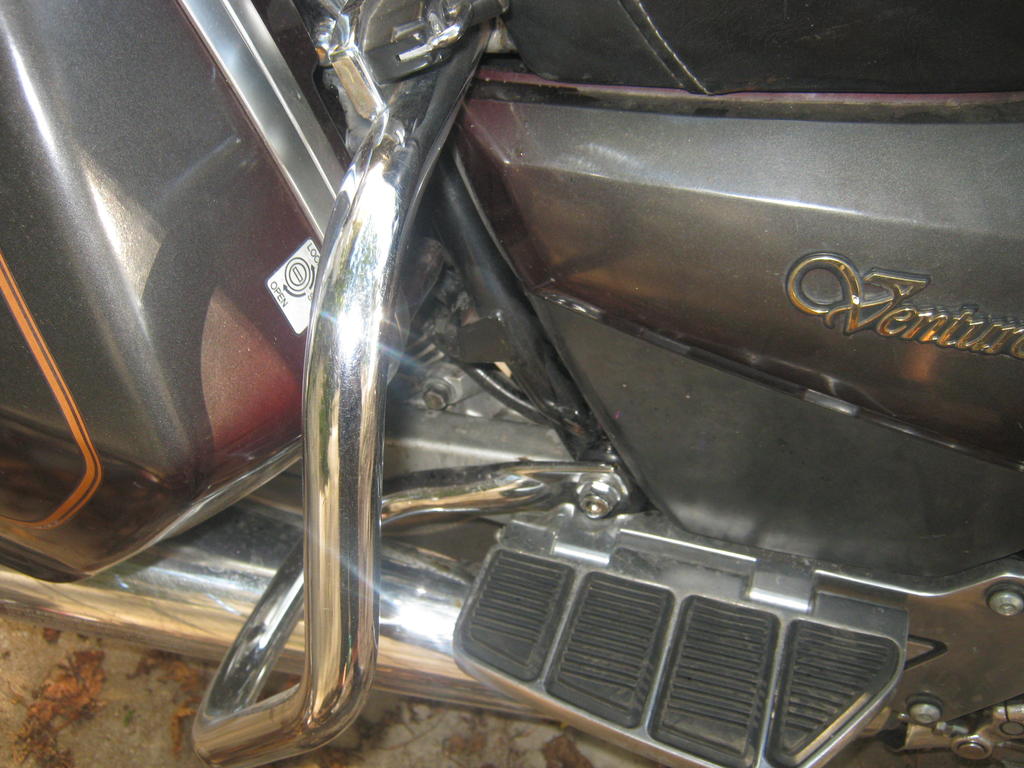

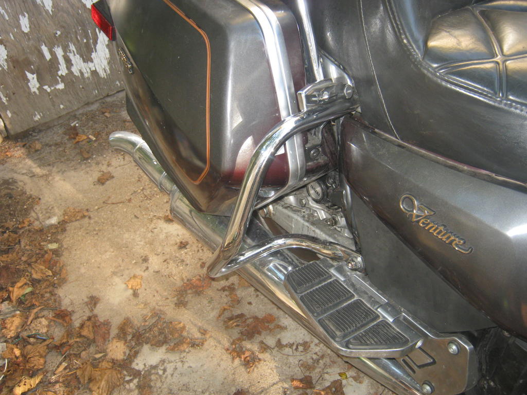

snyper316 Posted September 26, 2016 Posted September 26, 2016 Thank you so very much! Don't know if this will help you any but here is a picture of the crash bar and subframe I am not sure if yours will be the same or not. Yours is an 86 with updated saddle bags that open from the top.
Asher1877 Posted September 26, 2016 Author Posted September 26, 2016 Don't know if this will help you any but here is a picture of the crash bar and subframe http://www.venturerider.org/forum/attachment.php?attachmentid=107511http://www.venturerider.org/forum/attachment.php?attachmentid=107512http://www.venturerider.org/forum/attachment.php?attachmentid=107513http://www.venturerider.org/forum/attachment.php?attachmentid=107514 I am not sure if yours will be the same or not. Yours is an 86 with updated saddle bags that open from the top. No clue as of yet, as I said, I've got a whole bunch of parts in a storage unit that I need to get cleaned up and identify. It's top of the list when I get back. I'll post the photos, rely on you guys for what to keep, what's trash and the usual I don't know what it is. I know for plastic I have side panels, faux tank cover, left and right bags (one is missing a lid from what I can tell) trunk and rack, a bunch of black plastic and metal covers? and a questionable upper and lower fairing. Like I said, photos will come.
