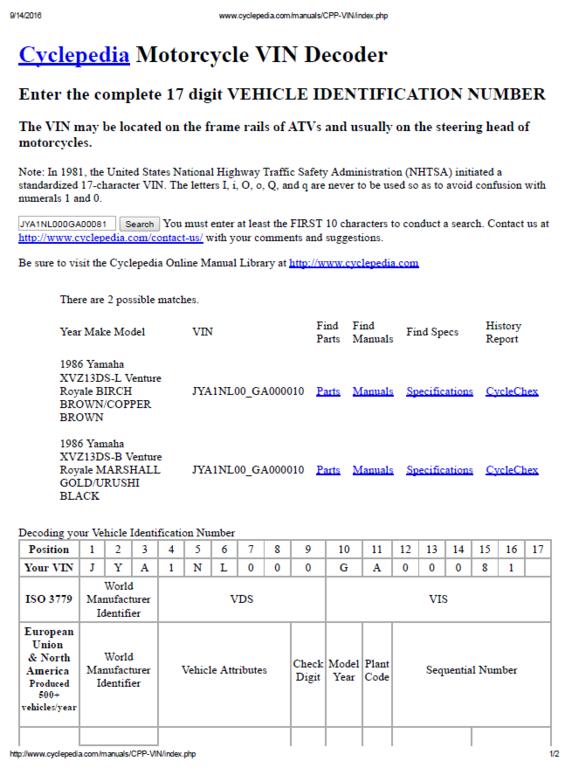

snyper316 Posted September 13, 2016 #8 Posted September 13, 2016 BarryF said: Thanks Prairiehammer. You are correct about the color. Blue, kinda like lightly faded denim, with a lighter two-tone. All badging says XVZ12. Bags and trunk are removable, with notches in bags where they mount around turn signals. As far as finding the VIN, besides the one on the bottom frame rail, I don't know where to look, or what I might need to remove to find it. The VIN on the title, which matches the bottom, is JYA1NL000GA00081. Does that mean anything to you? Here you go. http://www.cyclepedia.com/manuals/CPP-VIN/index.php
snyper316 Posted September 13, 2016 #9 Posted September 13, 2016 Think I missed something here but that VIN thing don't Help him out... Would it have the full 17 on the neck?

yamagrl Posted September 15, 2016 #16 Posted September 15, 2016 Here it is decoded. http://www.venturerider.org/forum/showthread.php?121409-VIN-Decoder
