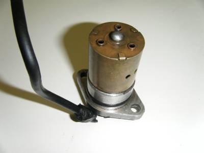

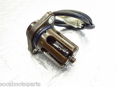

Prairiehammer Posted September 11, 2016 #11 Posted September 11, 2016 camos said: I would bet the oil sensor is not as sophisticated as a float switch. The single wire is most likely hot and when the sender switch is covered with oil the circuit is closed and when the oil level is low then the movement of the bike will make the oil surge and break the circuit. There would likely be significant issues with engine crud if an actual float was used. I believe it is a magnetic reed switch with a floating magnet. Here is a picture of a more modern Yamaha oil level switch (almost a cutaway look) showing an obvious ring surrounding a center armature. The Venture and other Yamaha products has a visually similar oil level switch, albeit several holes (second pic) instead of the more modern slots.

camos Posted September 12, 2016 #13 Posted September 12, 2016 Prairiehammer said: I believe it is a magnetic reed switch with a floating magnet. Here is a picture of a more modern Yamaha oil level switch (almost a cutaway look) showing an obvious ring surrounding a center armature. The Venture and other Yamaha products has a visually similar oil level switch, albeit several holes (second pic) instead of the more modern slots. It is more sophisticated than I thought. Good thing you told me before I actually made a bet. Having holes rather than being more open would probably cut down on false positives from surging.
