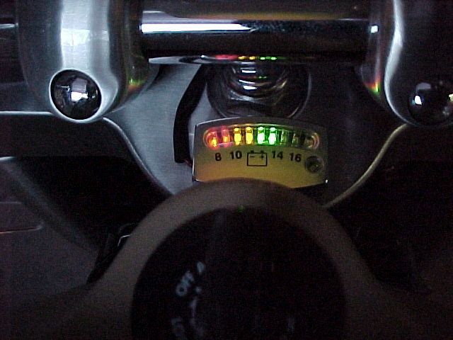

Freebird Posted August 22, 2006 Posted August 22, 2006 Thanks to Cougar for the excellent write-up UPDATE How much Power? / Amps? Well As some of you know that I have been Adding all kinds of Goodies to my RSV this past couple months. I added the modulite. I added the 240 watt Amp. I added the New Speakers. I added the new LED lights all over the place.. trailer , bike ect. I added the Sirius Satellite Radio. I added the GPS Unit. Now with all that said, some of you and even myself wondered how the heck the Charging system would do? Well I got the kuryakyn battery meter today http://www.kuryakyn.com/products.asp?bn=metric&ci=2695 and hooked that bad boy up.. Then I started the bike up and turned ALL of this stuff ON! And holding the brakes on / radio full power (30) Even the HIGH BEAMS... these were the results with engine in the Idle mode http://www.venturerider.org/ampmeter/thumbnails/attachment_003.jpg Then I Brought up the RPM's to about 5k or so.. then this is what It was reading http://www.venturerider.org/ampmeter/thumbnails/attachment_002.jpg I shut the engine off and left all the stuff on for about 15 Min's and this is what it showed. http://www.venturerider.org/ampmeter/thumbnails/attachment.jpg Anyways! I feel better now knowing that my Electrical System Is able to handle all this kewl stuff I added without to much worry. Just thought I would share this Info with ya folks! (oh, that is with the trailer attached to the bike as well) (the meter also go's into dim mode at night) Jeff
